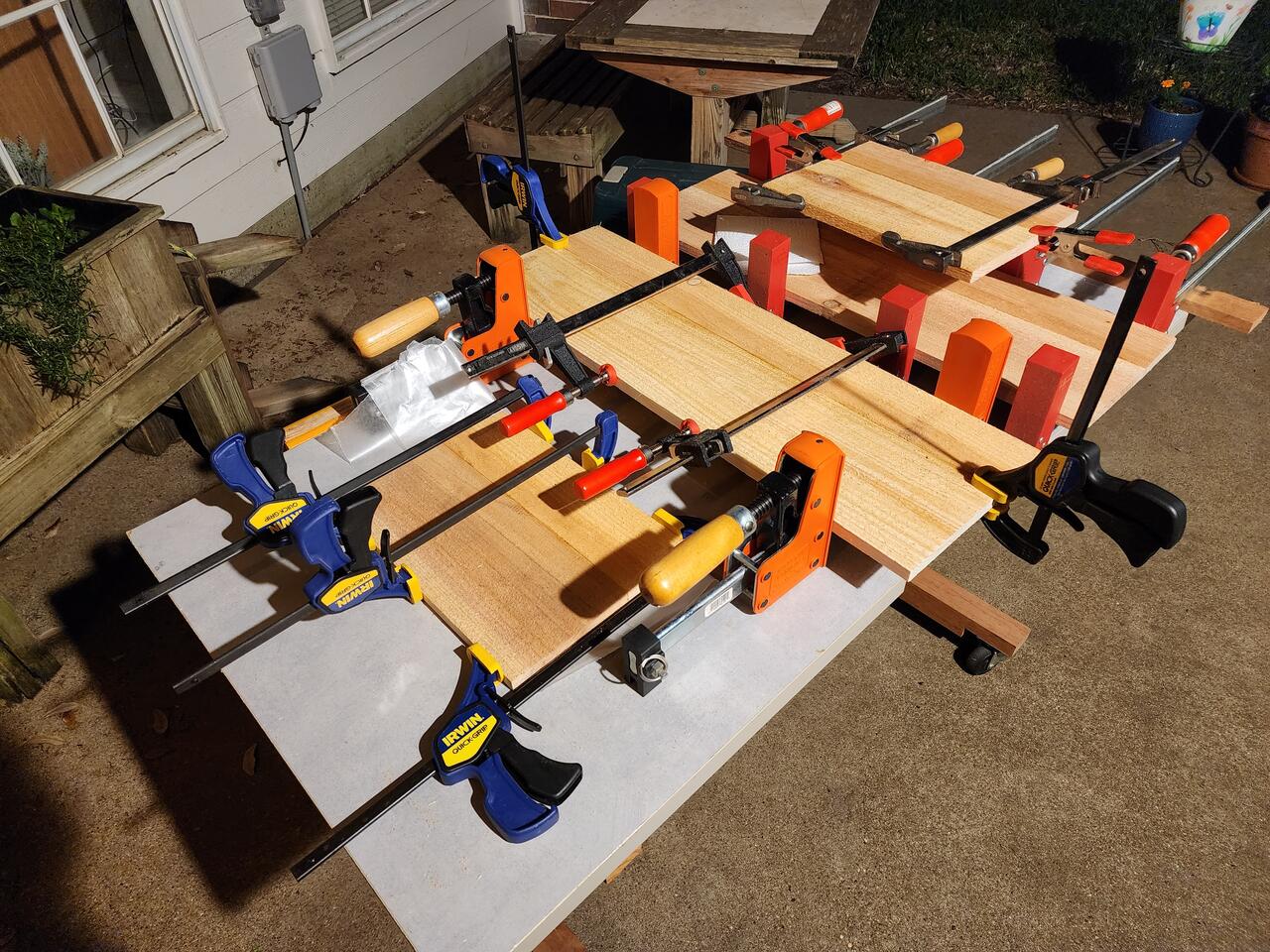

    I just dragged mine (mix of Jorgies and K-body clamps) out last week for the planter box glue-ups.... They are very heavy. the 36 inchers more so than the shorter versions.
    Unlike F-clamps the Parallel clamp bars are meant not to bend. OF course having the pressure applied at the base of the jaws instead of at the ends of the jaws makes a big difference in the bending moment.
    The Rockler ones have a support foot for the end of the bar, this is nice because my K-bodies fall over on short glue-ups - the bar is heavier than the panel.
    Click image for larger version  Name:	20240327_010711.jpg Views:	0 Size:	274.6 KB ID:	858451
    Storage is a pain in the butt.
