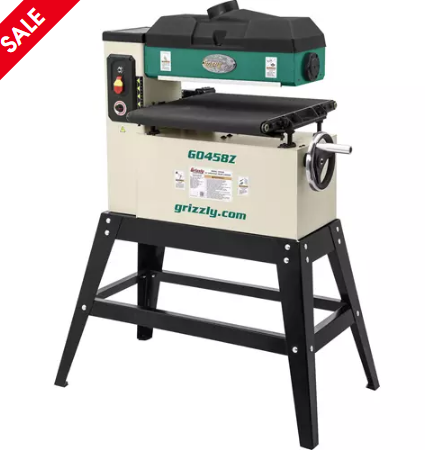

    I have been swamped, I got the parts for the mobile base and got it assembled. Putting the base to the sander together tomorrow. Running into a problem. The instructions say to tip the sander on its side, assemble the sander to the base, and then using 3 people to right the sander assembly on its feet. I do not have 3 people... Plus I need to lift this sucker onto the mobile base...
    How the heck am I supposed to do this?

    How much does this sucker weigh?
    Are you making another flip top stand? If the sander takes three people to lift it, then its going to be a ***** for one person to flip it even with a counterweight tool on the flip side.
    Looking it up
    https://cdn0.grizzly.com/manuals/g0458z_m.pdf
    has its own stand so No flip top. 235 pounds! Wow!
