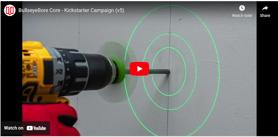

    This is a pretty nifty gimmick and if I had more money than skill or experience I can see the attraction of something like this. I don't think it gives a reference point to start so how is it really useful? Just like the built-in laser on my Ryobi, it can only be correct at one point between the head(or drill motor) and point to drill.
      • 3128
      I think the point of this is less to hit a specific mark but to keep you drilling square to the surface because it will make it easy to see if you're tilted when the rings are perfectly concentric. When I need that most is when I'm putting confirmat screws on the edge of a melamine cabinet and if half the circles were missing, I don't think it would be of much help.

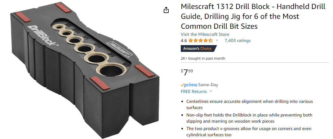

        THere's cheap solutions like this (restricted to standard 1/16th increment sizes) that only cost about 8 bucks,
        Click image for larger version  Name:	image.png Views:	0 Size:	206.8 KB ID:	857700

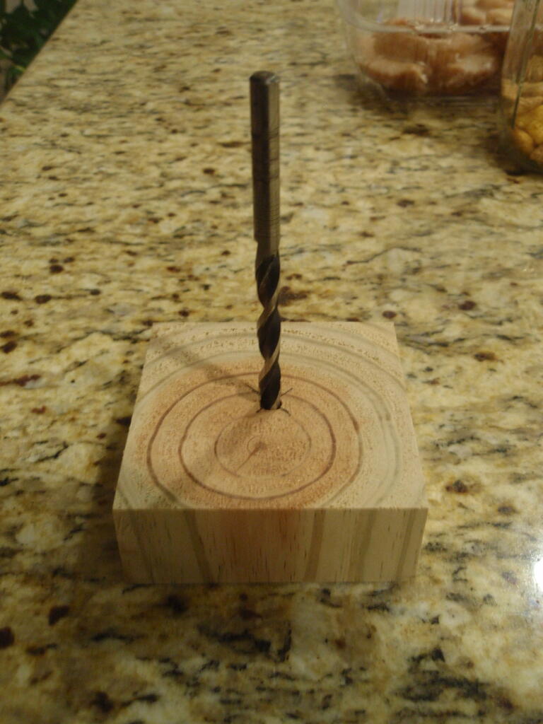

        Or, you can use my really cheap solution.
        I take a scrap of flat lumber, I kind of prefer a small piece of 2x4 maybe 3 inches long or more. I drill a perfectly perpendicular hole through it (more or less centered) using my drill press and the drill size I wish to use. Then I transfer the bit to your portable hand drill and slide the wood over the drill bit. Place the point of the bit where you have made a starting indentation, then slide the wood guide down to and flat against the surface and firmly hold it flat to the surface to be drilled, being careful to keep the bit placed. All you need to do is drill about an inch into the target. Then you can remove the wood guide block and drill the rest of the hole to any depth you want and it will continue straight. A piece of 1x material will also work but I like the thickness of the 2x4 to make sure its straight even with a little wear.
        • Cheap
        • Fits and works with any sized drill dia.
        • but you have to have a drill press

          Got an email... $129 for set of two to fit different chucks/drills? Not sure why 2 req'd. But I've been offered 40% off preproduction offer.
          I don't think I need one.
          Bullseyebore $129
          Commercial Milescraft drill block $8
