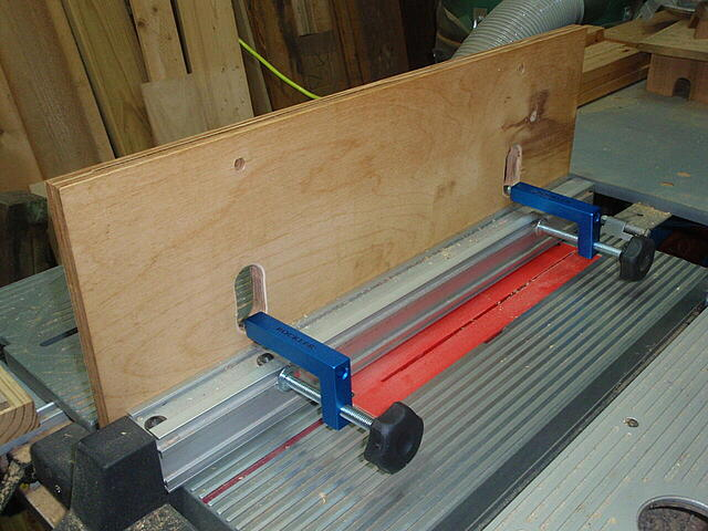

      Dave, you might look at my tall rip fence
      https://www.sawdustzone.org/forum/di...tall-rip-fence
      which uses fence clamps.
      Its somewhat easier to build the fence attachment part and you can still put some T-slots in the face of it to employ Suwat's attachments on it for miter splines, this rips, tenons, etc.
      No magic in the horizontal location of the clamps and slots... you can move them to suit the locations of the t-slots on the front.
      My recommended vertical location is in the drawing in the linked article.
