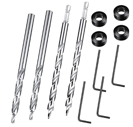

        Internet Fact Checker
        • 20983
        I see on Amazon there are a lot of vendors selling Kreg-like replacement step PH drill bits.
        What's curious to me is that they sell either pairs (one full shank and one 1/4" Hex shank) or two pairs (2 of each).
        Why is that?
        If I was buying I would want the same type of shank for all of mine. Not one of each.
