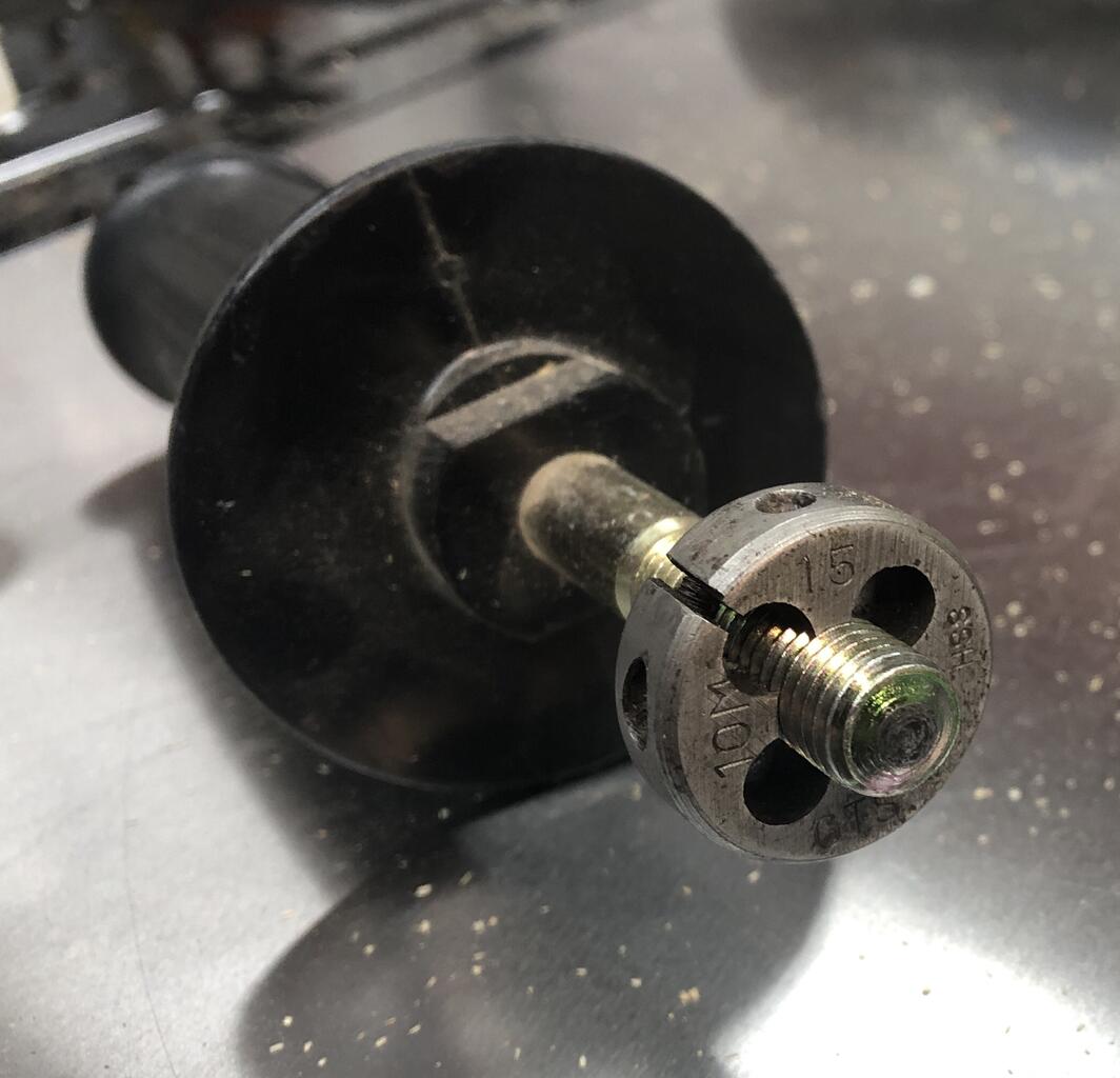

ID:	850612 I double checked, the questions made me doubt my tool. I checked and it is m10x1.5…. Like you said, whereas I wrote m10.5! What ! I found my note where I wrote my measurements down as 10x1.5. I guess I entered it down wrong or more than likely spell check got me. Nothing new with iPad!
