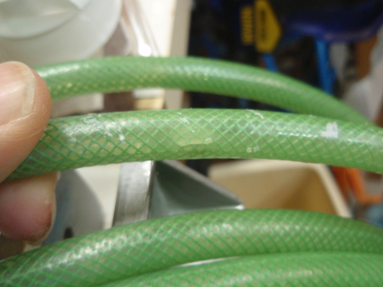

    I'm here today to specifically advise against the Hitachi/Metabo polyurethane air hose. They are bright green.
    I just had a second Hitachi hose fail with a hole; this one I have documented failed in 4 years. the First one had the same problem and failed in a similar timeframe, the failures are midway in the hose, not at the ends. I have not left these exposed to sunlight/UV, nor have I abused them running over them with heavy loads nor exposed to tight or abrasive corners. Just I think the PolyUrethane compound Hitachi uses is breaking down with short age.
    Maybe every four or five months I drag it out on my driveway to air the car tires, but its not severely abraded on the skin.
    I recall having tried to repair the first Hitachi hose with a splice but it failed again soon after.
    By contrast I have another hose which I bought in 2008 (12 years) in the same garage environment and its still fine. So polyurethane hoses can last.
    Thus I dis-recommend the Hitachi green polyurethane air hoses. A case where a name brand is not necessarily better.
    I just ordered and received the "same item" purchase again hose from Amazon I bought in 2008, but it looks different. So we'll see.

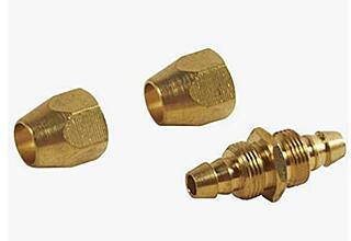

    And just out of curiosity I ordered a 1/4" to 1/4" hose coupling splice for $5 to repair the bad hose to see how long it lasts.https://www.amazon.com/gp/product/B0...?ie=UTF8&psc=1

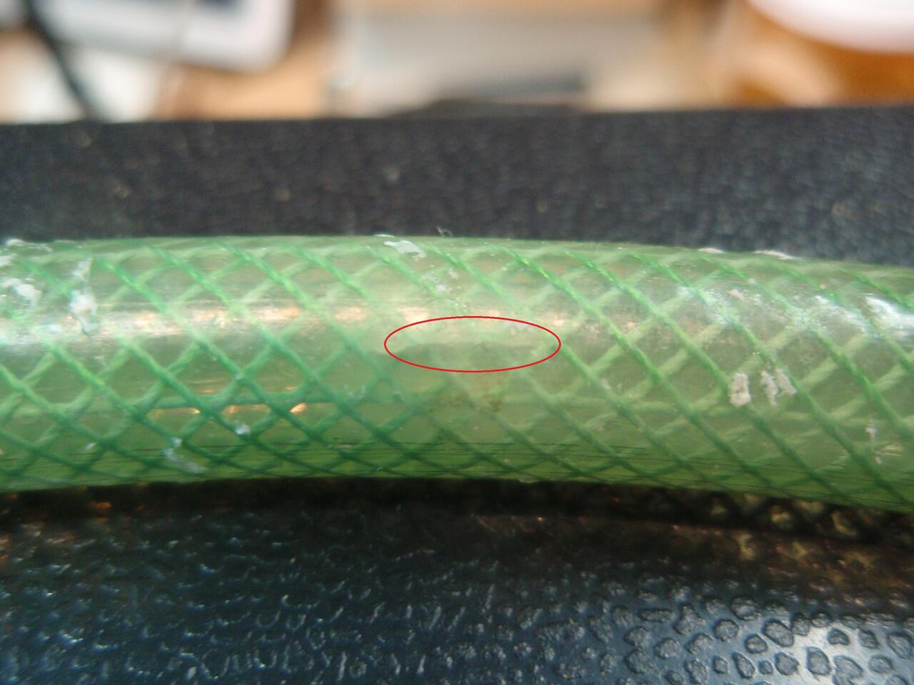

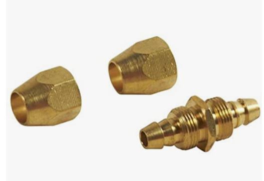

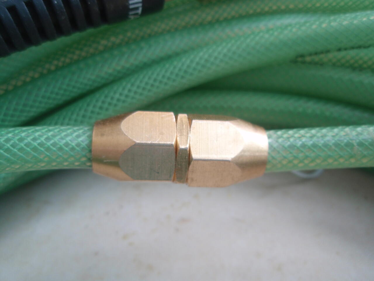

        for a few bucks, I got a hose coupler to repair the hose even though I got a new one.
        The hole - the tiny white slit in the center.
        Click image for larger version  Name:	P4110966.jpg Views:	0 Size:	104.5 KB ID:	849931
        Curious as to how long it will last before it pops another leak.

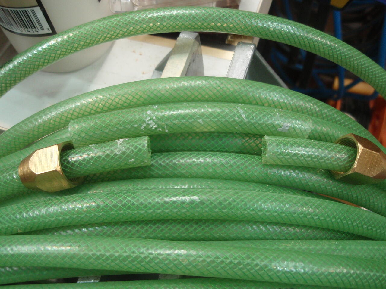

        The repair make sure to put the nuts on first. A little dish soap makes it easy to get the hose over the barbs.

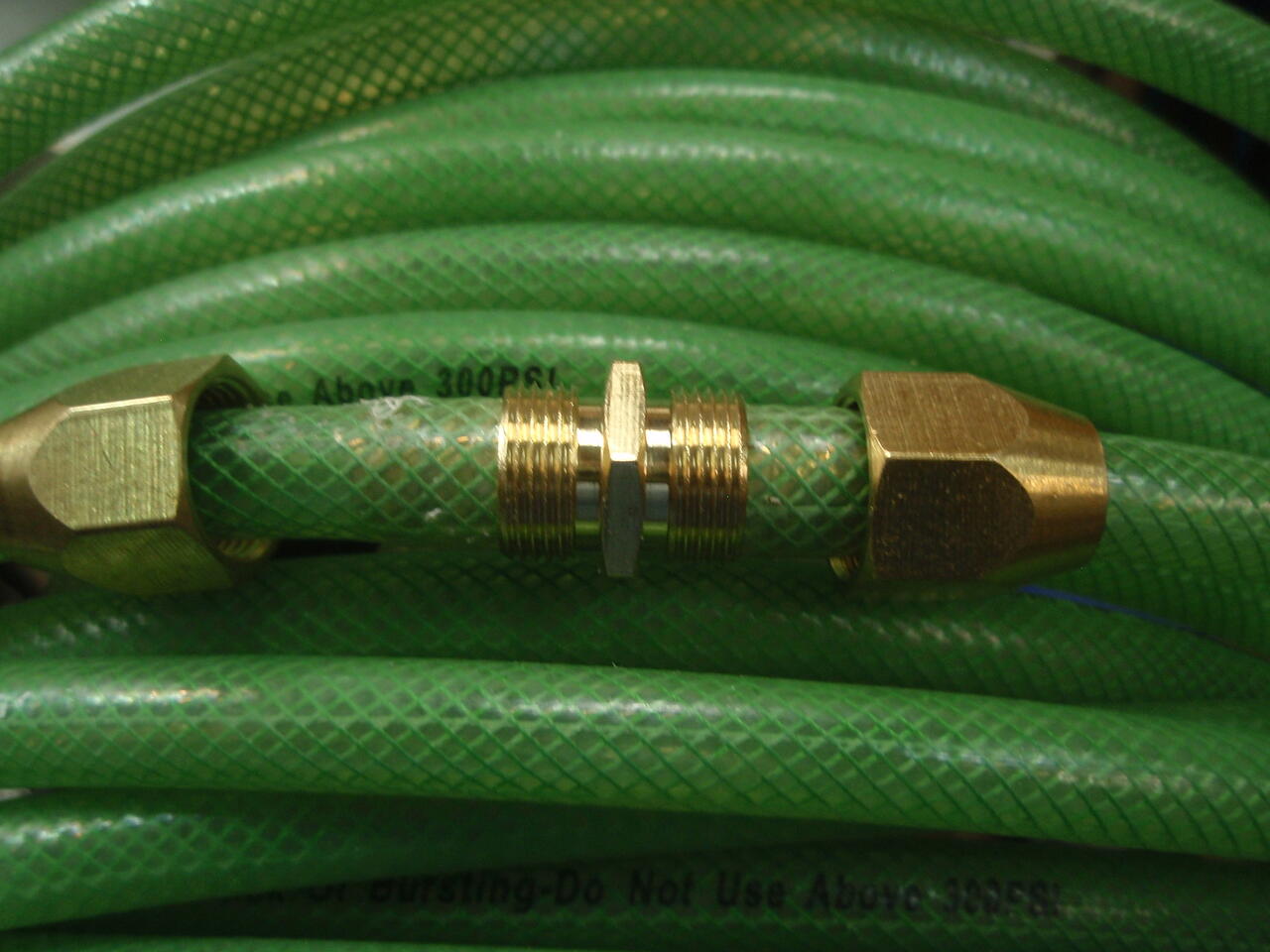

        Click image for larger version  Name:	P4110962.jpg Views:	0 Size:	90.7 KB ID:	849927 Click image for larger version  Name:	P4110963.jpg Views:	0 Size:	171.8 KB ID:	849930 Click image for larger version  Name:	P4110964.jpg Views:	0 Size:	116.6 KB ID:	849929 Click image for larger version  Name:	P4110965.jpg Views:	0 Size:	67.4 KB ID:	849926

          That lasted a long time - until the next time I pressured the hose. Developed a 1" long split elsewhere in the hose after 5 minutes of use indicating the general and not localized deterioration of the PU. Again, not a high stress area. Guess I'll save the splice and maybe the ends and toss the rest of the hose.

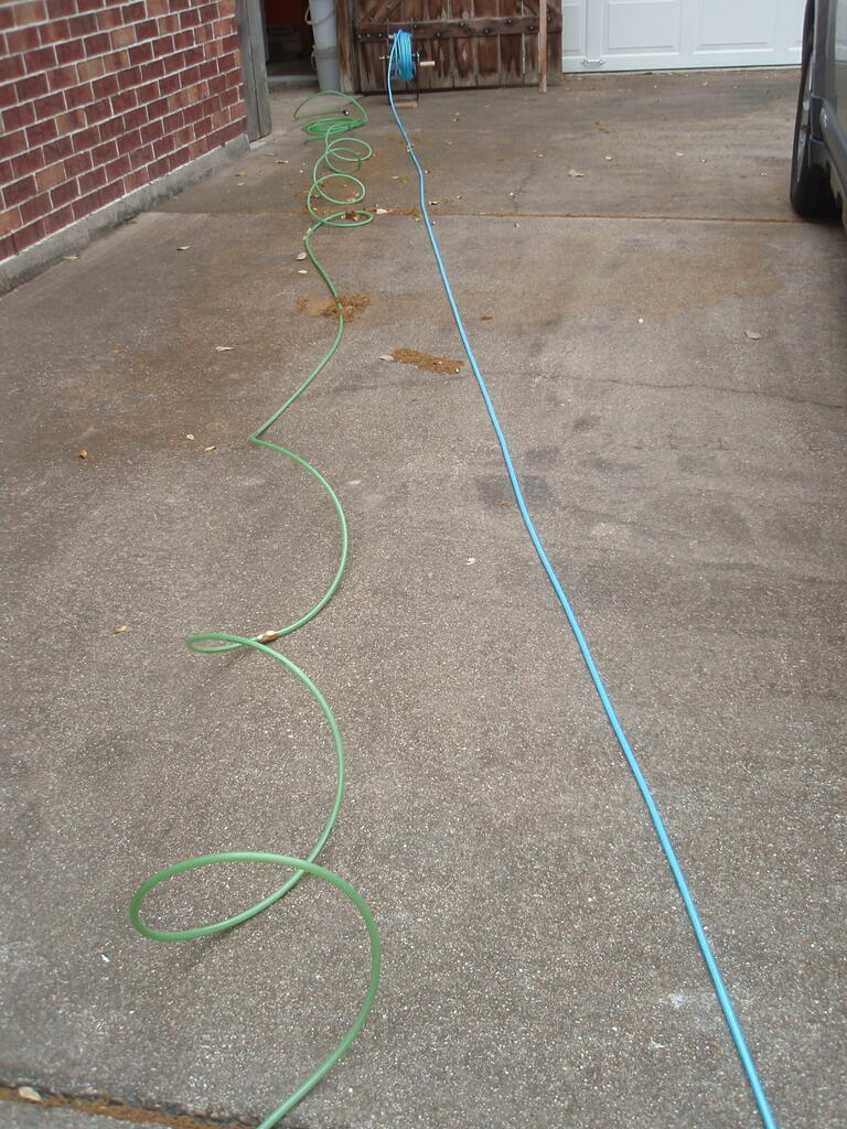

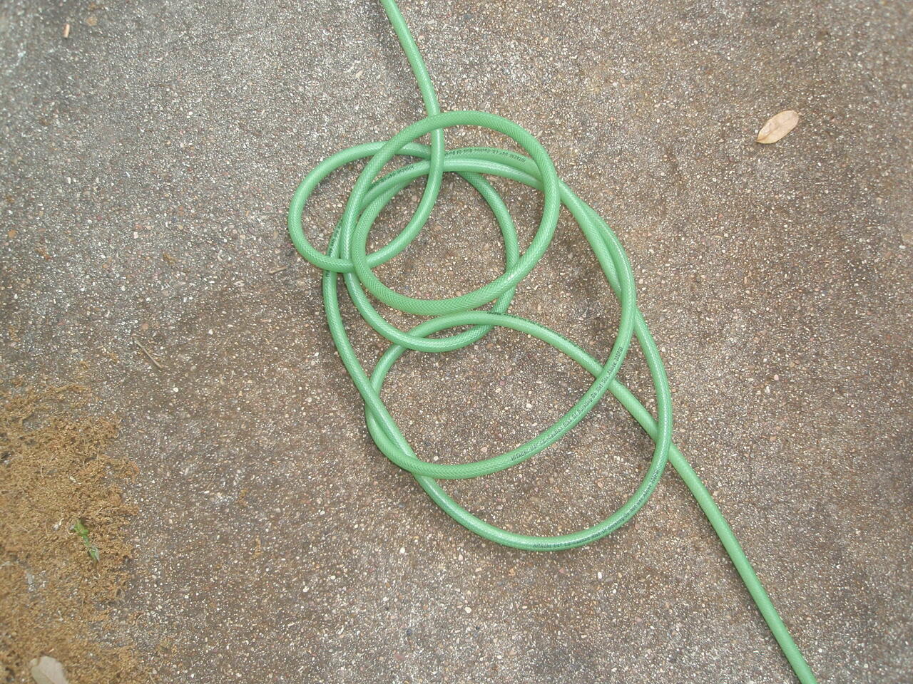

                  DBHost, this is how I used the Hitachi hose.
                  https://www.sawdustzone.org/forum/di...-air-hose-reel
                  Carried it outside and unreeled it when working on the car tires, mostly. And maybe once every other month. Not much wear and tear.
