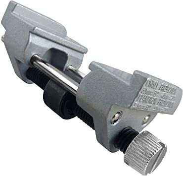

    This is an example of a mid-price kit that looks easy to use and convenient.
    https://www.amazon.com/gp/product/B0...UOBRAY0Y&psc=1

          I use a honing guide like the one in the picture of your link, and 400 - 600 grit PSA sandpaper on the cast iron table of my tablesaw (my flat surface). I do plane blades the same way. It's fast, easy, and cheap.

                          Just FWIW, my honing guide was bought at Woodcraft in Houston, not online, so I THOUGHT I was getting a decent one. It is more or less the same thing as the Amazon cheapie here... Seriously I cannot tell ANY difference from mine and this pic. This thing is like $14.00 on Amazon. I think I paid $30.00 at Woodcraft in 2008. WIsh I knew better then...

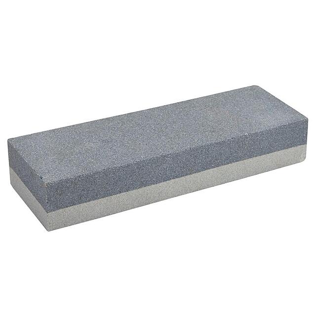

                          I have heard good things about the Gordon sharpening stone from Harbor Freight, and it is dirt money so considering my junk chisles right now, worth a gamble...
                          I think the "fine" side is 240 grit...

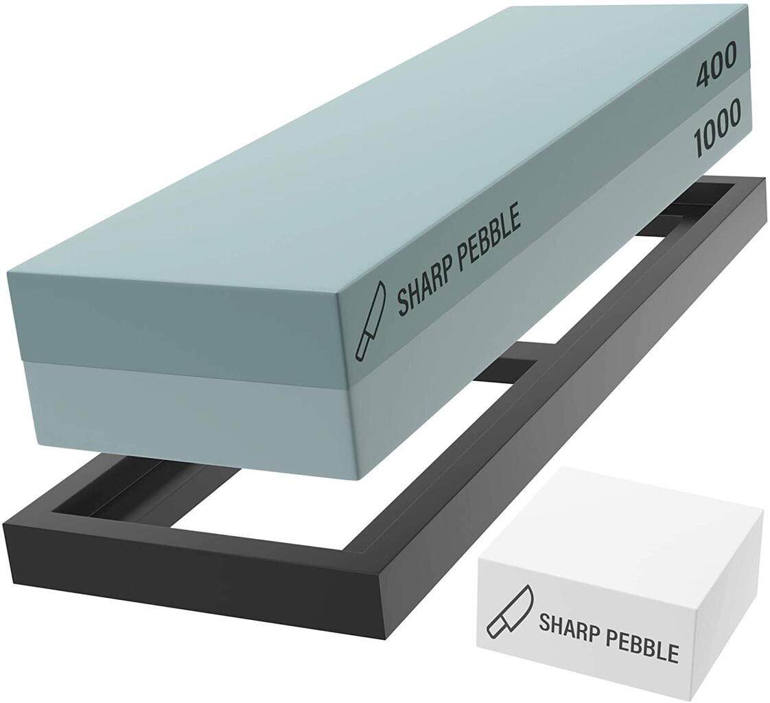

                          I don't see the need in honing past about 1K grit unless I am going for a mirror finish, and I believe someone else linked these 400 / 1000 grit water stones earlier in this thread maybe, from Amazon, fair price...
