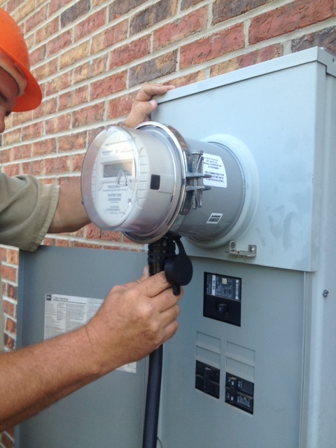

              Photo of GenerLink transfer switch. Even with a small portable generator I would recommend this device. If your utility provider has these it is set up like having a back yard Street light so the cost is nearly nothing.

                  Thanks for the pick of the GenerLink photo. That is helpful to me as I can see how it works. Simple. Thanks.

                  I need to think about this. Your picts make it look simple to hook up.

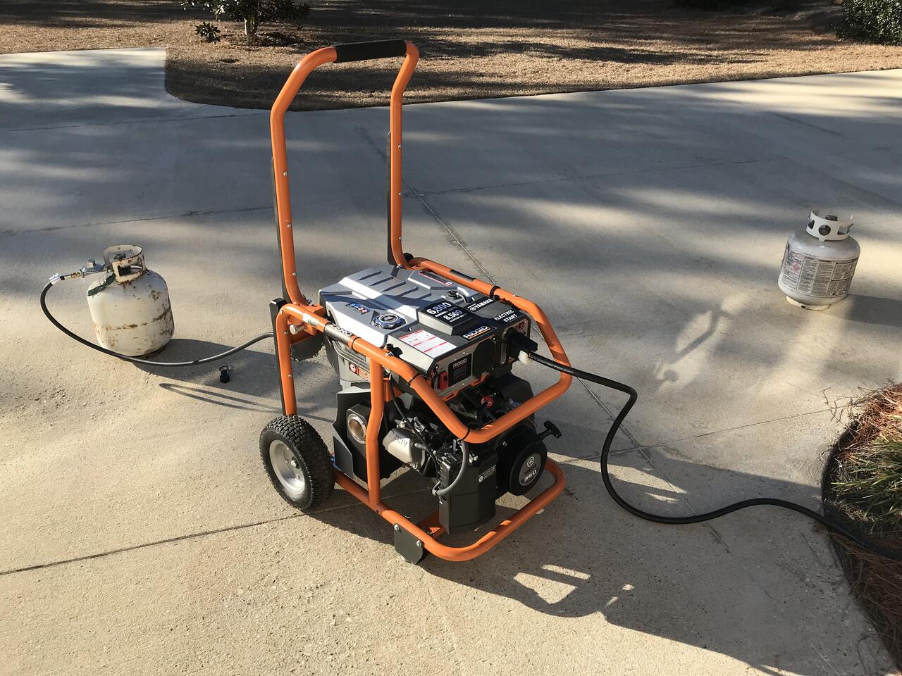

                    As portable generators go, the term “portable” is taken liberally by the manufacture’s. A 5000 watt generator with aprox 5hp gasoline motor and 5-6 gallon fuel tank is quite hard to move. Most manufacturers offer wheel kits, that’s nice of them. But they are difficult to store in a garage and if you have to go up steps it will require help with big muscles and a strong back, not a job your wife will like being asked to pitch in, Generators this size do not transport easily in cars either! We put my 5000 watt Craftsman in the back of a Honda CRV….. one time, it took 2 strong backs to get it in but it took 4 full grown weight lifters to get it out without tearing the car up! A pickup truck or trailer is in order, with the trailer bring the best choice! My new Rigid generator (13 hp Yamaha) is built like a hand truck and does move somewhat easier. I can load it in a trailer by myself, and it only takes 2 strong backs to load into a pickup truck. A 3000 watt generator is somewhat lighter but it is still awkward but can be loaded into an automobile with much grunting. This is good size for small construction sites and backyard projects.
                    That said, anyone seriously considering a generator for whatever purpose should look at its movability and storage and not just grab one because of price , and think about where you are going to store it. Just because it has wheels on it doesn’t mean it’s very portable!
                    photo of Rigid generator, IMO one of the most portable generators I’ve seen.
