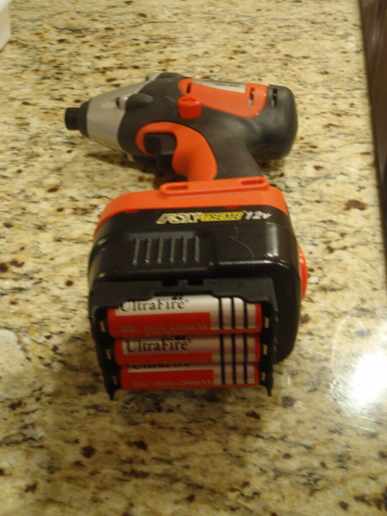

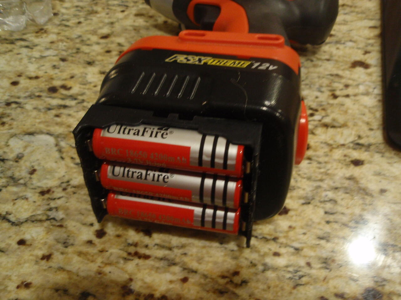

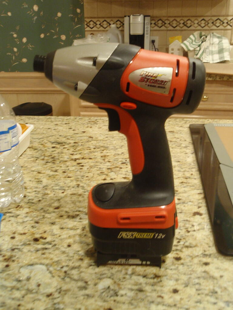

        I modified the battery packs - removed the NiCd cells, but the 18650 cells were a little too large to fit, so I attached the holder to the bottom.
        Click image for larger version  Name:	P1310815.JPG Views:	0 Size:	128.2 KB ID:	847968 Click image for larger version  Name:	P1310817.JPG Views:	0 Size:	100.7 KB ID:	847970 Click image for larger version  Name:	P1310816.JPG Views:	0 Size:	100.3 KB ID:	847969
        AFAIK, I fully charged the lithiums with 4.2-somthing volts with an individual smart charger and had over 12 on the pack. But the torque was low and inadequate for driving tough screws that even my electric screwdriver handles, I could not even get the impact action to run.
        I figured 11.1 nominal voltage would have run this thing, but unless my batteries were substandard, this thing is not running on 3 Lithium ion cells for whatever reason. I guess I am not going to invest anymore time into it. Shame, its a cute little unit.
        It spins but just has no torque.
