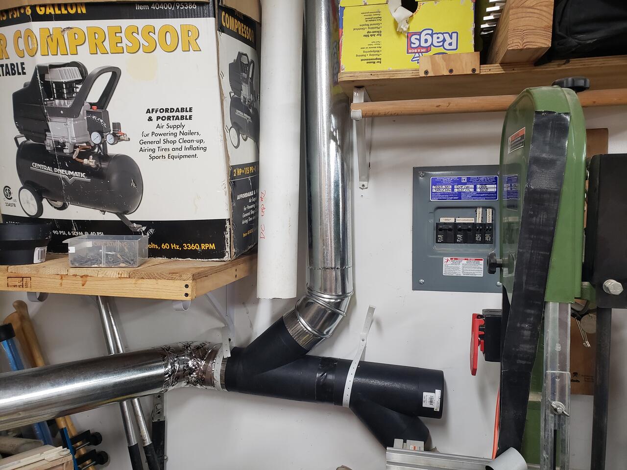

                  I pulled the 5x4x4 out, removed the connections hammered the 5" elbow already existings crimps as smooth as possible, hammered the new 5" elbows crimps as smooth as possible to get the fit I wanted Trying to orient the crimps OVER the plastic fittings, and aimed toward the dust collector to minimize drag.
                  Took and connected the 2 branch wyes together using Gorilla tape. It seems to work, worked before on the 4" stuff so sticking with a theme...
                  Planning on trying to use the 5x4x4 on the branch there to connect the band saw. I want an above the table pickup for it.

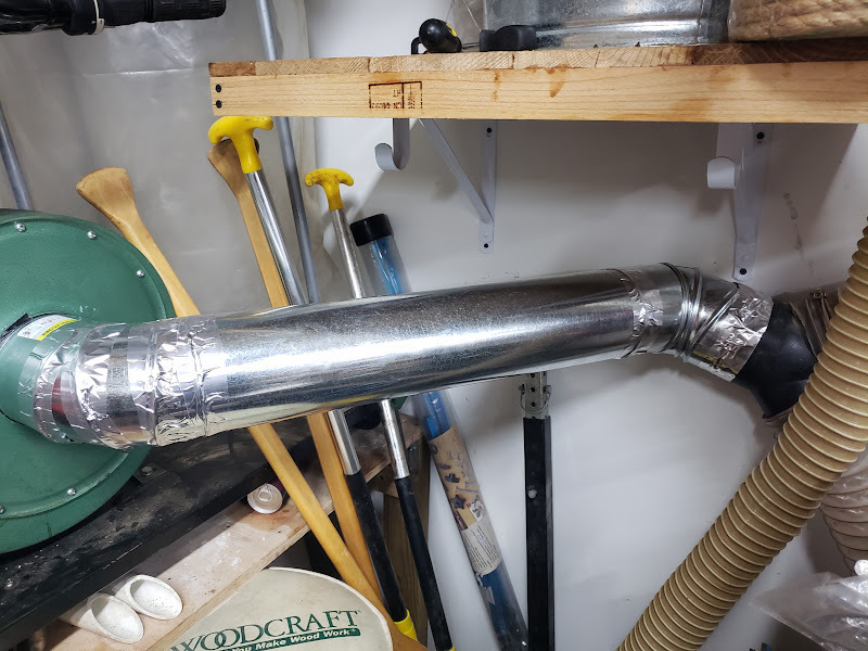

                    Reworking the ceiling run. Pulled it down. cleaned up the table saw drop and run to the miter saw. This will be redone again when I am ready to figure out exactly how I am going to redo dust collection on the miter saw. May end up springing for a deciated 5" run there, but until then....

                    Well, I am chugging right along with the install,a nd getting a bit tired of all the climbing, crawling, and, well all of it. And the mess it is making. Ugh....
                    It's looking pretty good though. At least along the main wall with the band saw, flip top stands, lathe etc... the blast gates are more or less "right there" with very little bend in the line, very little hose to deal with. The branch at the lathe could have been a 5x4x4 but I didn't have one. A 4" for the lathe, and a 4" for the drill press.. But I just didn't... I'm strapping it up against the wall as I go so it is nice and neatly installed, and I will rip out the remainder of the lower former run when finished... at some point.
                    Removing, or at least flattening the crimps enough to get a smooth connection to the branch wyes is a bit of a hand cramp inducer, but I am managing. It would have been easier had I considered the length of the pipe and the location of my vice but that is just me being an idiot...
                    I am probably NOT going to complete the install today, just for my own sanity sake. Just going to go at at easier pace...

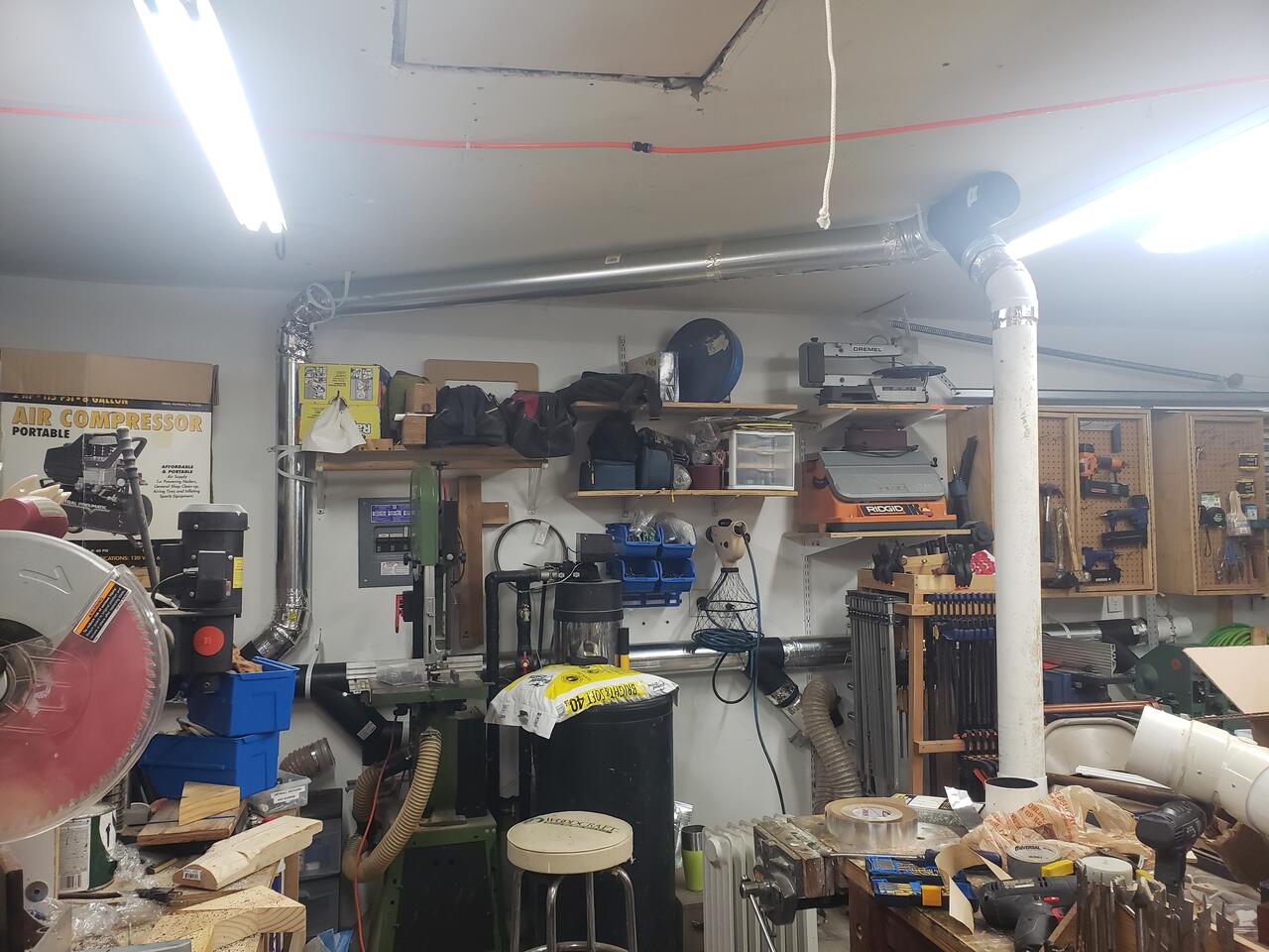

                      More progress. Lower run done. Upper run to the first drop...
                      2 5 footers and 1 3 footer left... I might make it...
