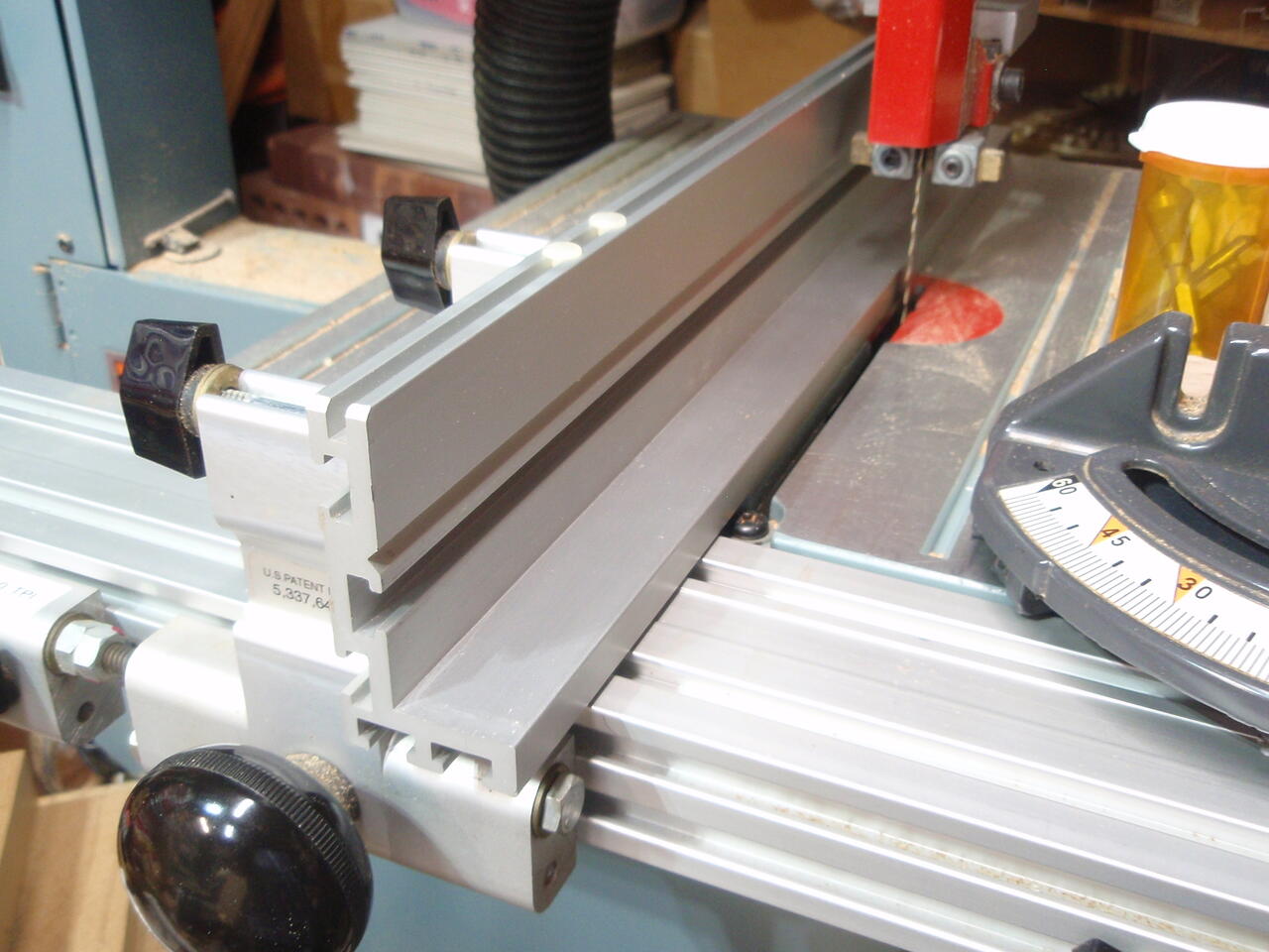

    For more than 15 years I've had this Fasttrak bandsaw fence system on my 12" Delta bandsaw.
    I've always used a homemade low rip fence for short and narrow rips because the various parts of the upper blade guide mechanism stuck out to the left side limiting how close you could move the 2-1/2" fence to the blade with an acceptable blade guide height.
    Click image for larger version  Name:	fetch?id=826885&d=1619197646.jpg Views:	0 Size:	117.6 KB ID:	847150
    Now after all these years I have suddenly discovered that the Fasttrak fence I have had all along is reversible to a low profile fence.
    Normal:
    Click image for larger version  Name:	P1060591.JPG Views:	0 Size:	129.9 KB ID:	847151
    Low profile:
    Click image for larger version  Name:	P1060593.JPG Views:	0 Size:	125.6 KB ID:	847152
