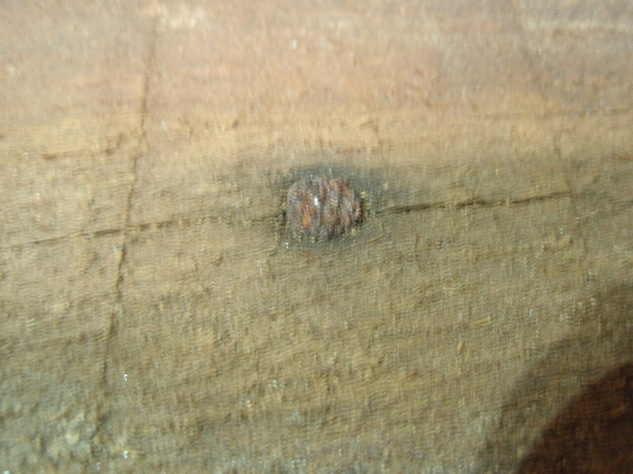

    I had some pieces of hardwood lumber from Lumber Liquidators from some time back. Very dirty with weathering and even some water marks but quite dried out. Looked OK. Chose a piece to use and ripped it some.
    Then put it on the jointer to clean up one side. Wham! A hidden nail took out 1/4" of my jointer blades.
    Here's what it looked like after the accident...
    Click image for larger version  Name:	P8240407.JPG Views:	0 Size:	169.6 KB ID:	844994

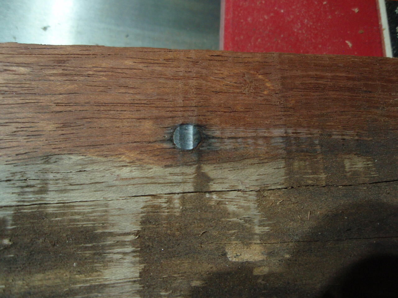

    I checked the other rips with a metal detector wand (which I stupidly failed to use prior) and found this on another piece
    Click image for larger version  Name:	P8240408.JPG Views:	0 Size:	137.5 KB ID:	844993
    I can see why I missed it visually. Could have wiped out my table saw blade as well.
    Don't be stupid, Don't be lazy. check all used and scrap lumber for nails with a metal detector before using your expensive tools.

      That nail was completely buried and invisible?
        Internet Fact Checker
        • 20978
        I did a visual but the board was quite dirty. There was a couple of visible holes where a nail had been obviously pulled. The second picture in the original post shows a second nail I found after planing thru the first one, this time looking with a metal detector and found it and it was pretty much hidden and not obvious; the color was dirty brown the same as the wood.
        I don't know exactly how buried the nail I hit was, it was too late after I found it, no before picture. I have this imagination that maybe it was buried but in reality it was probably not, but just hard to see. Probably looked like the second nail picture.

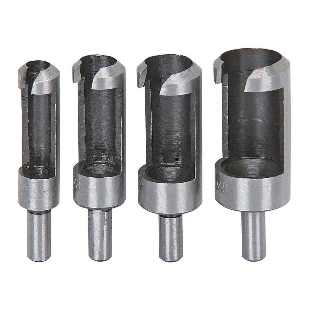

              Cut around them and toss that piece. For Brads, you can sometimes drive them through and yank them out easier than pulling them, not possible with big heads. Or, use a plug cutter to cut around it and either cut through the board or break off the stub and pull the remnants then plug it with a dowel or plug cut from somewhere else.; either contrasting or matching.

                I have several sets of plug cutters, none of which are up to the task of cutting around a nail buried in a piece or red oak or heart pine. They burn out quickly. There may be some quality cutters but I haven’t found one yet! Sacrificing a $25 board, cutting it into short pieces to avoid nails is still cheaper than destroying the planer blades.
