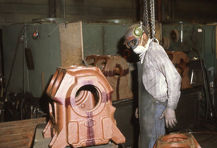

                    Yes Lee, using an air hose is a major problem without eye protection. Imagine working in something like the machine shops of our plant, where we're milling steel, brass, and gray iron. One of the reasons that safety glasses with side shields were absolutely mandatory was because of air-hose driven iron dust and chips. Unlike using a shop vac, compressed air can generate some pretty high velocity chips that can ricochet off the machine and other things.
                    Many years ago I was taking pictures for a slide presentation and took this picture in our foundry. I can't remember exactly what that guy was doing, but he moved back as I was taking the shot. It was one of several I had set aside, but the engineer I was doing the project for, thought it quite funny and decided to use it.
                    During his presentation, he flashed it up on the screen as an example of what we do to someone who isn't wearing the necessary safety equipment properly. I think his comment was something like, "We dress him up in everything and then dangle him on a chain hoist for the rest of his shift!"
