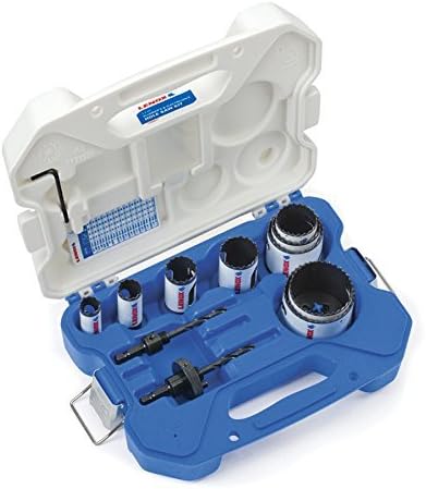

          I have a nice Lennox set of hole saws.
          They work pretty well, but the first times using them I had the problem with the gullets loading up and starting to burn while not cutting any more.
