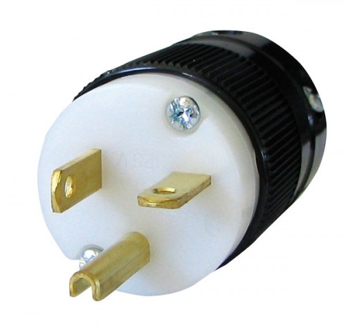

                          Originally posted by phrog
                          ... How can you tell, for sure if the circuit is 15 or 20 A?
                          Just got back from three weeks w/o much internet access.
                          The breaker will tell for sure. It will either be a 15A or 20A in all likelihood.
                          The 20A circuit should have heavier wiring - 12 Ga IIRC, the 15A can get by with 14 Ga.
                          The other "tell" is the type of plug and receptacle.
                          For 20A appliances you should have a NEMA 5-20P plug
Name:	Nema 5-15 and 20 plugs and recept.jpg
                          The normal 120VAC 15A AC plug (NEMA 5-15P) has two parallel prongs.
                          The 20A (NEAM 5-20P) has one vertical, one horizontal prong. (better pic below)
Name:	NEMA 5-20P.jpg
                          The 15A receptacle (NEMA 5-15R) has two parallel slots
                          The 20A receptacle (NEMA 5-20R) has one vertical slot and one slot with a T so that it will accept either 15 or 20A plugs!
                          Theoretically your BS should have a 120VAC 20A plug and if you have a 20A circuit it should have an outlet with a 20A receptacle (although its quite OK to have just 15A receptacles if you plan on plugging only appliances drawing 15A or less into it.
                          Having the correct plug on your 20A BS prevents you from plugging it into a 15A receptacle and possibly tripping the breaker at high cutting loads, although the circuit breaker should save you from any disaster.
                          If you have a 20A branch (correct breaker and wiring) the personally I would spend 4-5 bucks and put the right receptacle and plugs on.
                          You can get them readily at Lowes or HD, NEMA 5-20P and NEMA 5-20R, they are a little more expensive than the 15A mainly because they don't sell near as many.
                          BTW, it's Y'all's he should have used.
