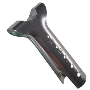

    So, I'm getting my tools in order and in doing so I'm reminded of how much I hate slicing the sheathing on Romex (NM cable and the like). Probably just me, but those folded-steel tools are a bear to use and it seems like a lot more effort than it should be.
    So I'm thinking there ought to be a better way by now (my Dad used those rippers, and taught me in my teen years back in the late 50's). So a little bit of browsing and I discovered this:

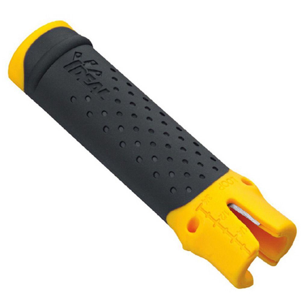

    It's made by Ideal and is named the Lil' Ripper/Stripper (#45-025). Did some checking and found Home Depot has them (but Lowes doesn't, not yet anyway) for about $5, which isn't much more than the traditional ripper. Here's a YouTube video produced by Ideal:
    https://www.youtube.com/watch?v=Klp2kFyYgFA
    I bought this tool yesterday and I am very impressed. The job is so simple and easy that even my wife can do it. In addition to ripping the sheathing with far less effort, the tool also has a cutter to remove the loosened sheathing, strip the wires, and can even perfectly form the hook for fastening to the fixture screw. In addition, it can also be used to give you a bit more leverage when tightening wire nuts.
    - rips NM sheathing
    - slices off the split
    - strips the wire
    - loops the copper for the terminal screw
    - twists the wire nut
    Many of you may already know of this (then why haven't I seen a post? ), but in case you don't, I thought it well worth the posting... even though it's not exactly woodworking.
    ps No affiliation whatsoever... just thought it a neat tool

    That is a "gotta have" tool for me. I don't do electrical regularly but often enough. That was an informative video. Thanks.

      Glad you too thought it was a neat tool. I've actually found it pretty handy, considering before I'd have to first use the Romex Slicer, then the side cutters, then the wire strippers and finally the needle nose pliers to bend the hook in the wire. Now I just use this tool which you can stick in your shirt pocket.
      I wonder why they didn't find a way to incorporate a screwdriver too... to tighten the terminal screws?

          OK, now I gotta' have one! Many times I rip the sheathing off with a utility knife with the blade just barely protruding and I end up knicking the insulation inside. Looks really handy compared to switching back and forth between various tools.

            That's a cool tool I didn't know about. I have the original silver sheath remover but in practice I tend to just slit the end of the romex with a knife then use the ground conductor like a zip cord which works pretty well (then cut of the outer sheath with a box cutter. I have a standard stripping tool (by Ideal also) that does all the other stuff, although I prefer using a pliers for the wire twists.

                I've never noticed that tool before. I've done a fair amount of wiring the past few years, and always used either the sheet metal version or a utility knife. I'm going to be doing a lot of wiring (finishing my basement) this summer, and it looks like a time-saver. I'll be picking one up on my next trip to HD. Thanks for sharing!

                  Over this past weekend, I was helping my FIL wire a few outlets in his basement. I never really noticed how much "tool-switching" I normally do (cut off the excess romex, strip the sheath, cut the stripped sheath, strip the insulation, make hooks on the ends, loosen/tighten the screws to the receptacle, screw the receptacle to the box). If the tool works well, it could eliminate/minimize the tool changes in the middle.

                    Here's a follow-up review, after using the tool a bit. If you need to remove a lot of romex sheathing, this thing is great. But, for the majority of electrical work I found myself sticking with my other tools.
                        While it is definitely the tool of choice for stripping the sheathing on Romex, I too find my auto-strippers and needle nose pliers quicker and more familiar when stripping the wire ends and bending to fit the screw. But even then, there are a few times when I just go ahead with the "Ripper/Stripper" as it's already in my hand.
                        For the $15 or $20 that it might sell for on Amazon, I don't think I would ever have given it a try; but, finding this little tool for $5 at my local HD was well worth it. Basically, I hate those sheet-metal strippers. Probably just me, as I don't do electrical work for a living or even on a monthly basis, but I find those sheet-metal stripper hard to use with any finesse. Always seems to pull too hard and most of the time I find it tears off to the side... perhaps poor technique on my part. With this stripper, its far easier and the slice is flawless.
