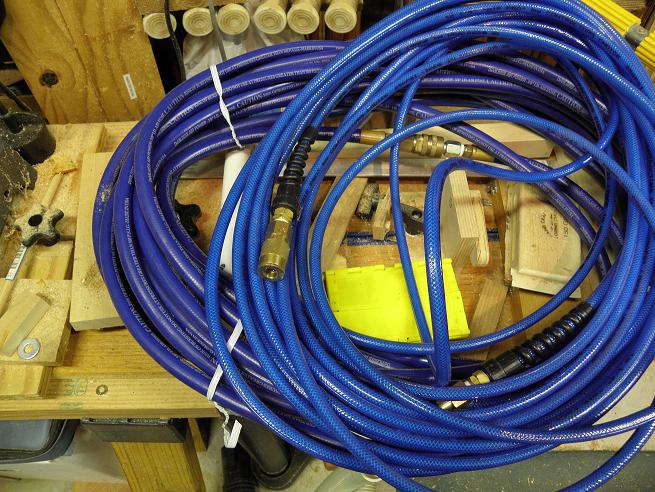

            so here's a PVC hose on the bottom and a PU hose on top...
            Blue doesn't mean anything.
            FWIW the PU hoses seem to be 1/4" ID vs. 3/8" ID for PU and rubber hoses... if you have high flow requirements that may make a difference.
            For air nailers and small tools and blow nozzles it doesn't make much difference.

                    PU has a different kind of stiffness. It is very stiff in twist (maybe because of the reinforcement). If its laying out straight and flat, and you take one end and twist it 360 degrees, the other free end will probably turn 359 degrees. So when you roll it up, it will have one twist per loop. If you pull the loops off the side of the roll then you will have a big slinky. If you untwist it as you take it off the roll (or use a rotating reel) then the sucker will lay flat and straight with no memory. Because its so light and thin, its really not much of an issue to untwist it when I need to lay it out straight and flat. And then retwist it to roll it up. I imagione it would work great on a reel. It's very flexible as opposed to stiff - I can bend it into a tight loop:
                    PVC has a lot of memory esp when cold. If stored rolled up, and its 50 degrees temperaure, you will never get that thing to lay flat and straight to save your life. Its still very difficult when its warm.
