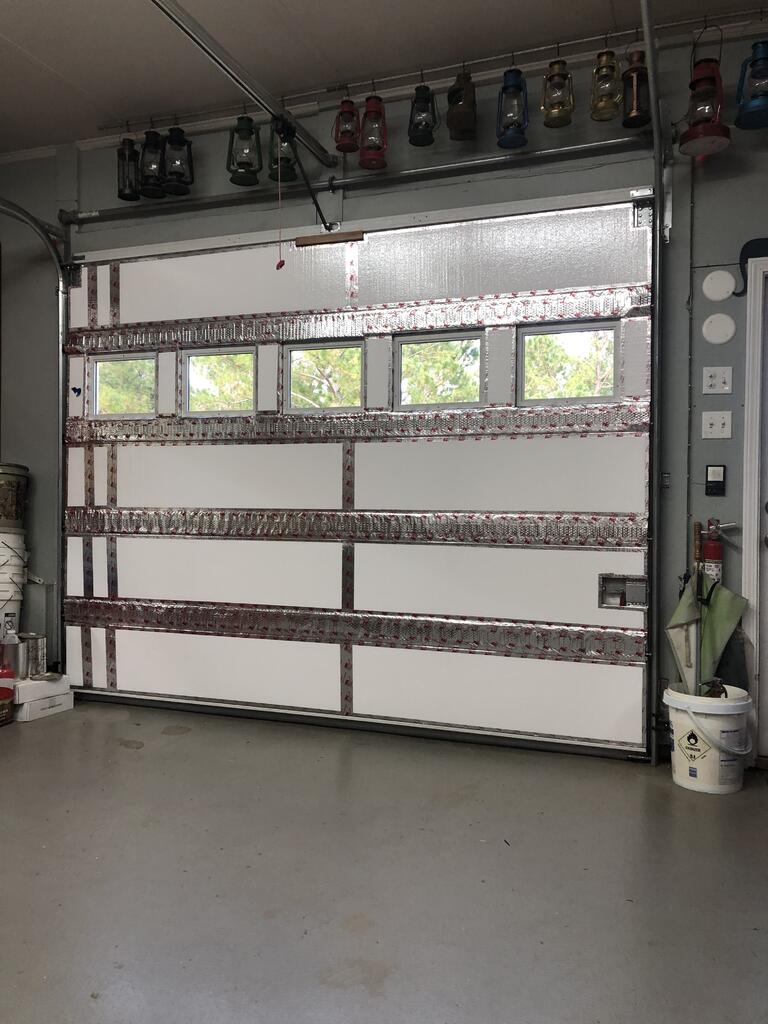

    I cooled my 750sf shop with a already used 14000 btu Westinghouse heat pump through the wall unit for 12 years until it died of overwork due to Hurricane Michael sucking all the insulation out of my attic. It was replaced with a 24000 btu Amana heat pump through the wall unit and the attic insulation was replaced with spray foam. This new smart AC doesn’t heat and cool as well as the 14,000 btu unit and I had to add a garage door insulation package to the existing insulated garage door to get this air conditioner to be able to cycle on and off properly. …… So you will most certainly have to insulate your garage door. I also blocked the garage door windows with bubble insulation and could tell a noticeable difference. Click image for larger version

      My doors are insulated with 2 layers of R-Max 5 so a combined total of R10 is all I could fit... Due to the face I actually still use the doors to get material and my happy behind in / out when I am working in the driveway, I can't tape the joints. I need to replace the door gaskets. I have them all around but after 12 years fo Texas sun they are hurting...I will be adding a 10x12 shed as soon as I rip out a crepe myrtle in the back yard that is in the way, and I have NEVER liked... Nice in the front yard, ticks me off out back... Once my lawn and garden, and camping stuff is in the shed, I move my lumber off the racks and blow in insulation on the remaining wall, then patch the wall, paint and enjoy HVAC space... They jump from 12K to 18K BTU, I have the outlet ready to go, just need to figure out where to put the ouside unit.... I am going to plant new bushes so I may be able to conceal it behind a bush and keep the HOA off my tail...

      Not sure how I didn't notice earlier. What's with the hurricane lanterns?

    The door insulation in my photo shows the hinges covered by Reflectix Tin foil bubble wrap type insulation that allows the hinges to flex so the door easily opens. The hurricane lanterns are something that I collected and used on our patio.
