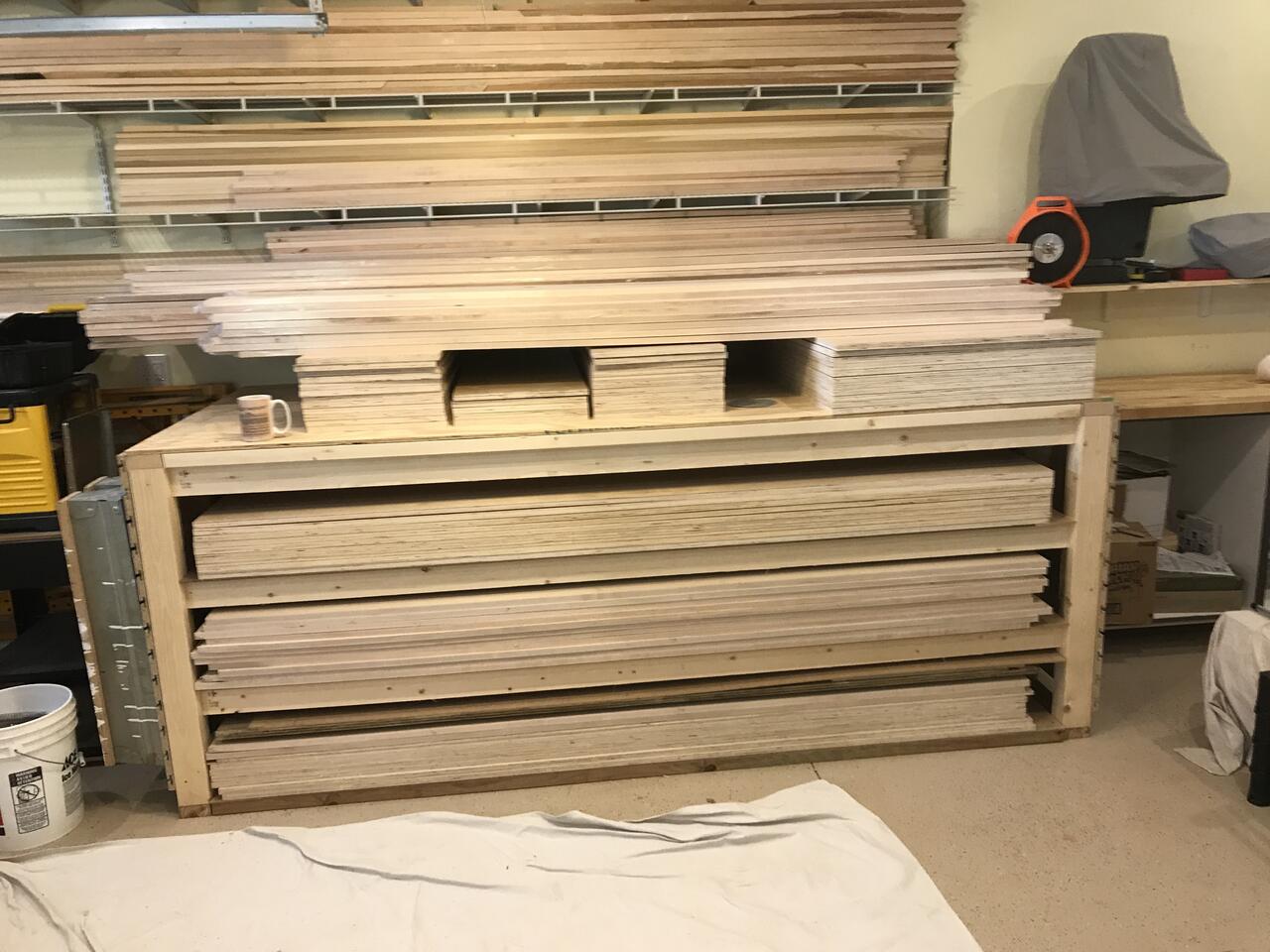

    So as the new shop is getting much closer to completion, I closed out my storage unit and have about 500 board feet of lumber in my trailer. Mostly Birch, poplar, maple and white oak. In my old shop and in the storage unit, I used heavy duty rubbermaid shelving attached to the wall with 4" #10 screws into the 2x6 walls of the shop and had np problems no matter how much they were loaded up. You can see my sheet goods storage that shows the lumber racks above. These went to the ceiling so about 6' of shelves vertically and 16 feet long.
