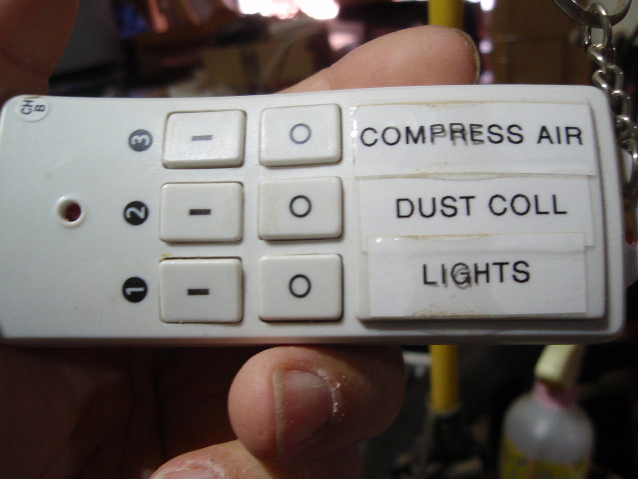

    I was lucky to have found this three channel wireless remote control. Comes with three remote controlled outlets and one controls Hangs between my router table and table saw.

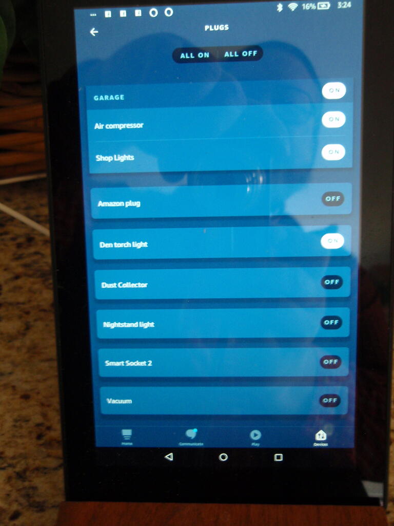

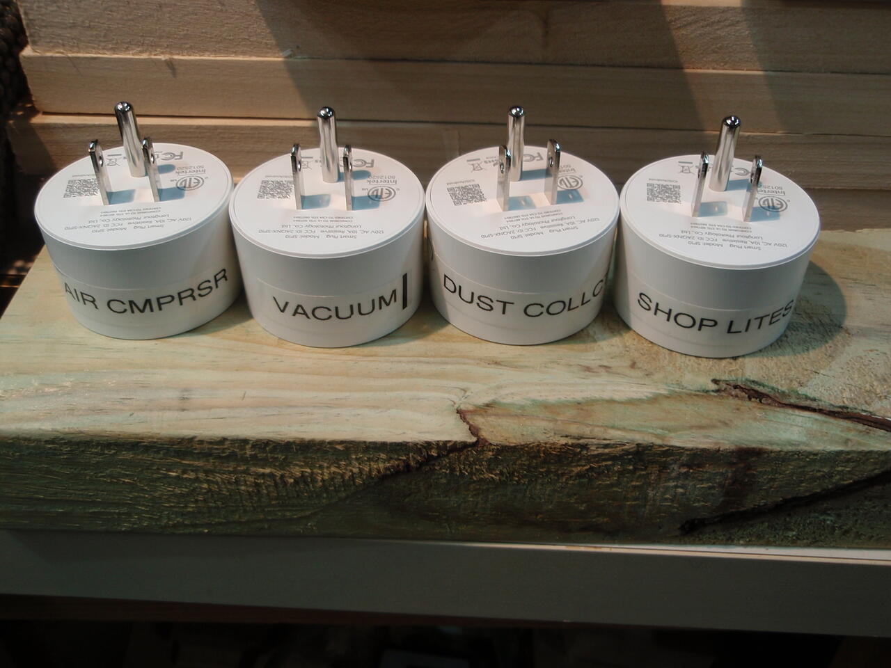

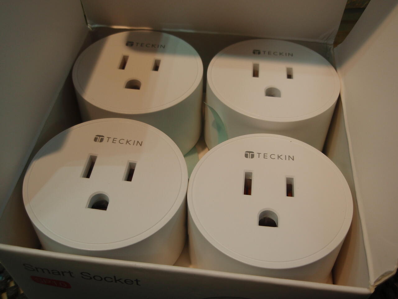

                  I did it. A four pack of remote wifi plugs and my garage shop is now on remote control lights, shop vac for dust on the miter saw, dust collector on the table saw, lights and air compressor. Took me an hour and a half late last night to program four devices, label them, name them, assign them to groups and add to Google Home and Alexa, and test. About ten minutes to install this morning.
                  I put the lights and the air compressor on a group called Garage so I can turn off both or turn them on from the house before going out or going to bed. I include the vacuum and dust collector to a separate Shop group because I don't want to accidentally command them with the lights from the house, but command them individually when needed.
                  The WIFI remote plugs are rated for 10 Amps resistive. The compressor and the dust collector are on my relay boxes with 30 A relays. https://www.sawdustzone.org/articles...ay-booster-box
                  The air cleaner is on a mechanical spring timer, I'll turn it on for 4 or 6 hours at the beginning and leave it on.
                  Drill press and bandsaw share another tool powered switch for their shop vac.
                  Works! Kindle responds to voice control even while the dust collector is running.

                      I don't need to operate the DC and Vacuum from the house, but want to turn them on by voice when I'm lining up the table saw just before I turn it on. The Remote switches shown in the first post hung right by the table saw. Now I can control lights and Air compressor from the house If I decide to shut down for the night, but I can also control the vacuum, DC and air compressor and light from within the shop when I find I need them on without moving away from the tools.

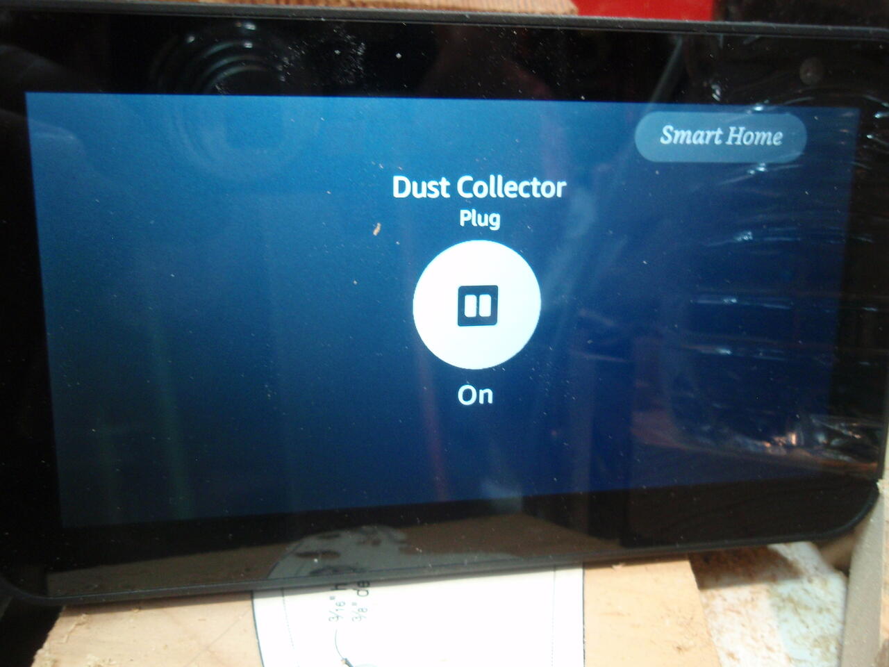

                        Bought last years Amazon Echo Show 5 (Alexa enabled) for $35.
                        Works better in the shop than the Amazon Fire tablet I was using to run Alexa.. Voice recognition is better, esp. when vac or DC is running and want to turn it off. Better yet, when you turn stuff on it leaves a touch screen way to turn it off if you can't yell over the machine.
