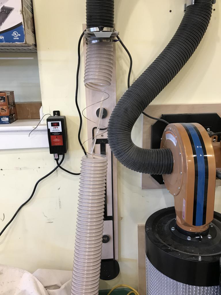

          Until I upgraded to a 3hp cyclone a few years ago I used the Rockler version of this. Looks similar but mine had lower CFM. I used the Rockler dust right collapsable hose and their quick connect handle and outlets for my 4 big machines. Rockler has improved their flex hose. The first clear version split after a few months of use. The newer Blue version is heavier and lasted years without any issues.
          I came into the shop one morning and found this.
          Split dustright hose
