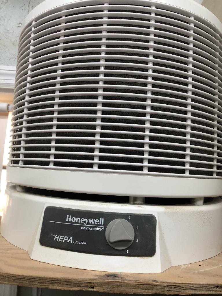

                    • 3765
                    I have a couple of Honeywell Hepa air filters that usually run 24/7. I don’t remember the cfm data but I believe they are each rated for 350sf. I purchased these and a couple for the house at yard sales for cheap each, they were once popular with smokers who felt guilty about smoking in their houses. Since installing the Clearview dust collector and running it every time a piece of dust producing equipment is turned on, with the help of the Honeywell filters I see little to no dust on anything. I clean the Honeywell filters when I see the clean filter indicator light, every 4-6 months. Click image for larger version  Name:	D9C78E6E-B422-4CBD-8B12-78AA020966D2.jpeg Views:	0 Size:	124.6 KB ID:	838279
                    I don’t see any benefit in turning them off when I’m not in the shop to keep from wearing them out because I know people that have had them turned on continuously for over 30 years and they are still going strong. I was amazed at the amount of cat and dog hair that they filter out of the air when I looked at a neighbors Honeywell filter in his house. They clean the filter weekly and it still looked like a fur ball.

                      I ran one of those Honeywell "drum" units for 20 years in the house. I forget what finally failed on it, but 20 years of always on is a good run, in my book.

                        I started finding these Honeywell “drum” air cleaners in yard sales for $5-$10 each a few years ago. I also see a good many of them at Goodwill stores for about the same cost. I highly recommend them for a on the cheap shop air cleaner. They may not be as good as a jet but for $50 you can get enough Honeywell cleaners to suck all the air our of the room.
