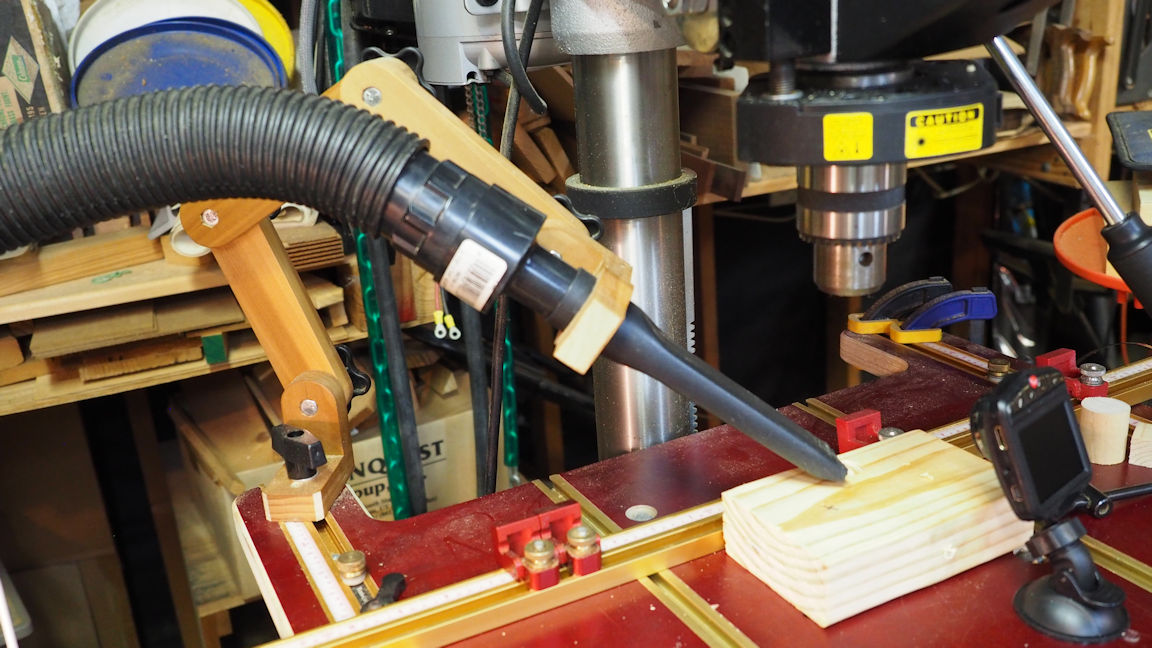

        For my next trick, a drill press vacuum device. I was inspired by Rod Kirby for this.
        A multi-section articulated arm holding a shop-vac slim nozzle attachment makes a good drill press dust collection. I use an auto-trigger relay to turn on the Vac when the drill press is on.
        Works with twist bits, brad point bits and forstners. Keeps the workpiece clean and the hole visible without having to bend over and blow, haha.
        Some stuff gets away with really large forstners and high RPMs - probably have to put suckers on both sides! Some large forstners also have large shavings that can clog up this particular nozzle.But mostly it works quite well.
        I cut/bevelled away a little of the underside of the vac nozzle - it lets in bigger shavings you get from forstners and allows pickup from under the noozle.
        Short 10-second video if you click the link. You have to click on it to download it and likely open it to play it on your PC. Older version of Windows media player (win 7) won't play that version of MP4 but Win 10 Media player will. I use VLC media player it works for MP4 in all versions of windows.
        short vac video.mp4

          I like the drill press vacuum. I think I will fab one of these up for my band saw and hook it up to the dust collector. It's got such crappy dust collection as it is.

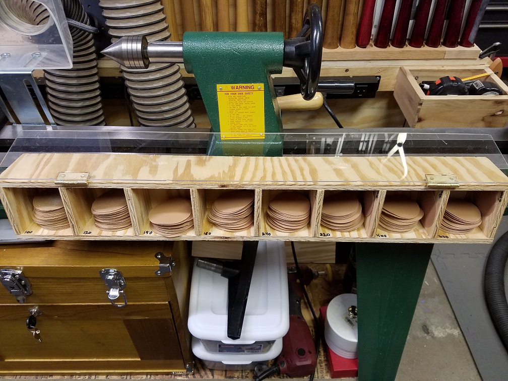

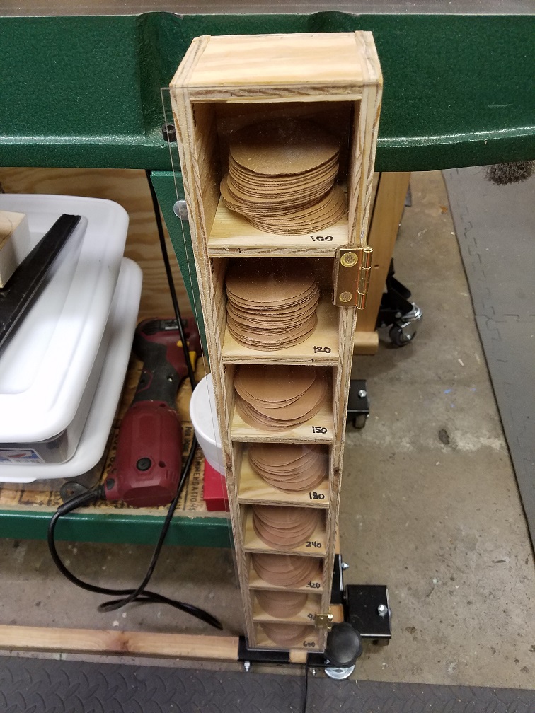

            Storage shelf for sandpaper disks which I use for sanding bowls. Has a clear hinged door to keep out shavings, and a HF magnetic strip on the back, so I can orient it vertically, or horizontally.

              Cool execution!

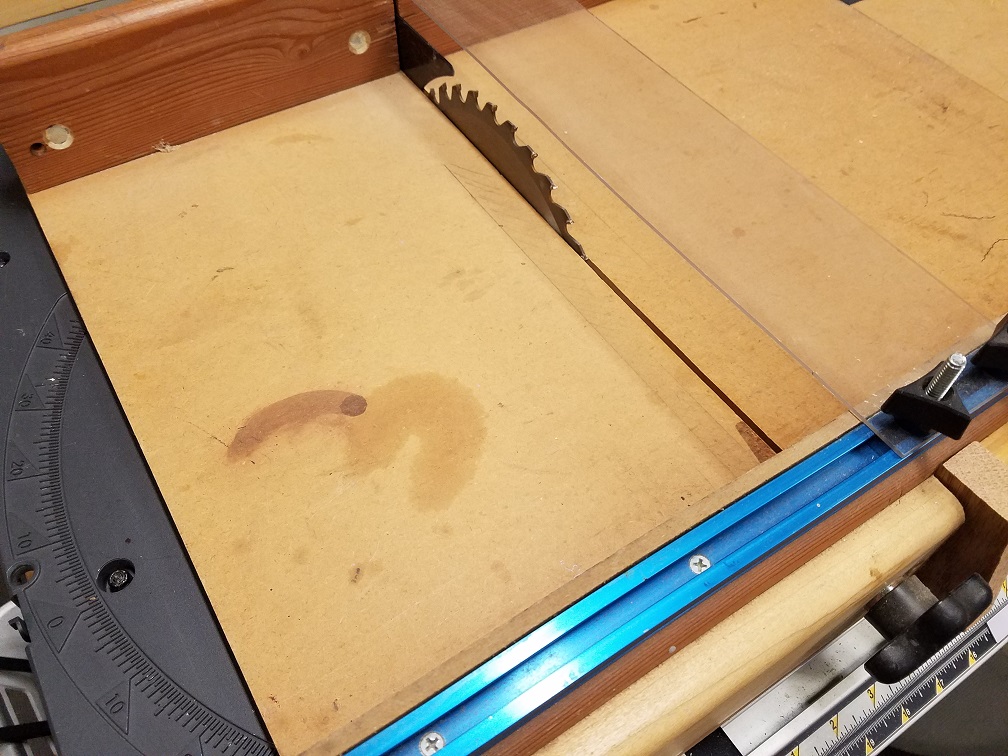

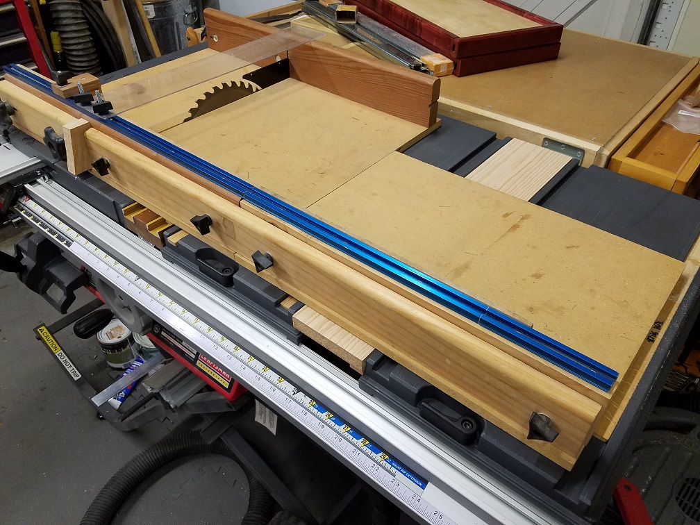

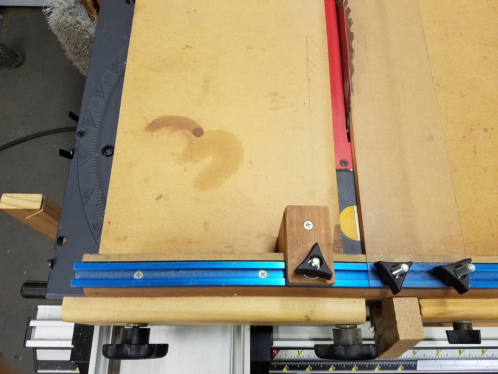

            I made this table saw sled out of shop scraps (except for the t-slot track) based on a magazine article. It is adjustable from zero clearance to dado widths. I also added the left-side extension to carry longer boards. Click image for larger version

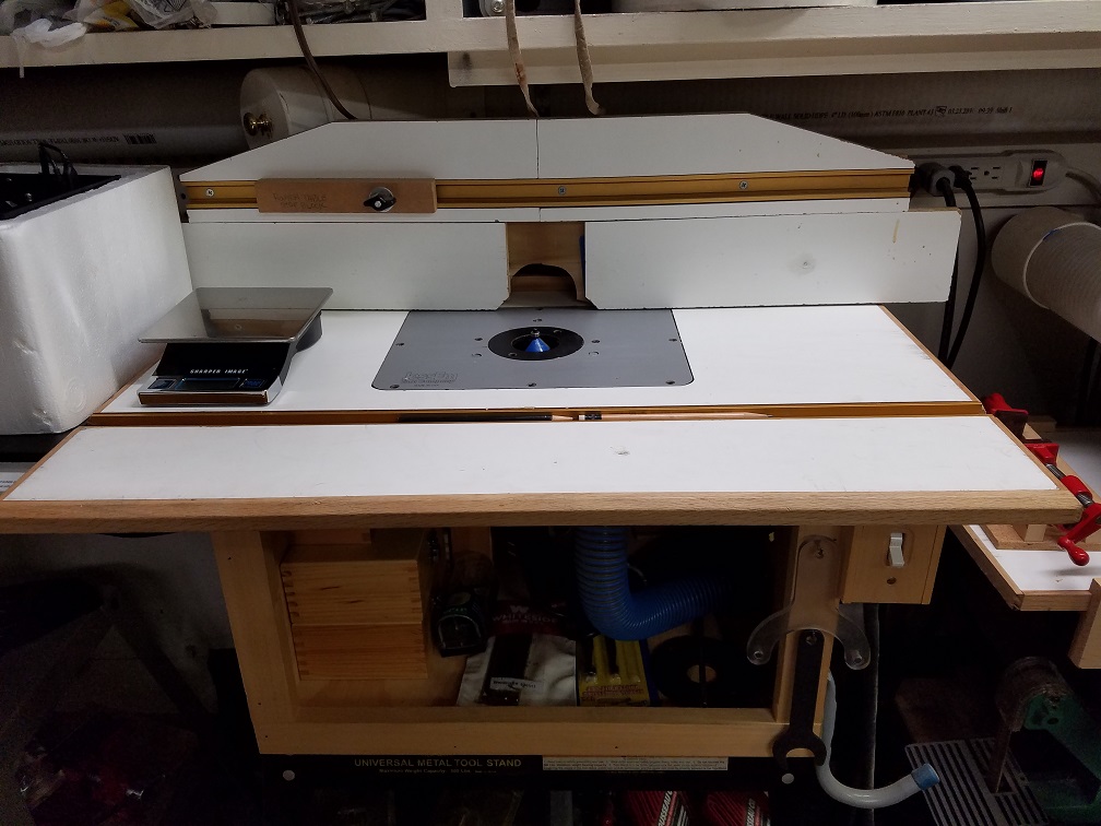

              I made a stand-alone router table with a tall fence that has adjustable cheeks (but really, who hasn't?)

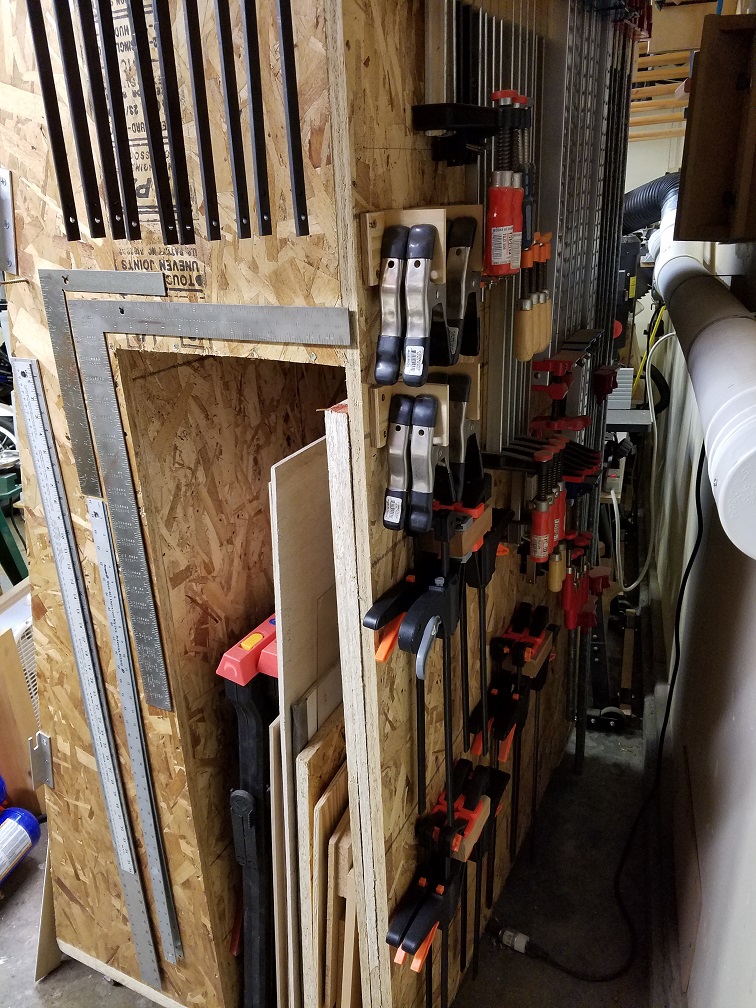

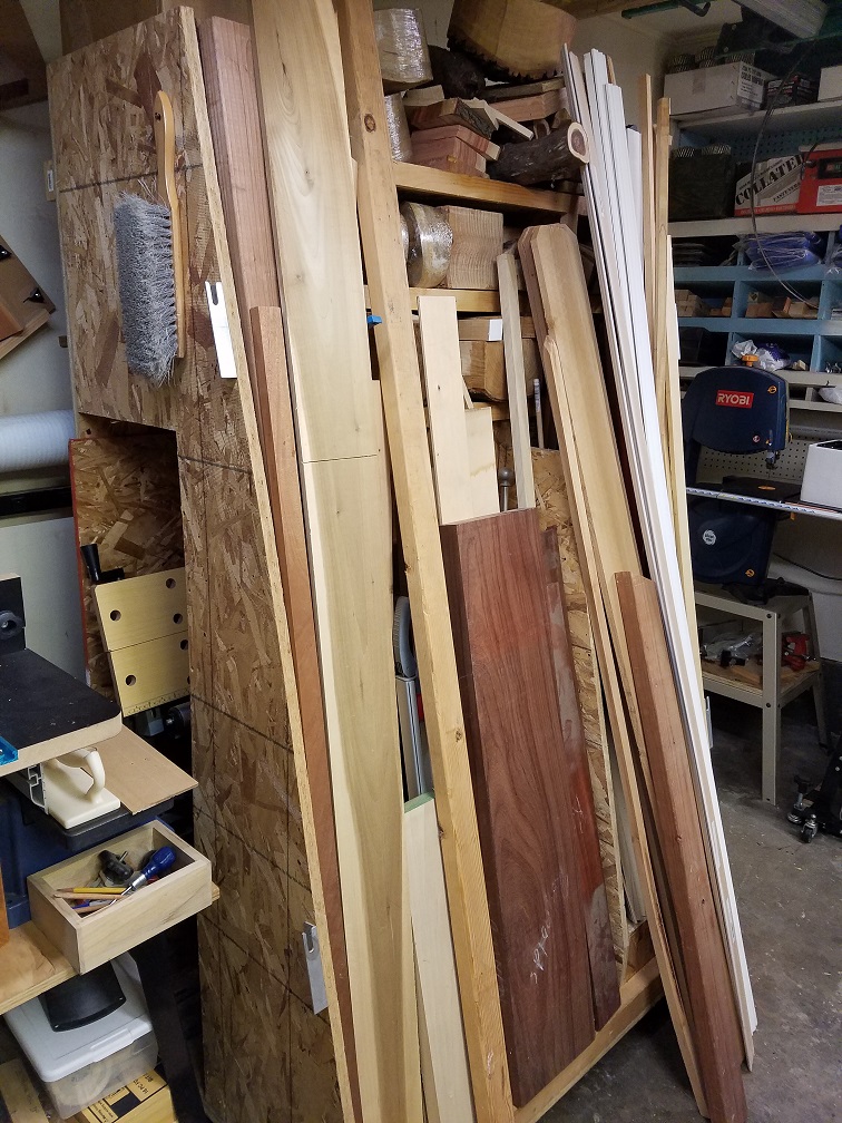

                I made a mobile lumber storage cart that can store half-sheets in a rearward area, boards/offcuts up front, and then I added clamp storage to the back.

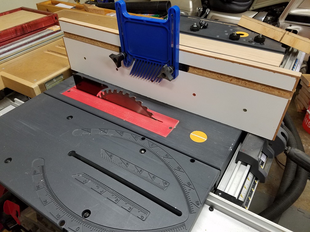

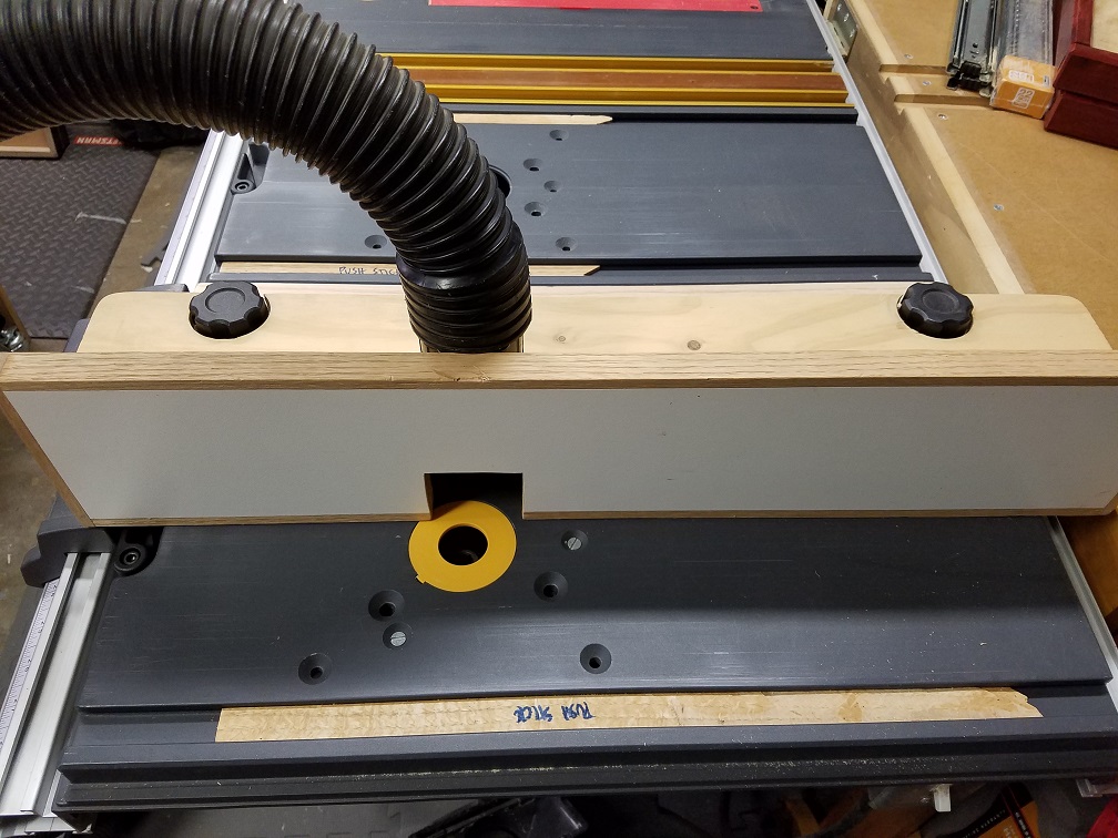

                  I made some fences for my 21829 (BT3 clone) - one is a tall fence for the saw, with slot for finger board, and the other is a simple router fence for the router side. Both mount onto the rip fence.

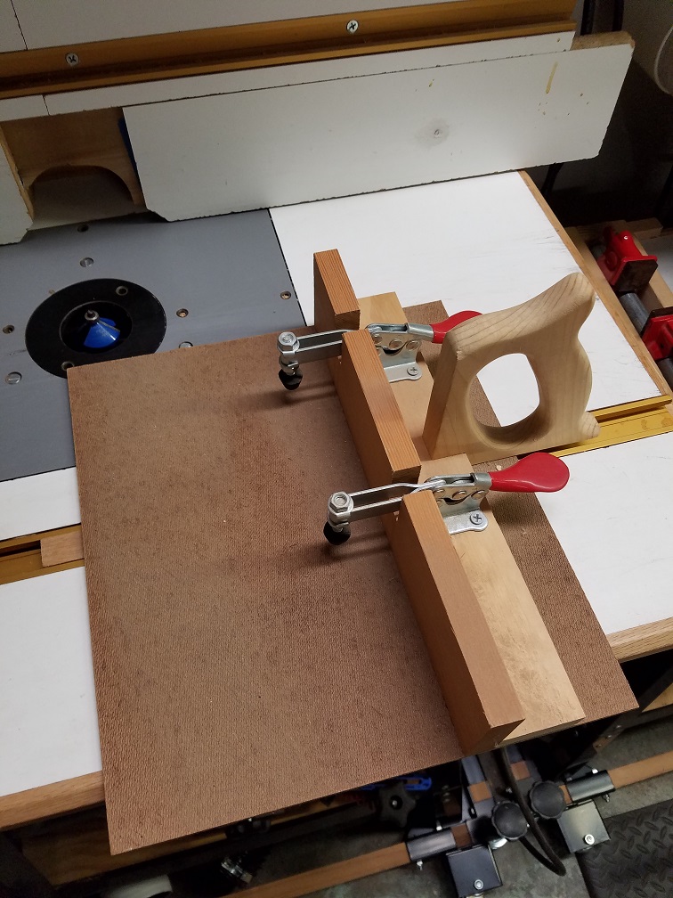

                    Here's a simple coping sled I made for my router table, I made this back when I built my first frame&panel blanket chest, still working fine.

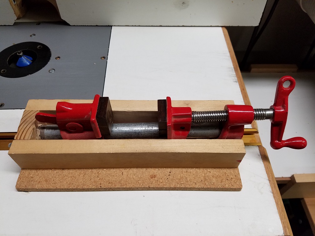

                      I made this "pen press" out of a pipe clamp embedded in a small frame, simple but effective. Has assembled hundreds of pens.

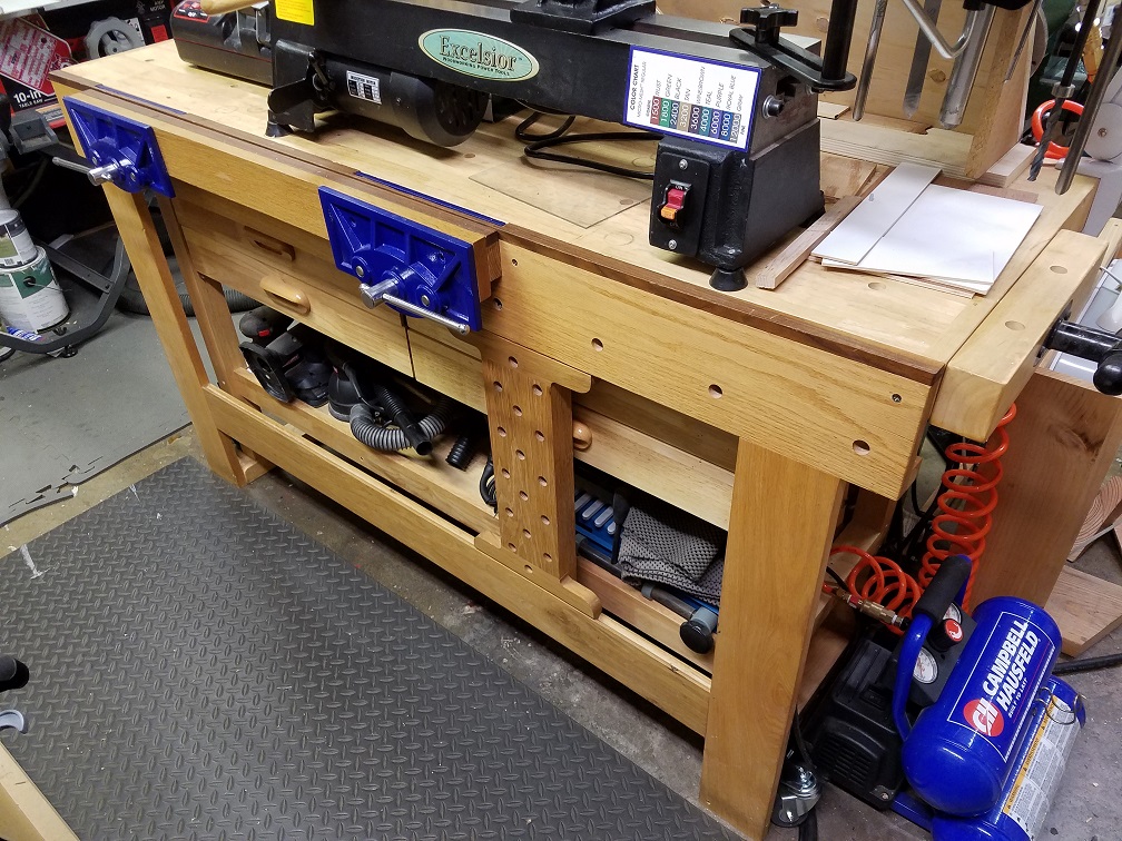

                        I wanted to add a face vise and sliding deadman to my HF workbench, so I built this frame to attach to the front to carry two wood vises that can be conjoined to work as one long face vise. (I had to lower the drawer assembly from its stock position in order to accommodate the vise hardware.)

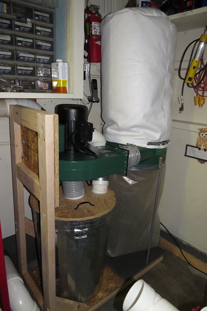

                          I made this frame on which to mount the components of my HF DC to a better airflow configuration. I also made the Thien baffle that sits on the trashcan separator.
                            [ATTACH=CONFIG]temp_22856_1470496955461_90[/ATTACH]
                            stay posted...technical difficulties with video upload
                            I look forward to seeing your pic/video as I have been searching for a good DC option of my DP.
                              LCHIEN commented
                              I have now uploaded the video as an attachment. You have to click on it to download it and likely open it to play it on your PC. Older version of Windows media player (win 7) won't play that version of MP4 but Win 10 Media player will. I use VLC media player it works for MP4 in all versions of windows.
