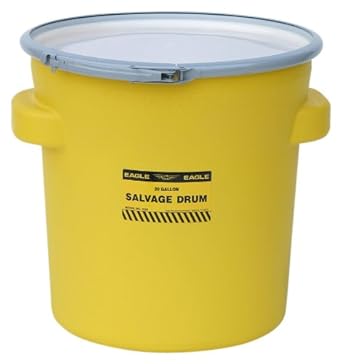

                Well, just ordered the Super Dust Deputy and one of these (20 gal) to catch the chips etc. It has a metal clasp for the lid although not quite sure what the lid itself is made from.
                I wonder if the top may need some reinforcement, what are others using for similar purposes? Also is anybody using a trash liner in the drum or does it cause issues when it doesnt have a bunch of chips weighing it down?
                  Jon, I haven't used a liner in my trash can separator for fear that it would get sucked up into the impeller of my HF DC. You should get decent small chip collection into your 20gal container, but beware the planer. I was planing 2x6 lumber over the weekend (about 224 lin ft), and taking 6 passes at ~1/32 each pass, had to empty my 35gal can about 3 times...
                  As for the top, I use the Phil Thien's baffle design, so my top is 5/8 plywood I believe, same for the baffle underneath, with foam weatherstripping to seal the top to the can. Weight is sufficient to hold it down and seal; DC does the rest of the sealing when running.

                    Is there any appreciable suction below the cyclone? If there were, wouldn't a bunch of fine dust be moving on to the filter? I use the smaller dust deputy connected to my shop vac to clean out the ash from my Big Green Egg. I don't notice any ash in the shopvac. Maybe toss a chunk of wood in the bottom of you're worried about it getting sucked up.
                    I think I saw in a magazine shop tip to use a coil of rebar wire mesh in the can to keep the bag in place and pushed against the sides of the can. When it's filled, you lift the wire mesh out.

                      Good to know Bill. Not sure how big the plastic bag is on my DC now (guess approx 20 gals) but when I am planing it sure does fill up quick. I don't recall ever having to empty it after one planer session but that is something to keep an eye on. Especially as my current plan is to have the DC outside the shop.
                        • 3770
                        There is suction upstream of the fan in the DC system, this includes the Thein or cyclone and any catch container under them. The lid on the trash can does not need to be fastened, suction will secure it for you. You can not physically get it off with the fan on! If it leaks you loose some efficiency, and it may whistle. Downstream of the fan, at the filter bag/cartridge and dust bag will be positive pressure.

                              I've seen a couple of DC's (e.g. Grizzly G0703) which have a small hose connected between the vacuum (cyclone) and the bottom of the dust collection can. I think it creates suction in the can to keep the liner stuck to the wall of the can, preventing it from being sucked up into the throat of the cyclone.
