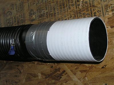

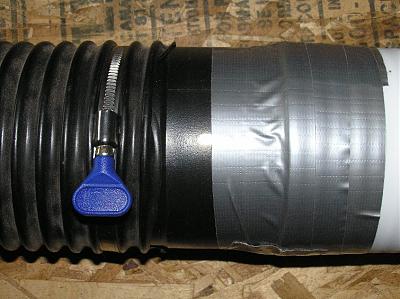

          Jon,
          I made some adapters with a connector, a hose clamp, duct tape, and a piece of the piping. I had to put slits in the piping to fit over the connector, which is why I needed the duct tape (as shown below). These have worked pretty well for the past few years, I occasionally have to tighten the hose clamps and I've only had to refresh the duct tape once.
            I found I could force 4 inch flex inside the coupling end of the 4 inch thin walled plastic pipe. It was a tight friction fit and I added some duct tape to it to seal. It worked well on the jointer but I kicked it too often on the table saw and it would come apart and be a pain. But if you can arrange things where it isn't getting stepped on or otherwise messed with, this will work.

              Yup I have tried that in the past and had the same experience. Rockler and woodcraft seem to have what looks like the same fittings that claim to make this transition. as I am lucky to have a rockler 2 miles from my house I will check out what they have. At least its not too far to go if I have to take it back :-)
