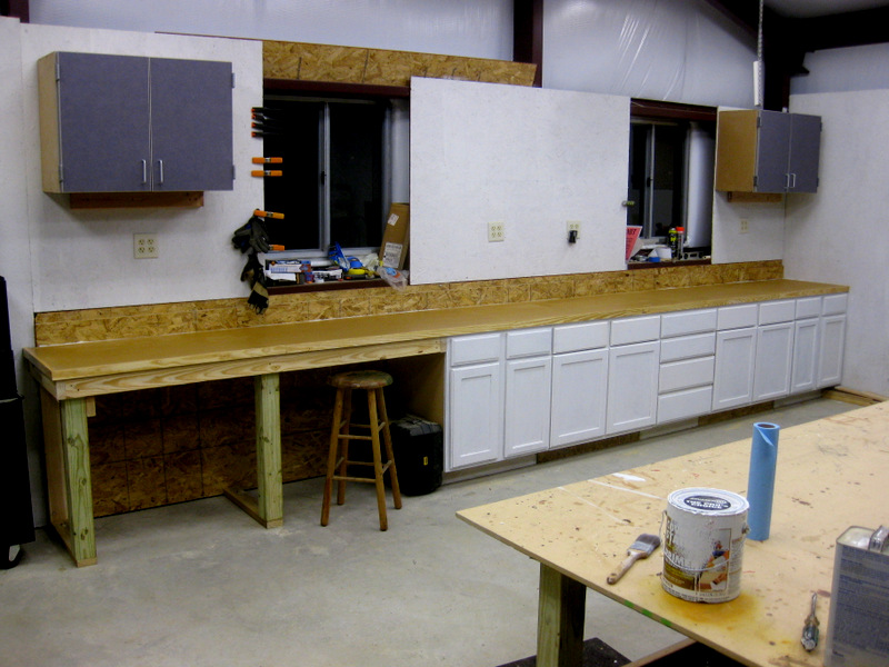

                Pretty much complete with the addition of counter top and cabinets ...
                Well it's been a long haul but other than a few "todo" items like getting the DC like I want it ... the shop is mostly complete and fully functional ...
                I finished the countertop and cabinets this evening ... first time I ever built cabinets ... can't say I liked the chore and I definitely don't like painting them!!
                The cabinets above the counter top were purchased along with a couple of others not pictured on craigslist for $25/each ...
                The counter top is a double layer of 3/4" MDF sealed with polyurethane (which it turns out I AM old enough to purchase ... ) ... I'll add another pegboard over the middle (there are already two 4x8 PBs not pictured)... counter top is 19.5' long and 24" deep ... very comfortable to work at.
                I'm REALLY glad to have the cabinets and counter top finished ... it was getting very tiresome having things scattered between two shops and all over the floor...
