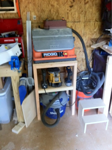

                  Right now I'm working on that dust separator/planer stand and hoping I can cut a 4.5"d circle without having to go buy an expensive hole saw.

                          Fortunately for me, Rockler included a bit of wiggle room in their fittings by incorporating a wide flange. A forstner bit, my router and my jigsaw appears to have gotten the job done.
                          I hope this works as well as I hope it does, my bucket separator already is in permanent implosion mode with my shop vac. This has 4" ports and two drawers, for collection.
