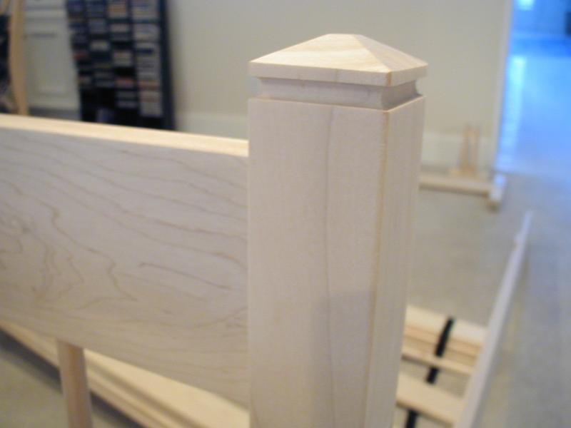

    I made a full size bed frame. I used 2x2 for the corner posts, 1x6 for the rails (3/4" thickness is just enough to hide the 5/8" hardware) and 1x6 fir the cross members in the head and footboards.
    It was plenty strong. I think 2x6 on edge will hold an elephant! Seriously!
    For Slats I think I used 1x3 or 1x4, rounded over 3/8" with 50% coverage... Screwed subrails to the rails and then put 2 permanent blocks head end (spliting the 1st two slats) and 2 permanent blocks foot end to split the last two slats. Placed the rest of the slats using temporary spacers then stapled 2 nylon strap to the slats to keep them from sliding around.

    The only comment I have is that rolling up a full beds worth of slats is very heavy and hard to handle! If I was to do it again, I would make two sets of slats rather than one large one.

    see attached pictures
