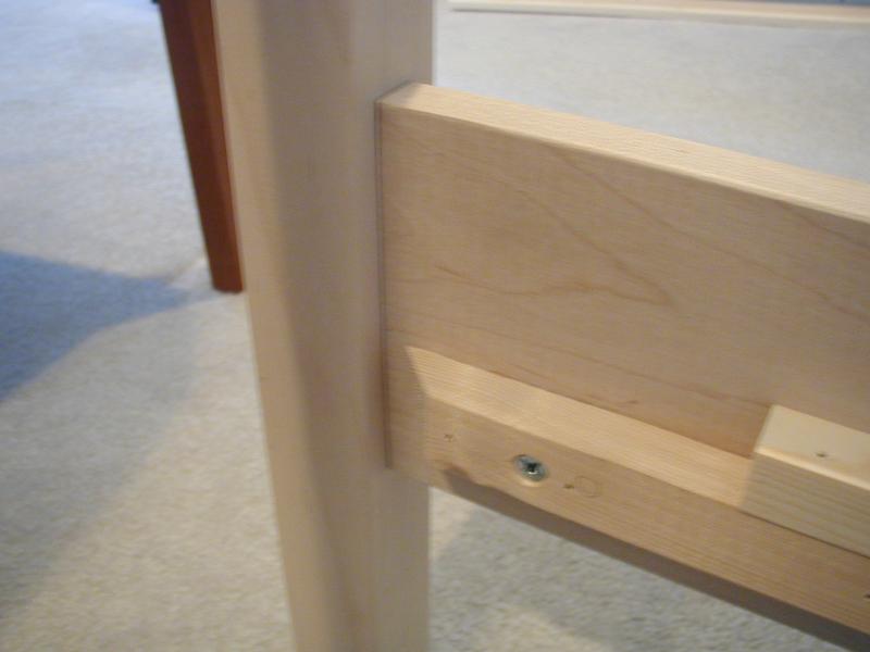

              To help hold the screws in the end grain, I put some dowels through the bed rail so that the screws holding the bed rail clips actually have some cross-grain hardwood to thread into for a better grip. These are blind holes, so only visible from the mattress side when the bed is assembled

                Simply... that will work fine as it serves the same purpose as the larger hard-wood plugs I use with an exception. You are still screwing into end grain by using a dowel but.. the use of a hardwood dowel will give much better bite than soft-wood. If you have driven screws into both hardwood and softwood you know that. The long grain of the dowel is glued to long grain on the rail so absolutely no problem there.
                I have never built a child's bed yet but.. I think the dowel idea will be fine. I personally prefer the plug on a larger bed evem though I only use hard-wood to build adult beds. For that matter for the weight you have to hold.. the original idea of the external fasteners with screws would probably be fine for a child's bed. So.. that option is still available and if you decide to use it.. I would just add some additional holes on the brackets to attach a few more screws per bracket to add some additional holding strenght.
                No reason to over-think this with a young child's bed IMO...

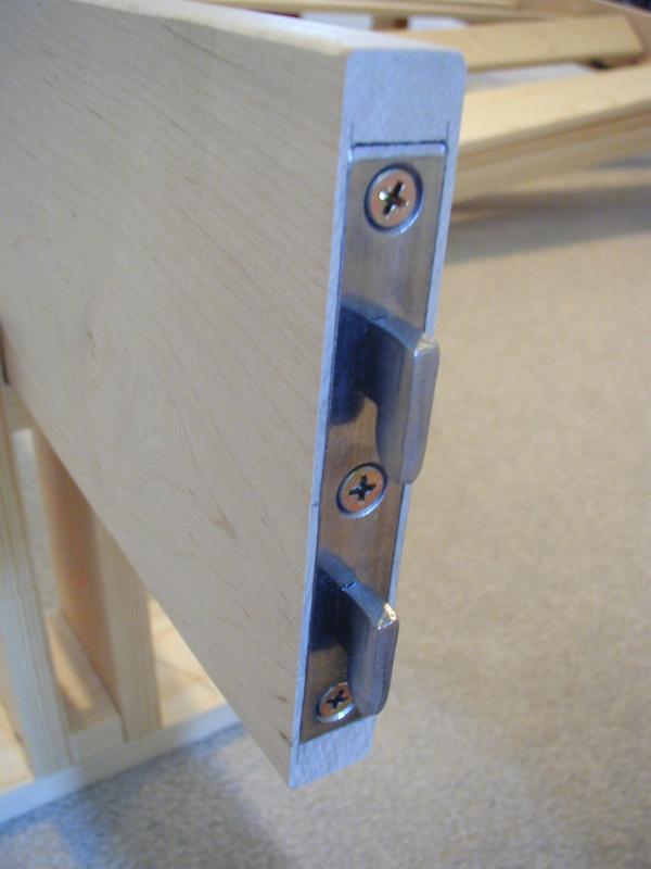

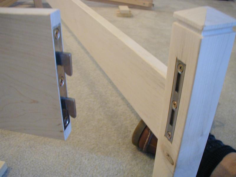

                                I used those brackets from Rockler to make a bed for my daughter. Worked great. No-show, its the most elegant solution. I made a tweakable routing template with a side frame that I could clamp to the end of the rails. Practice with two pieces of scrap, four ends, in full dress rehearsal before doing the real ones. Remember you'll have to hold the router sideways to route due to the length of the rails but it worked perfectly. Used Maple. Pictures below.
                                Hint: When I got them, before installation, the connectors took some force to get mated with each other, then even harder to get apart being there's nothing to hold onto to. I used a file gently until they slid into each other with just a hint of friction and no slop. Now if you lift by the rail the headboard/footboard will come with it but bang gently on the footboard downwards it will fall off, when trying to disassemble. Normally of course, the weight on the rails holds everything locked together. Its now survived six or seven moves and re-assemblies and is still very solid. You can see in one pic there's a support I made to go under the rail to lift it and support it when disassembling.
                                IIRC, these are the 4" rail brackets on 1x6 maple (5.5" x 13/16ths) - should be fine for a twin or fullsize.
