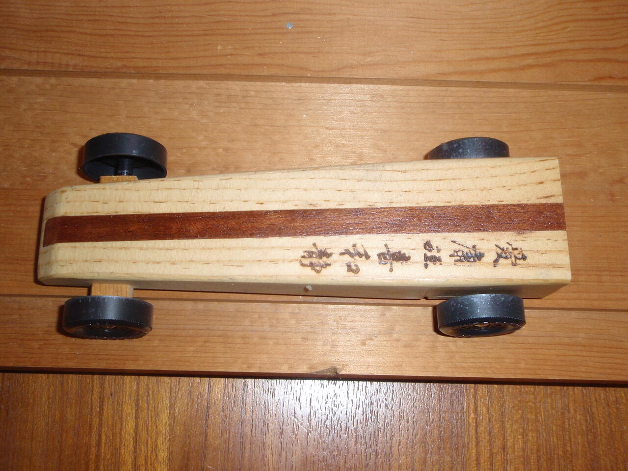

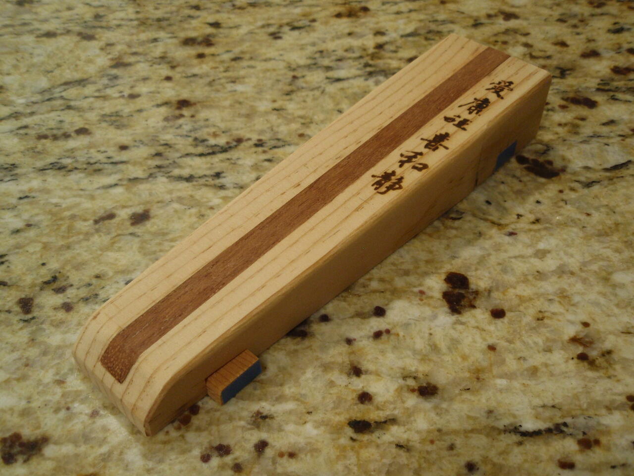

      Click image for larger version  Name:	unnamed.jpg Views:	0 Size:	246.2 KB ID:	853687 Click image for larger version  Name:	unnamed (1).jpg Views:	0 Size:	220.2 KB ID:	853686
      Click image for larger version  Name:	P1191153.jpg Views:	0 Size:	138.9 KB ID:	853688 Click image for larger version  Name:	P1191152.jpg Views:	0 Size:	149.9 KB ID:	853690
      Tapered bodies this year challenging cut. Both practically the same shape.
      I did mine on the taper jig and BT3 no blade guard 2.9 degree cut both sides VERY HAIRY.
      Decided I did not want to do his that way.
      We actually did my Grandsons on the bandsaw and cleaned it up on the belt sander. He did the cut with me helping guide some; he did the belt sanding. I had to touch it up a little at the end.

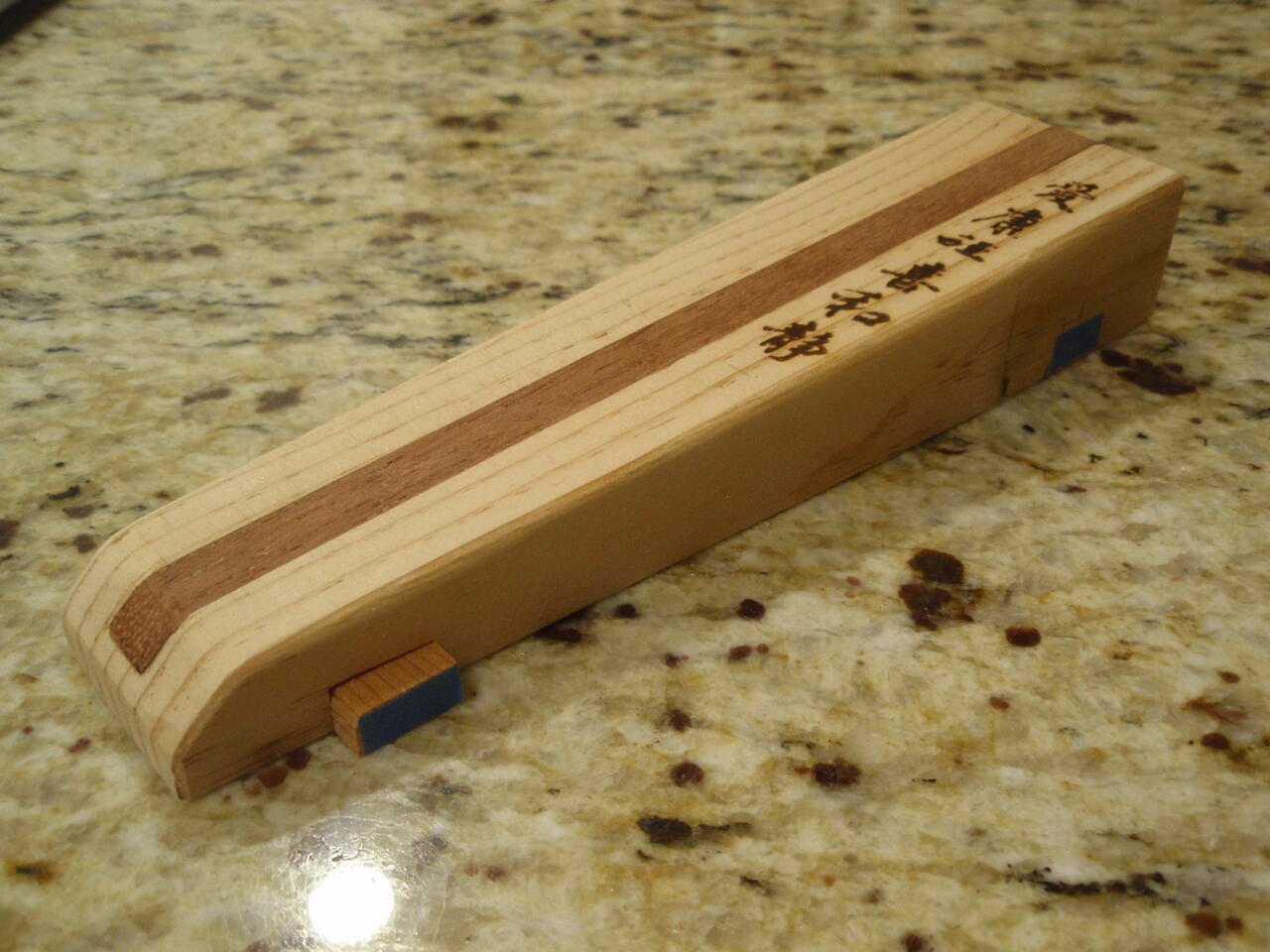

      Lasered mine with Chinese characters for Happiness, Health, Wealth, prosperity, luck etc. being that it is Chinese New Year this week. Is an Mahogany hardwood inlay worth any points?

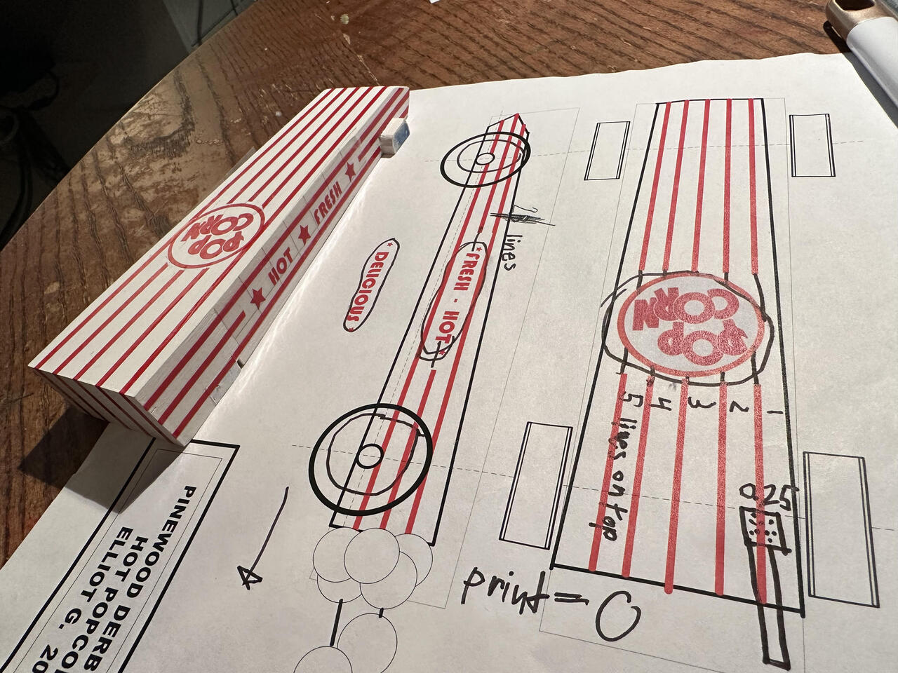

      His mom helped him paint and made stencil for his. The drawing I made according to the description he gave me, although I suggested the taper dimensions. Still some decorations to do when he gets back here.

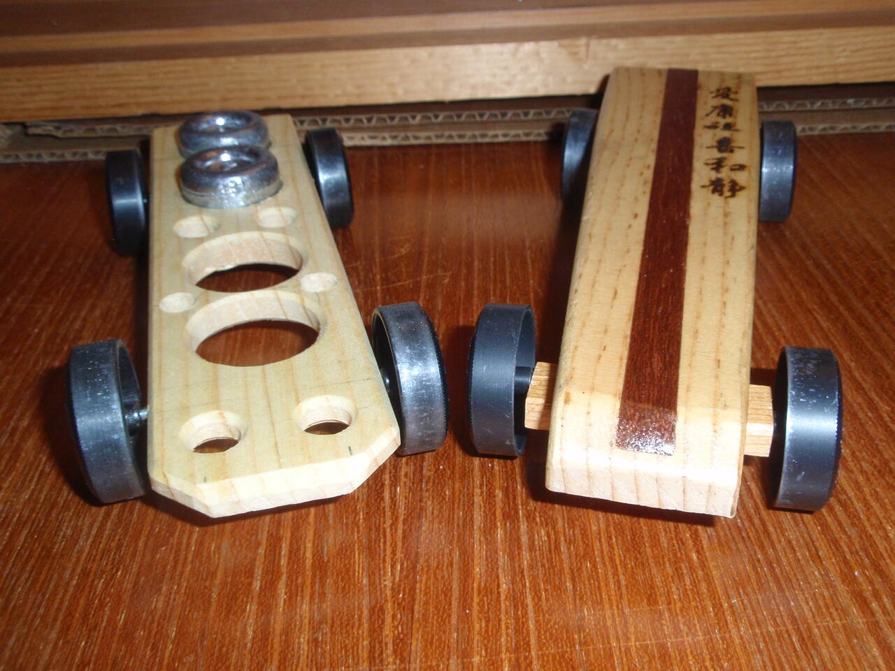

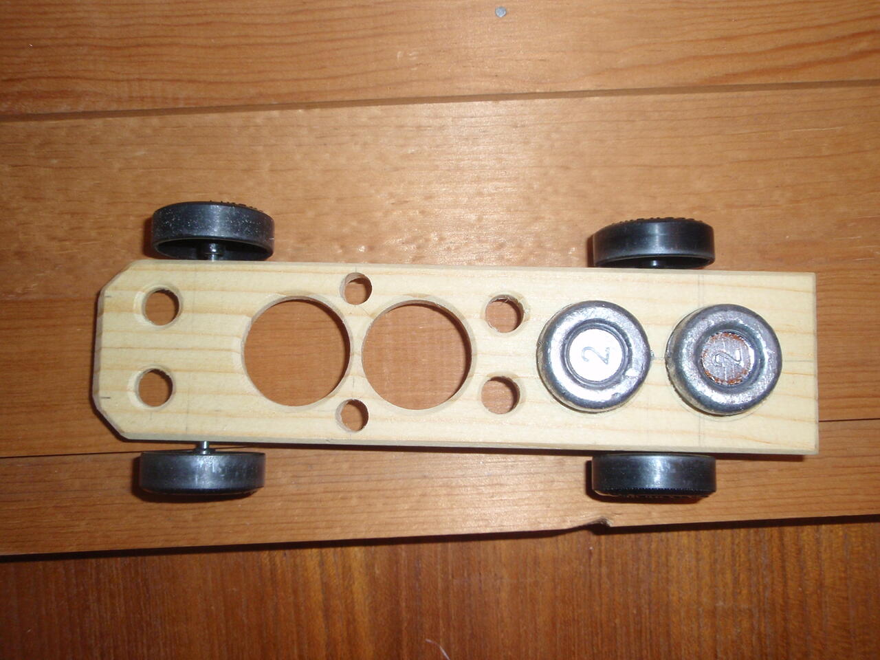

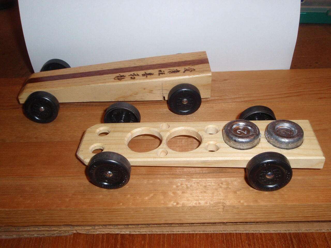

      I figured out how to take out precise amounts of weight by drilling away at the body underside based on computed density.

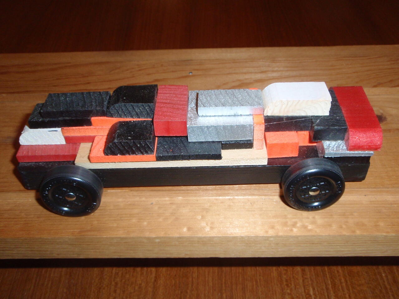

        I know it is called pinewood derby, but is the building materials limited to wood? Reason I asked was yrs. when slot cars were the rage they built some car bodies out of paper mache. Lots of fun and endless possibilities.

            Doesn’t make much sense to remove one material and replace it with another if doesn’t provide any benefits. The paper mache was fun to work with and could be molded from existing car and truck models.

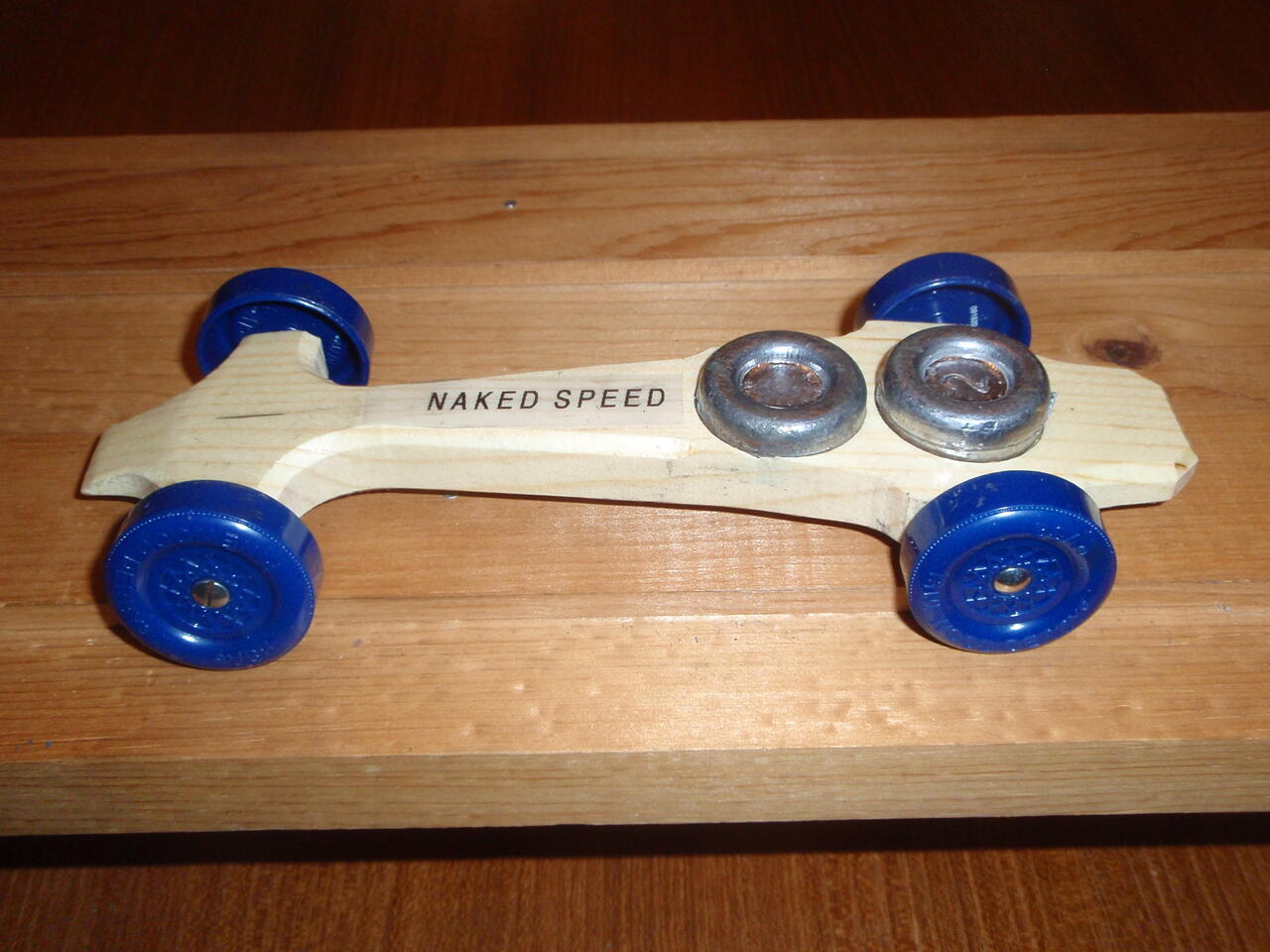

            The last car started out with 3.9 oz block of wood cut down to .9 oz. and skeletonized to less than 0.7 oz, and added 3.8 oz of lead weights and 0.5 oz of wheels. Some people make recesses in the bottom of the car and pour molten lead in them.

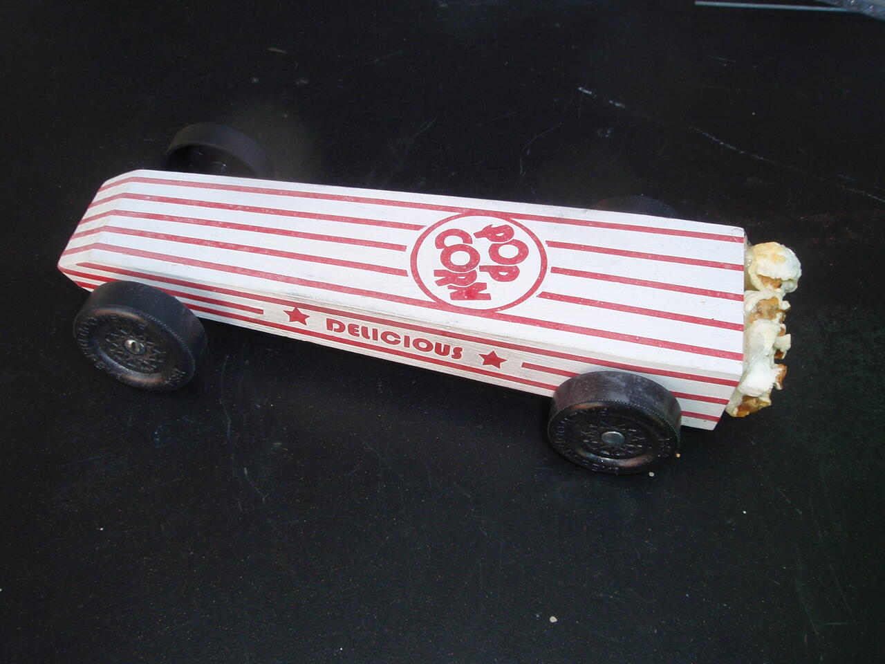

          Meet "Shanghai'd" and "Swiss Cheese".
          It says Health wealth Love happiness Serenity and Harmony
          Click image for larger version  Name:	P1251157.jpg Views:	0 Size:	174.5 KB ID:	853723 Click image for larger version  Name:	P1251150.jpg Views:	0 Size:	145.2 KB ID:	853724 Click image for larger version  Name:	P1261146.jpg Views:	0 Size:	167.1 KB ID:	853725 Click image for larger version  Name:	P1261150.jpg Views:	0 Size:	132.9 KB ID:	853726
          Entering these in the adult/family division.
          Grandson's finished car? Sent him home and forget to take pic. Will get one.

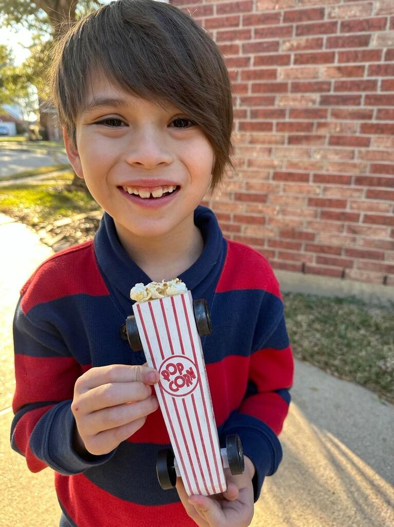

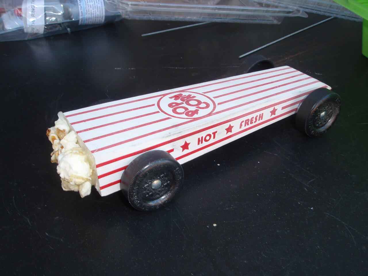

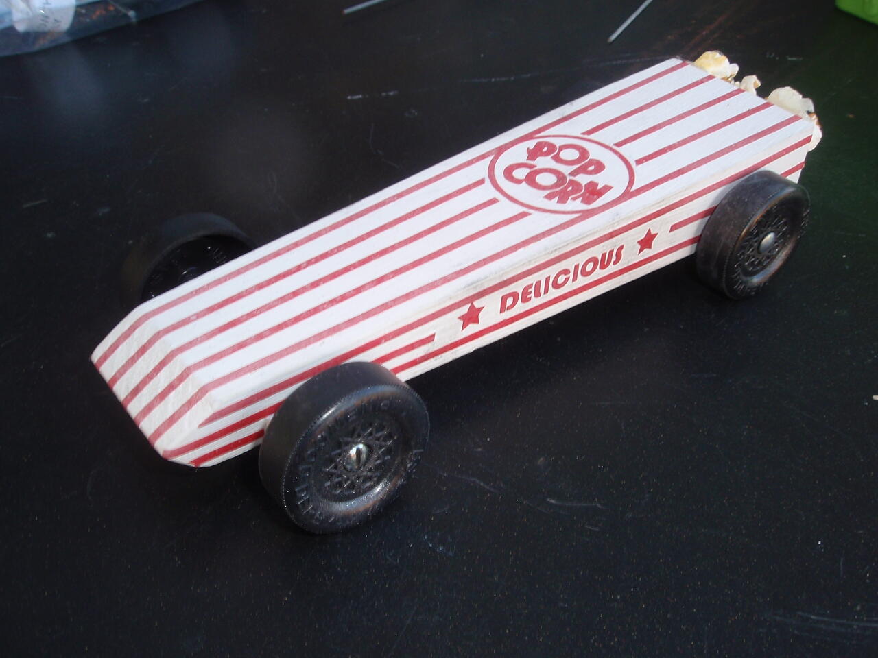

            Grandson's car: Blazing Popcorn
            Click image for larger version  Name:	P1261158.jpg Views:	0 Size:	112.6 KB ID:	853739 Click image for larger version  Name:	P1261156.jpg Views:	0 Size:	118.0 KB ID:	853738 Click image for larger version  Name:	P1261160.jpg Views:	0 Size:	118.2 KB ID:	853740
            Click image for larger version  Name:	image.png Views:	0 Size:	688.8 KB ID:	853741

              The Grandson won a trophy for 2nd place in speed, and an award for design " The car that was most not like a car for his Blazing Popcorn"

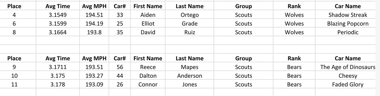

                      The awards were based on average time - best 5 of 6 runs.
                      My grandson's car best 5 were 194 to 196 scale MPH, taking 7" car scaled to a 17+ foot average car.
                      I think the very best all came out to within a MPH of 195 or 196.
                      In terms of times the track was 42 feet long; my GS car ran 3.137 to 3.186 seconds. The winning cars ran 3.11 to 3.14 seconds best times. The timer had a resolution of .0001 second.
                      My 2 cars ran a disappointing 3.16 to 3.19 seconds.
                      They told me I can't run 2 cars next year (even though I put on e under my daughters name, I think they knew). The holey one I only started on it at Noon Wednesday and finished by midnight... I wanted to try they theory of really light on the front end but it didn't seem to help any.
                      FWIW here are the official results for his age group
ID:	853788​​ So he missed 1st place by 5 milliseconds, that is 0.005 seconds.but he beat out third place by 5 milliseconds as well!
                      Here were the top winners in all ages groups times
