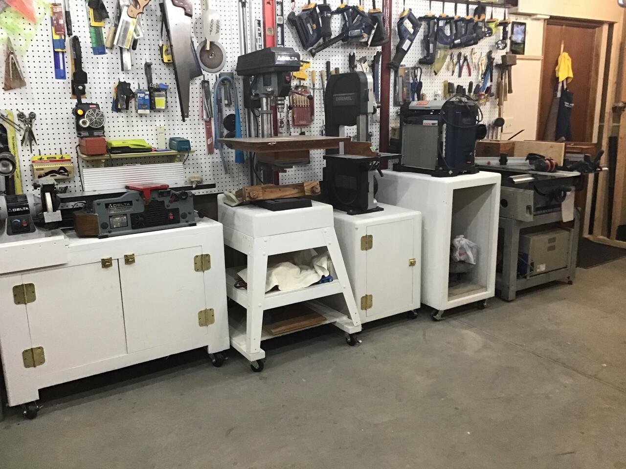

    This? It's based on the stand from my BT3100. The two shelves hold various DP tools including the mortising table.

      The angled sided stand looks good, but in a practical sense it would be of more use if it was straight sided like the other cabinets so it could accommodate wider drawers. It wouldn’t be much more room but probably enough in te drawers for a couple more drills or a couple of drill sets. Then you would have the flat top where you could pile all manner of clutter!
      dbhost
      commented
      I am thinking more along the lines of the stand your planer is on, but shorter. WIth 2 open shelves and a drawer. The open shelves to keep the drills in their cases, the drawer for the drill bit sets, forstner bit sets, and the one corded drill I have that does not have a case of any kind... Never was a fan of angled leg stands. They splay out nicely for a wider more stable footprint, but kind of ruin storage opportunities in them...
    • Jim Frye
      Jim Frye commented
      FWIW, the cabinets are constructed of cast off 2by pieces from home building on the street. Everything is joined with biscuits. Doors are pieces of scrap 3/4" plywood.

      While off topic from the OP, I can see two things great about your shop: 1. Color of stands, cabinets etc - White reflects light well and increases visibility around the room, 2. lights - great lights!
      • Jim Frye
        Jim Frye commented
        The shop lights are 17, 70 watt equivalent, daylight, LED screw in bulbs arranged in three rows the length of the shop. It was a cheap set up also. $78 for the boxes, bases, and bulbs. Total current draw is 170 watts. Not sure what the wire cost as a bunch of it was leftovers. The shop also has four 75 watt incandescent aimable floods for color matching and to provide raking light for finishing, but they weren't on in the picture. One of these days, I plan to paint the walls white also.
      • Jim Frye
        Jim Frye commented
        SWMBO complains the shop looks like the Vegas strip, it's so bright.

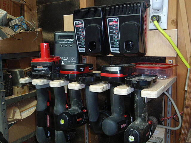

            My chargers sit on a shelf on the pegboard wall (see the above picture). Batteries are kept in a bin on the shelving unit on the opposite wall of the shop. Cordless tools hang from hangers off of the beam above the pegboard. Of course no other tool maker did cordless tool hangers except Ryobi.
            Jim Frye
            The Nut in the Cellar.
              My cordless tool holder, I like to keep it simple.
              Click image for larger version  Name:	PB201151.jpg Views:	0 Size:	161.5 KB ID:	853000
              Just a shelf sitting on some adjustable shelf brackets 16" (Stud width) apart. Spaced for C3 tools.
              Click image for larger version  Name:	image.png Views:	0 Size:	14.6 KB ID:	853002​
