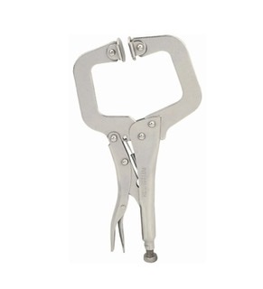

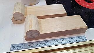

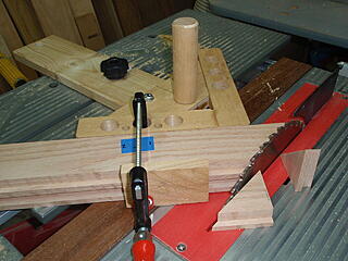

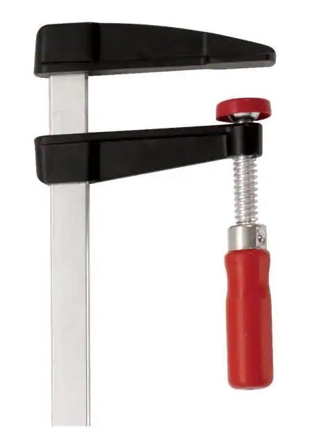

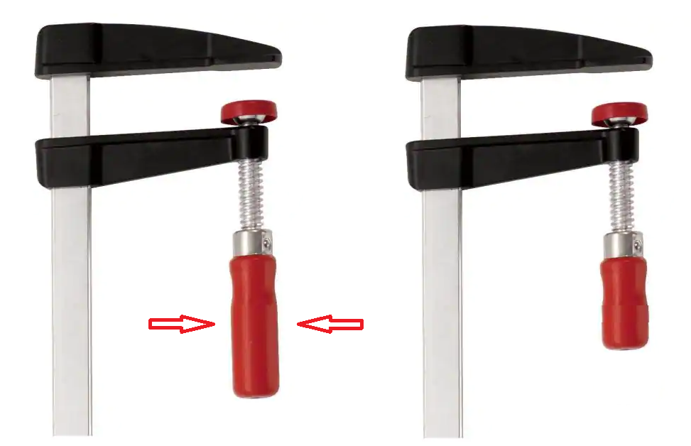

    So I need a clamp with a shorter handle to clear the blade.
    OK who knows how to figure how far into the wood handle does the screw go? In other words how much of the handle can I easily cut off?
    Bessey LM2-004
    Click image for larger version  Name:	bessey LM2-004 clamp.JPG Views:	0 Size:	15.2 KB ID:	849108
Name:	bessyclamp short handle.png

      • 3773
      Drill into the butt end of the handle with a long small dia bit. When’d you hit hard stuff you know.
        LCHIEN commented

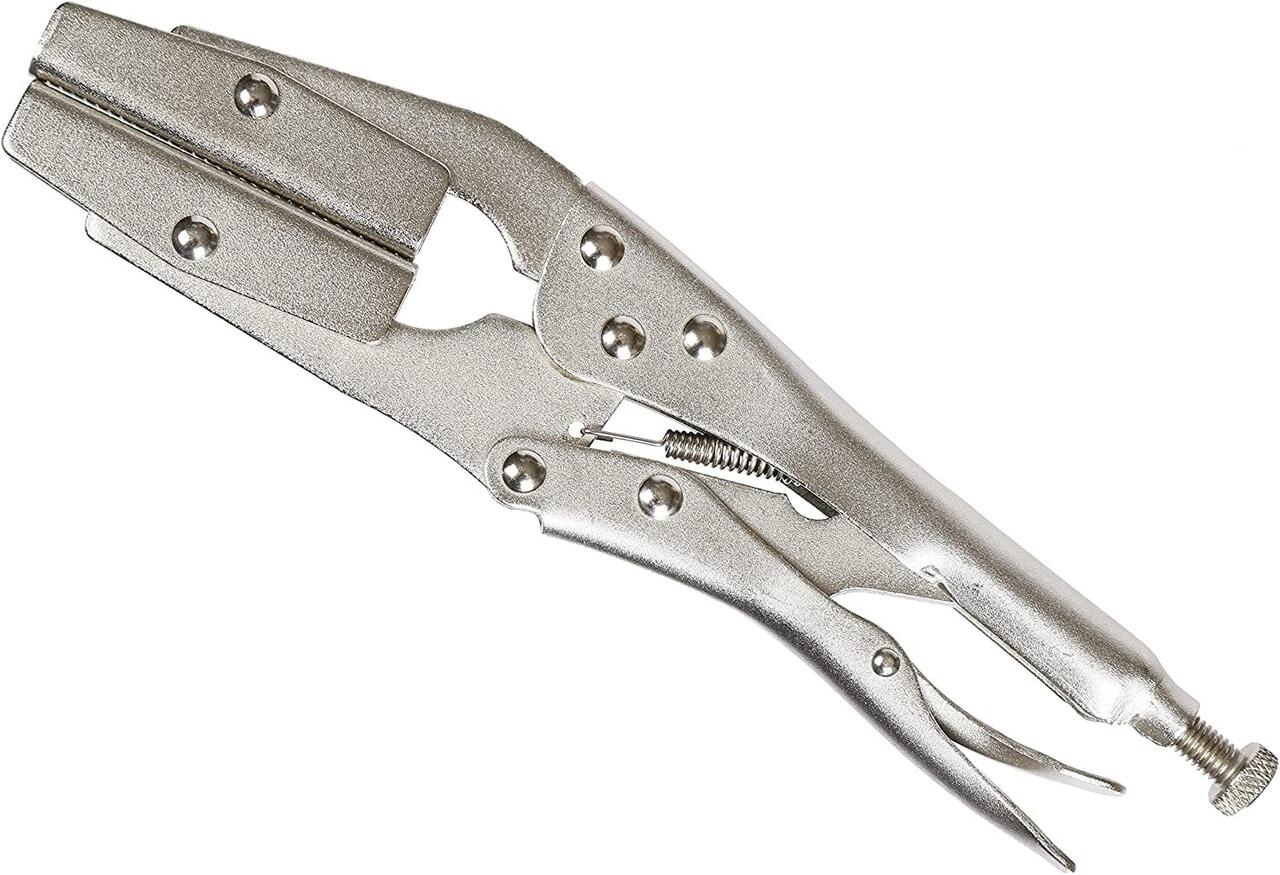

      Look at this style clamp for this application. I use it quite a bit when I don’t have room for a f or bar clamp. It has round articulating metal thingys on the end that will scar up you wood, but some of the soft clamp thingy covers fix that right up. It doesn’t intrude into the blade space quite as bad as an f clamp.

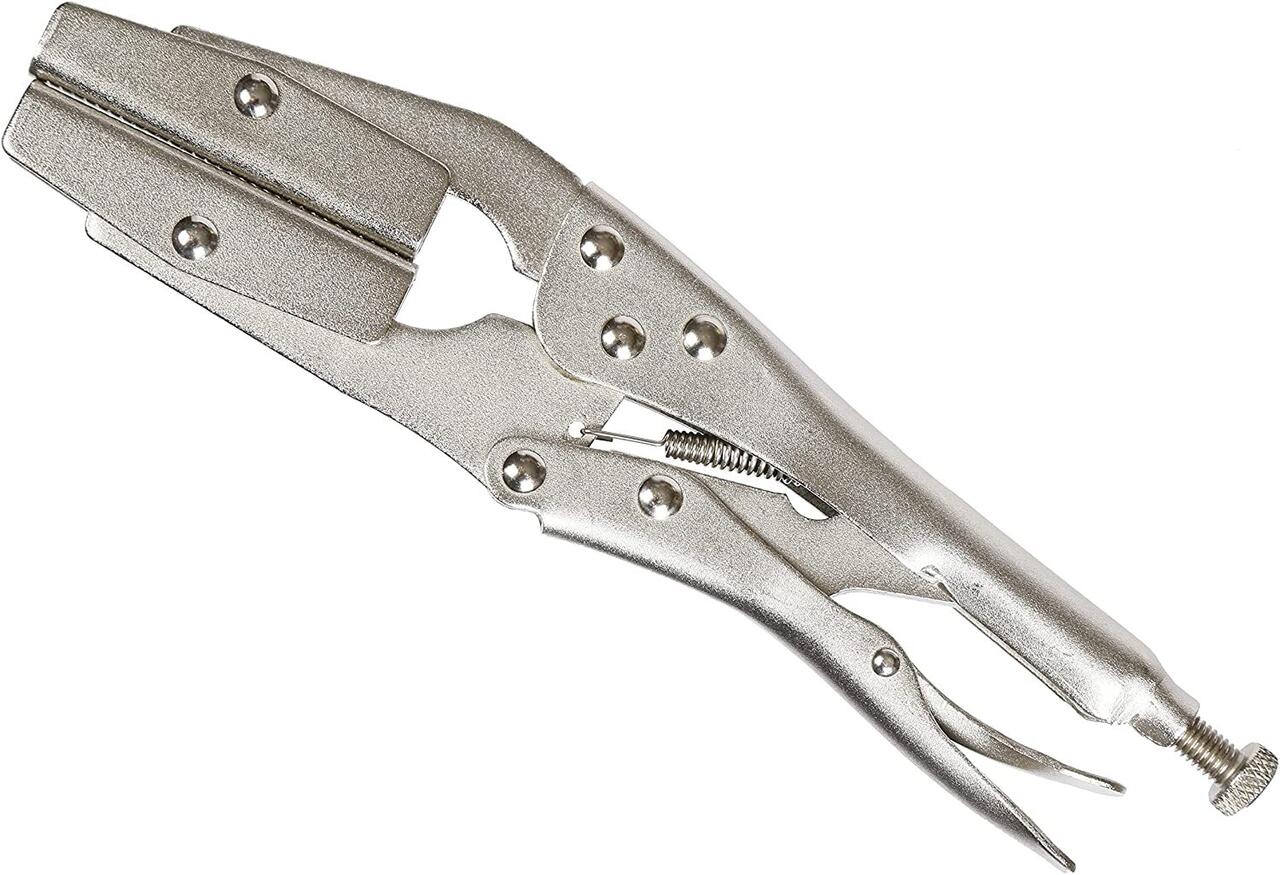

      if it intrudes too much into the blade space just saw off most of the c and fabricate a protector out of wood that the nub fits into.
      There is quite a variety of this kind of vice clamp that works really well for woodworking. I have 2 on my miter saw that fit in the 80-20 extrusion mounted behind of the fence, and I have several in the same type extrusion on my workbench. There are also very simular clamps that fit in the t track on drill presses and saws.
        LCHIEN commented
        Now that is really intriguing except that the HF versions of this clamp say out of stock until Dec 9. Uh seriously, 9 months???!!!
        I think this might be neat if I cut off on the jaw protrusions.

        Harbor freight is not the only source of vice grip c lamps. I think I have seen them at Lowes. Northern tool has a big assortment of them and Amazon and EBay also has them. Caution, the jaw size means something to someone somewhere, but I’m not sure what it means. The largest size I have has swivel pads and will probably grip 4”, the smallest with swivel pads I use to clamp the flat table on the band saw will barely grip 1”, so read the product description before you purchase it! The pictures all look the same.

      How about the 4" version of this?
      Maybe some self-adhesive sandpaper on the 45's to prevent sliding, too?
        LCHIEN commented
        I've been thinking about gluing some sandpaper to the front(s) because hitting the blade at an angle tends to want to pull it off a bit.
        And I've been toying with how I could use these clamps. I have them in all sizes from 2 inches to 12 inches. Maybe turn the nose of one side to a round tenon to fit the holes in my 90 fences?

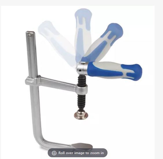

        • 22044
        #23
        This one has folding handles that will get out of the way, too.
Name:	flex handle clamp.JPG

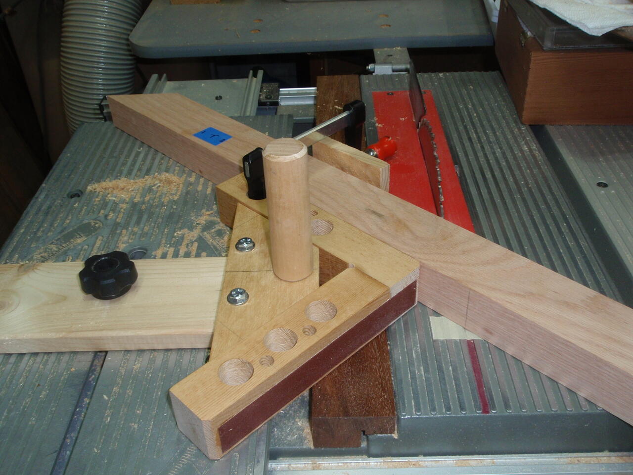

        It might be overkill, but have you thought about routing a slot (or building one up with thin material) that the SMT clamp could ride in? That way it'd pull in to the fixture and there's nothing hanging off
          LCHIEN commented
          Capn', you are correct that the jig is held in position by the two dowels pegged into the pivot holes. and captured by the knob and bolt in the center slot.
          An you are right that the downside of downward clamping from the 45 square fence is that it pushes against the saw table and not against the SMT base as the Ryobi miter clamp does. The SMT is limited, though in upwards travel by the slides.
          So I Have to think about it some more.

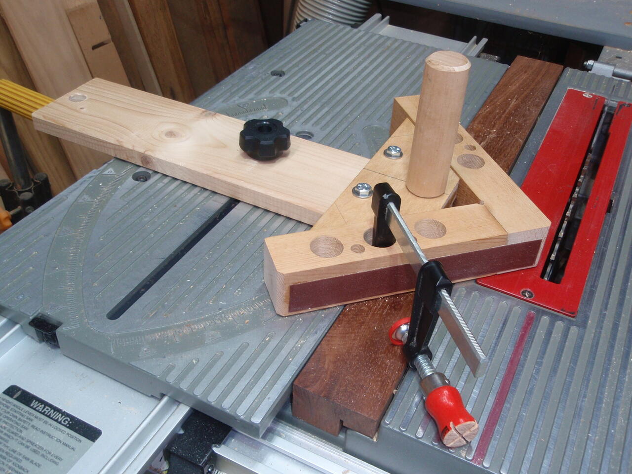

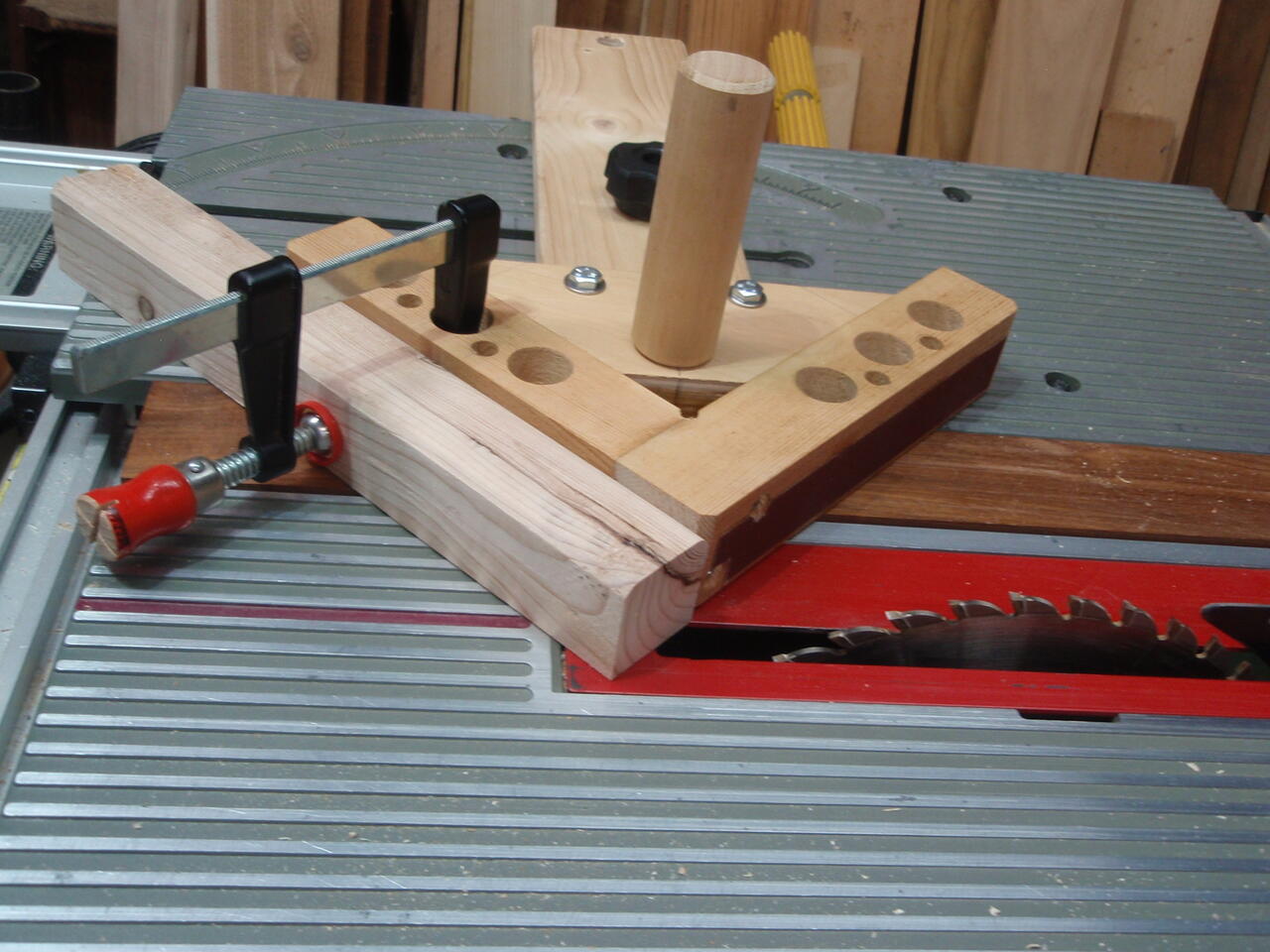

        Thanks for everyone's input and suggestions.

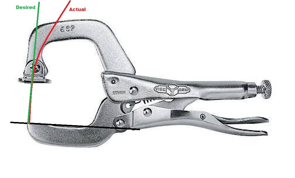

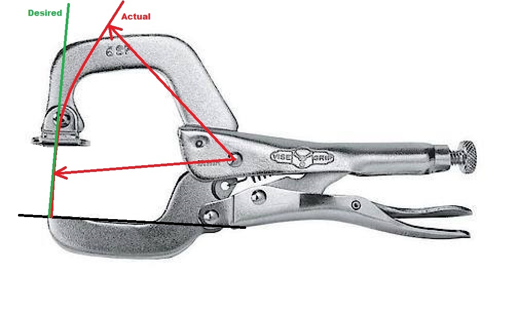

        After quite a bit of tracking down and buying a locking clamp of 6" I pretty much decided it won't work, although I had high hopes. The jaw opening was too limited and the jaw angles would not have been right after doing some modifications. Among other things as the jaw opened the clamping point swings in an arc (as opposed to in and out in a line) and when widest would have been too high for thin pieces. I was not looking forward to hacksawing the Cr-V jaws either.
        Click image for larger version  Name:	modified locking clamp3.jpg Views:	15 Size:	94.8 KB ID:	849398
        (OK, I just realized I drew it reversed with the wrong movable jaw but I'm not going to redraw it.)
        I looked at 4", 6" and 11" locking clamps physically in my hand at the jig and none really fit the bill even with modification.

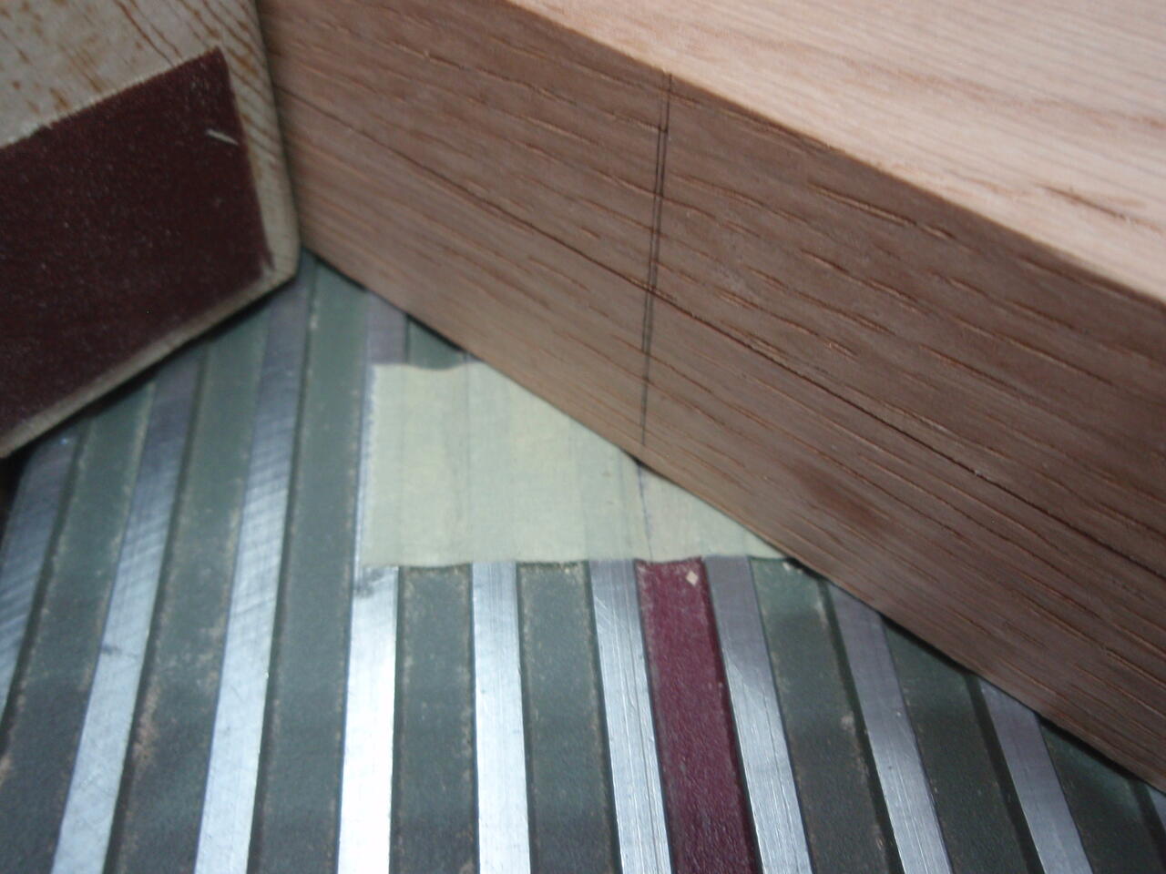

        I finally cut down a F-clamp and also glued some sandpaper on the fence faces. And drilled a hanging hole. Slotted the new end of the clamp so I could do a screwdriver assisted tightening if needed with the short handle. With the 4" F-clamp I can clamp 3-1/2" wide workpiece.
        Click image for larger version  Name:	P3200934.jpg Views:	0 Size:	145.3 KB ID:	849395 Click image for larger version  Name:	P3200937.jpg Views:	0 Size:	169.3 KB ID:	849396
        Somewhere soon I need to make a frame and see how this works.

          leehljp commented
          I still think a modified vise grip pliers would do well; just don't cut the wrong arm off!
          LCHIEN commented
          I looked at it for a really long time. One arm is fixed to the handle and the other arm pivots around its pivot point. But regardless the travel is an arc and not a line.
          I would have cut off the tip on the fixed arm so that the handle would stay motionless and in fixed relation to the fence as the movable arm moved to clamp the workpiece. But alas the movement is an arc rather than linearly in and out meaning I can't clamp thin stuff If I cut off the pivot and go to a simple straight jaw. That's why you only see these wide arm locking pliers with point ends or swivel ends, no flat ends, to accommodate the arc.

        Regd. holding the pieces against the miter fences - how about gluing some 120 grit sandpaper strips on both faces? I have glued this on my sacrificial miter fence and they provide excellent holding without any sliding movement.
        Just my $0.02
        NG
          LCHIEN commented
          Thanks. Sandpaper face Already done - look at post no. 25 in this thread.

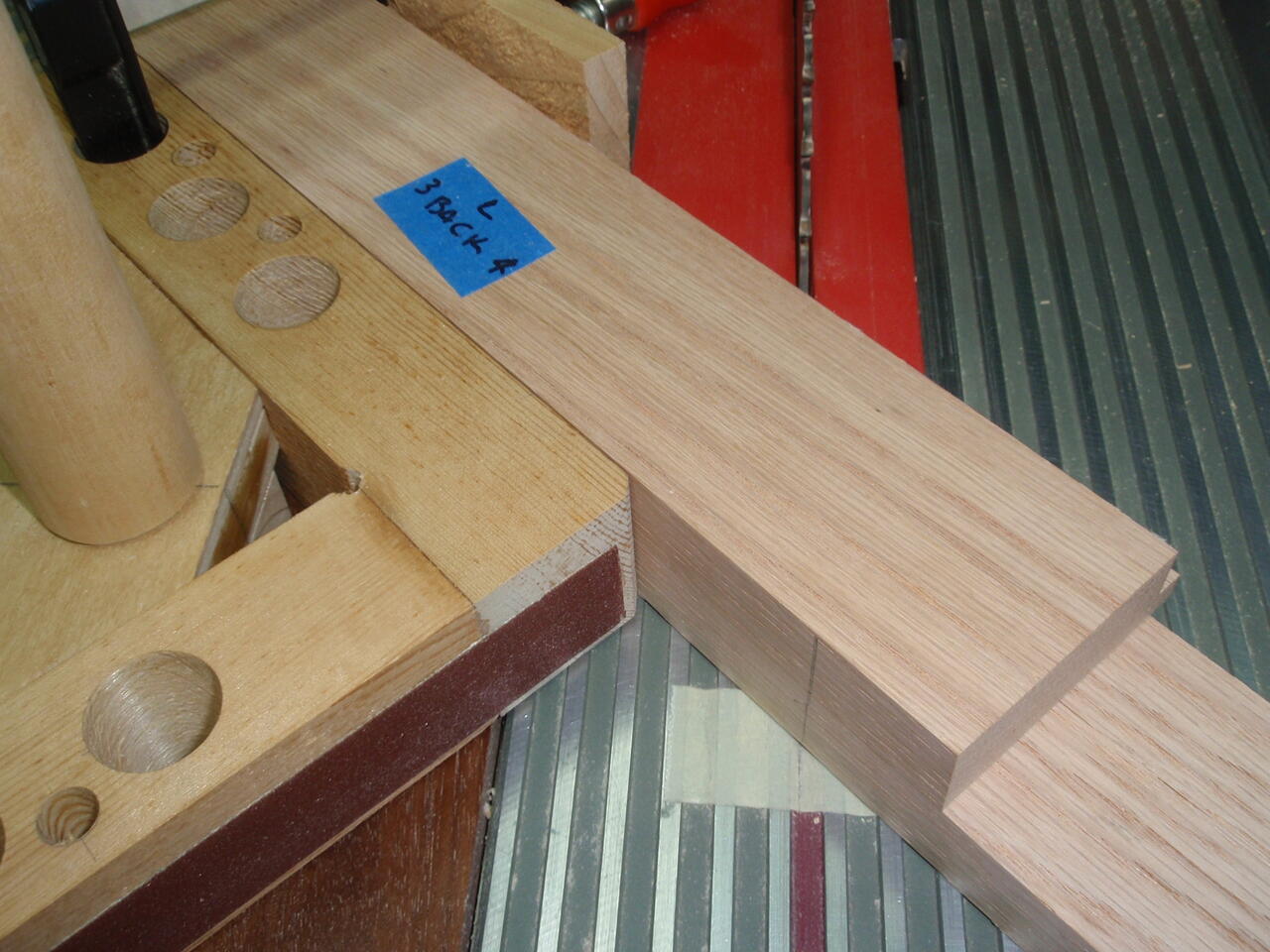

        After a break I finally got around to using the jig.

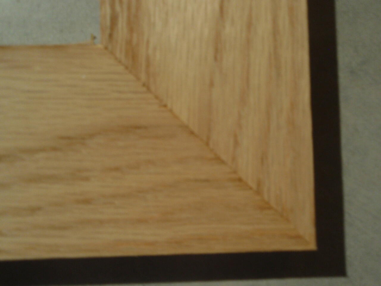

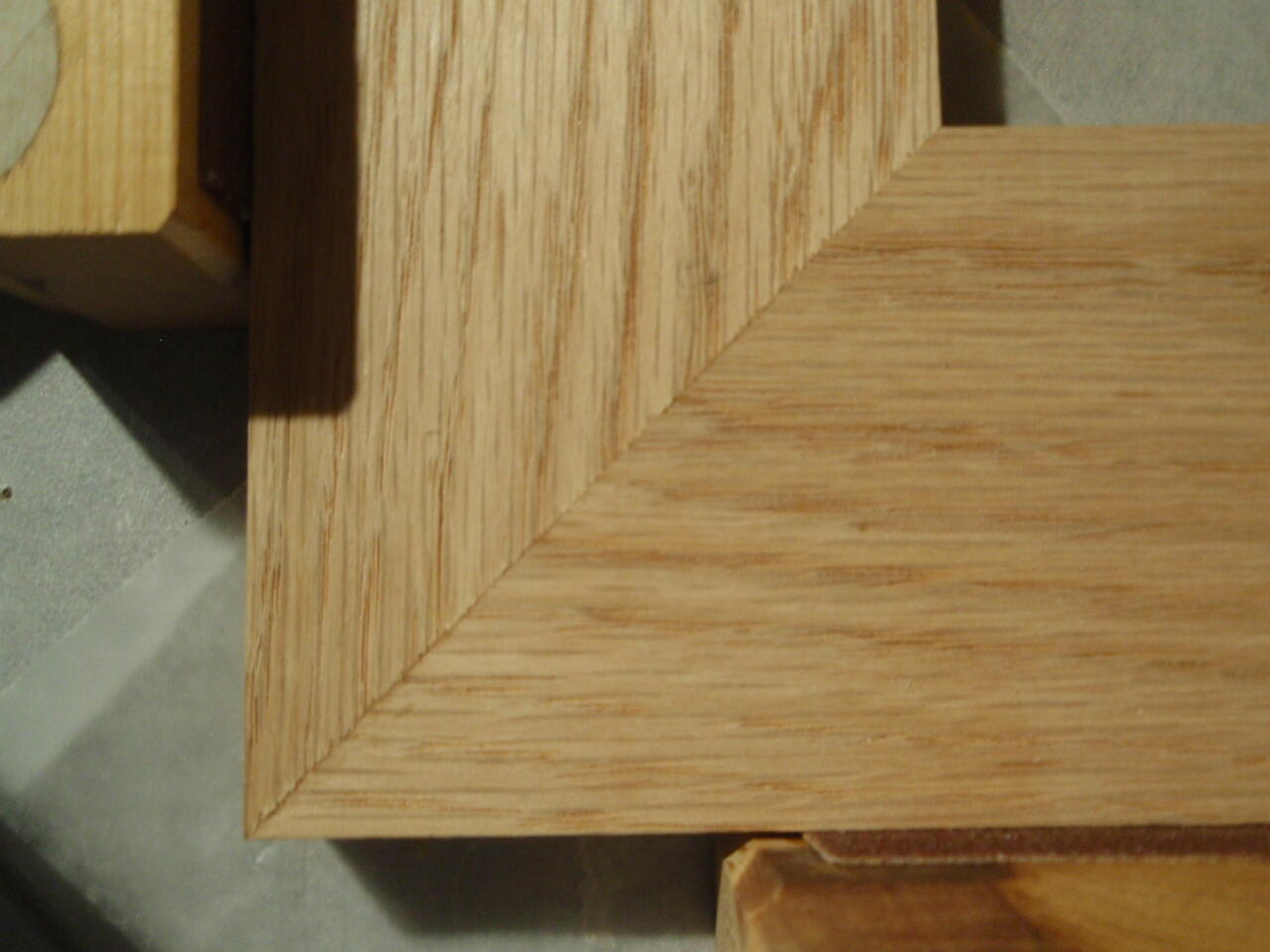

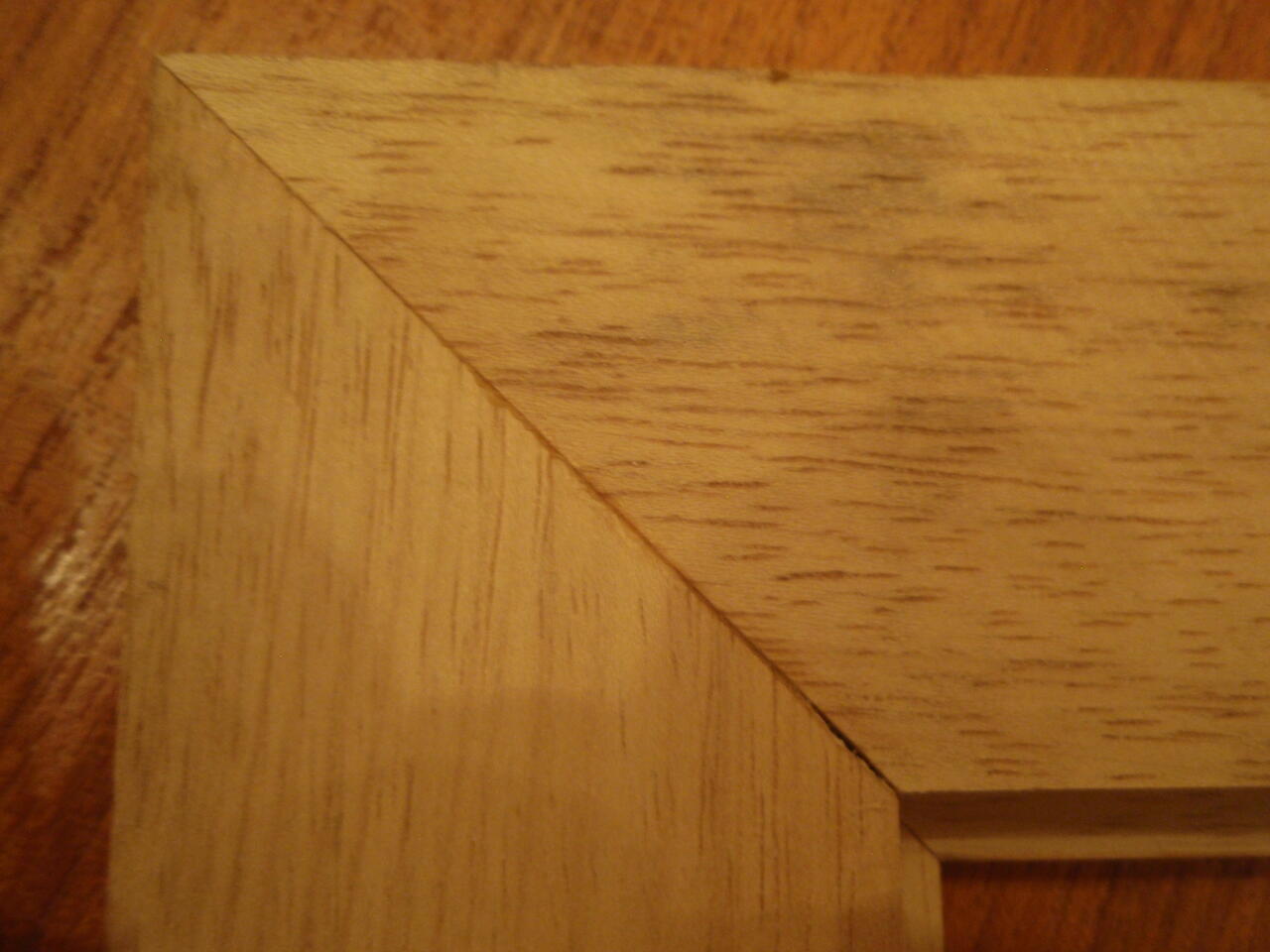

        You recall that the object of this jig is to make very square 90° corners with two complementary 45's. The basis being a very 90.00 degree square that is set ~45° to the blade so that the two angles cut on either side add up to 90.0.
        Here is a example from the last Mitered frame I made, I glues up two corners and then glued the remaining corners, all using a Bessey miter clamp.
        You can see the last two corners are not completely closed.
        Click image for larger version  Name:	P5041034.jpg Views:	36 Size:	91.2 KB ID:	850542 Click image for larger version  Name:	P5041033.jpg Views:	22 Size:	102.5 KB ID:	850543

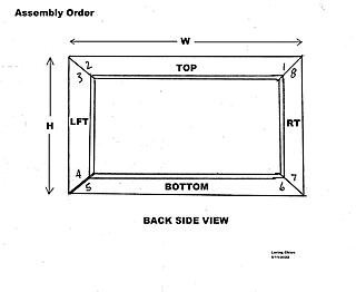

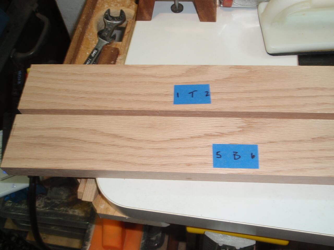

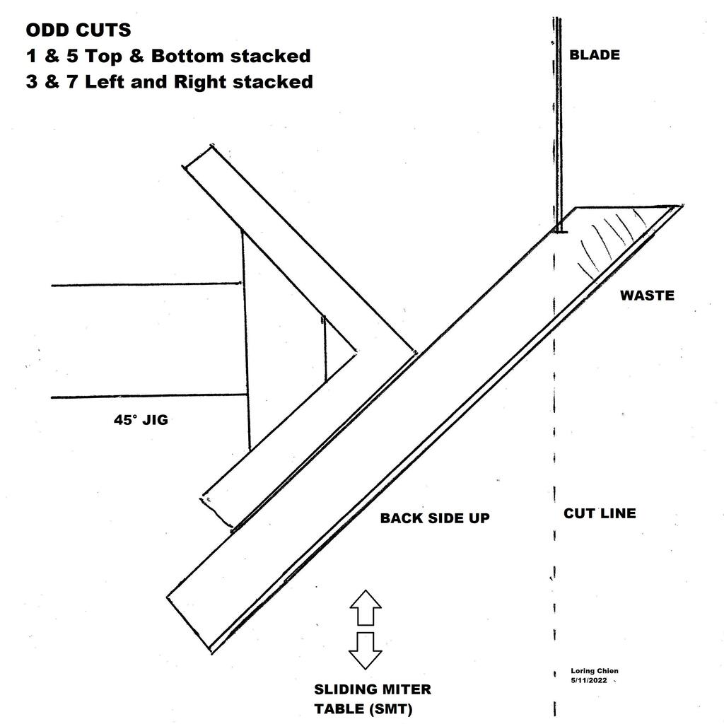

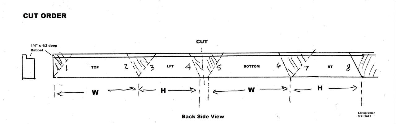

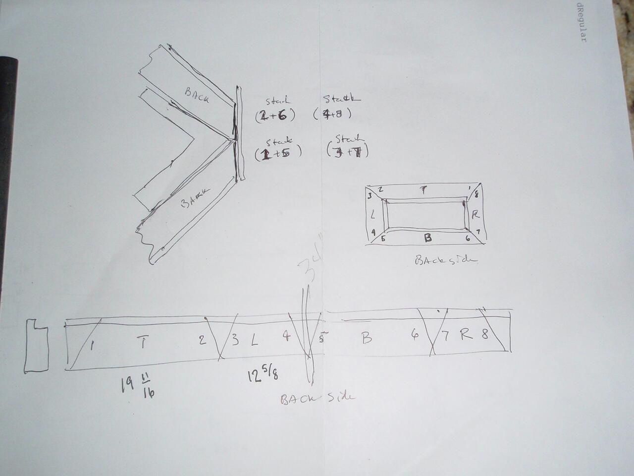

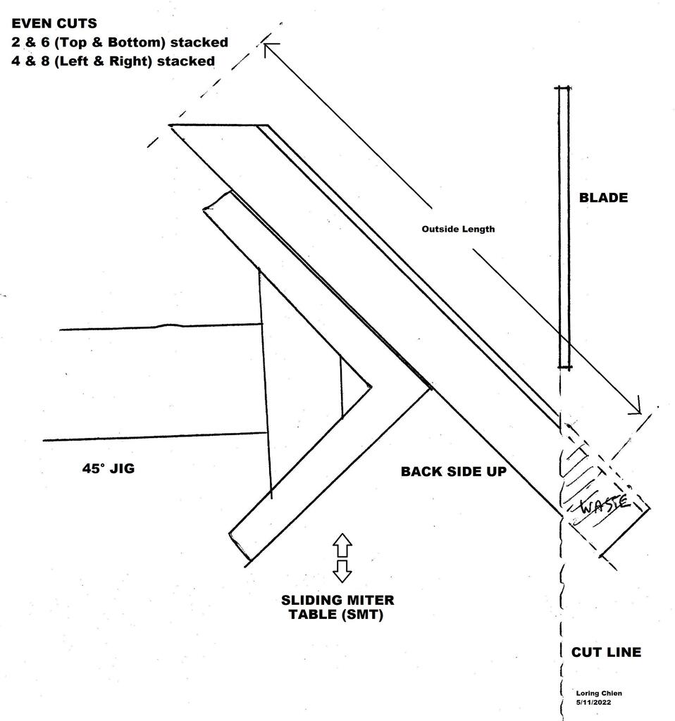

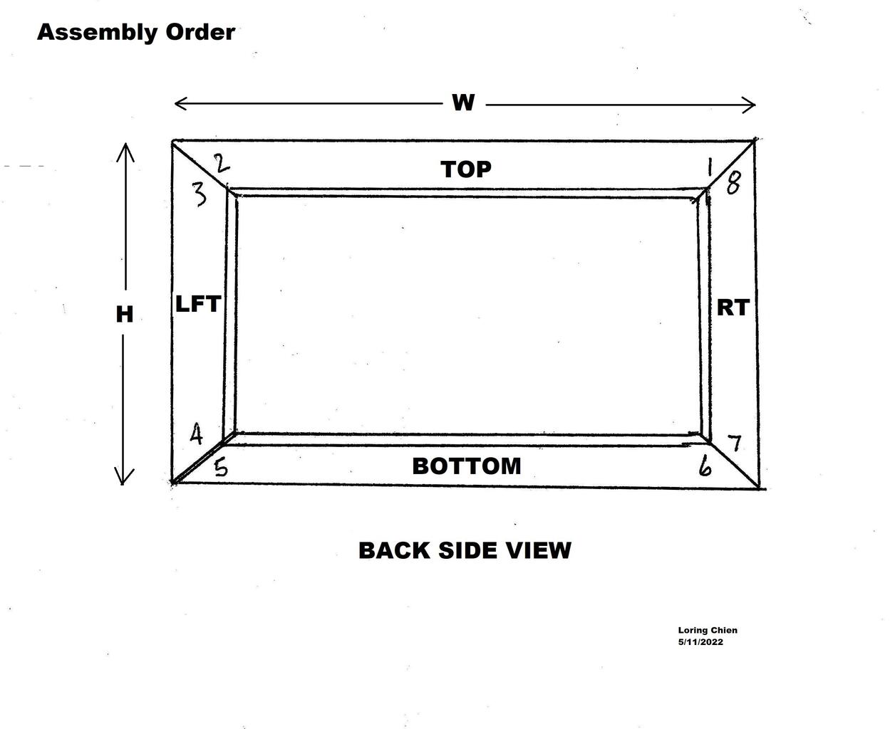

        Here is a plan of the jig, how to cut the frame of sequential pieces so that the grain matches, and how to fit the pieces together.
        I mark all the pieces so I know which is which and don't swap or reverse similar looking pieces. T,L,B,R are top, right, bottom and left as viewed from the back side. The miter cut edges I numbered 1-8.
        Click image for larger version  Name:	5 deg jig assembly order annotated.jpg Views:	0 Size:	58.1 KB ID:	850653
        Click image for larger version  Name:	45 deg jig cut order annotated.jpg Views:	0 Size:	36.2 KB ID:	850657
        Click image for larger version  Name:	45 deg jig  odd cuts annotated.jpg Views:	0 Size:	62.7 KB ID:	850655
        Click image for larger version  Name:	45 deg jig even cuts annotated.jpg Views:	0 Size:	63.8 KB ID:	850656

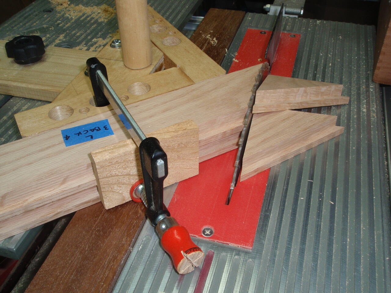

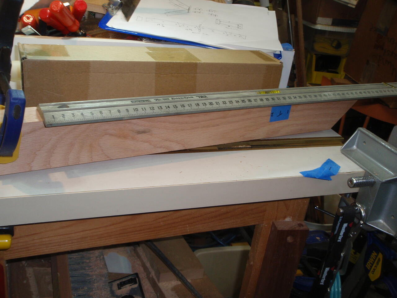

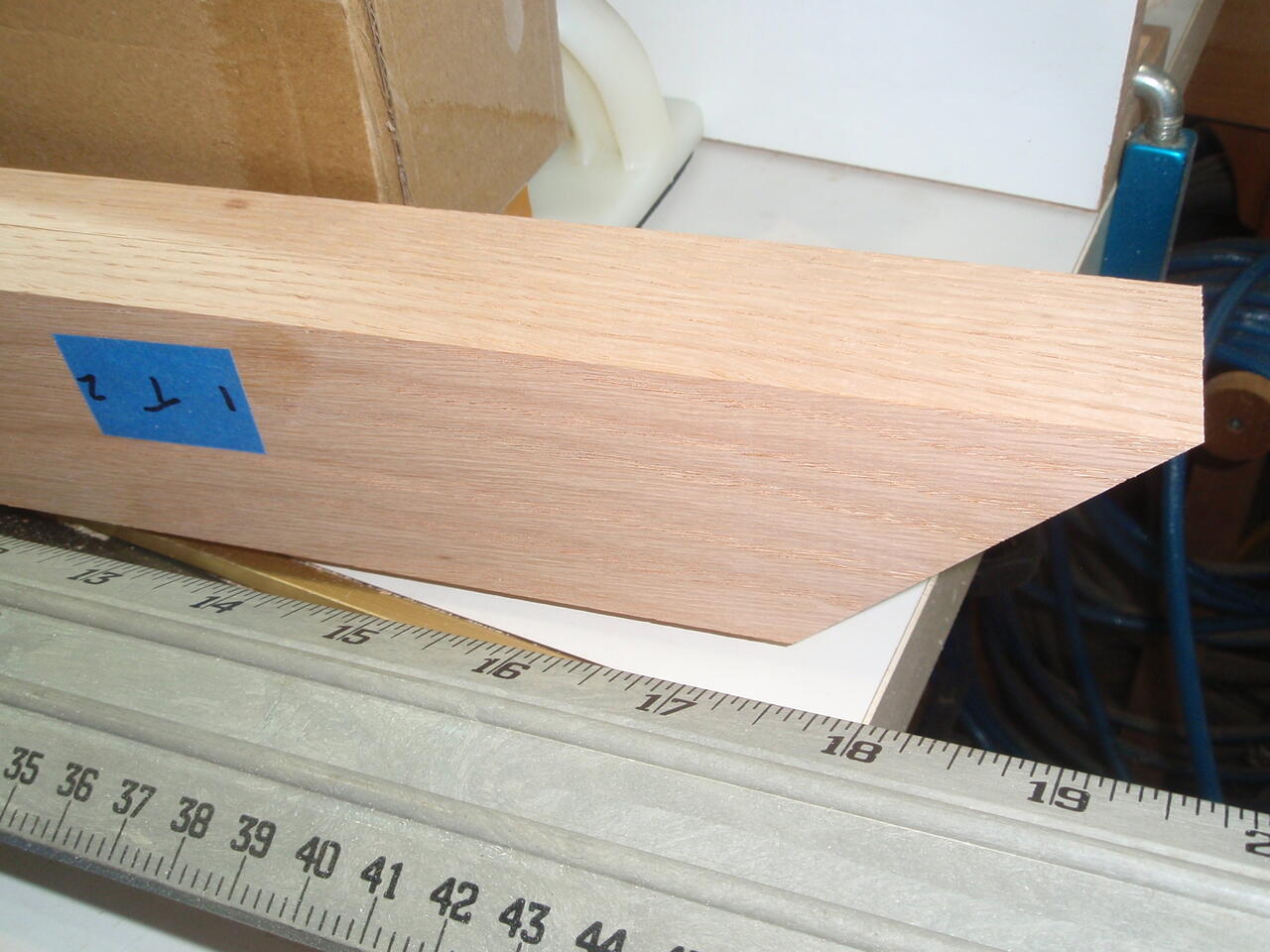

        I cut the board between the 4 and 5 marks leaving a little extra space for two 45° kerf waste (allow W+L+1/2" from the left end). This allows me to cut the Top and bottom rails at the same time since the lengths are identical and the L & R at the same time, stacking them. The rabetted edge is up and hard to see in this picture but matches my paper plan.
        Click image for larger version  Name:	P5041009.jpg Views:	20 Size:	98.5 KB ID:	850545

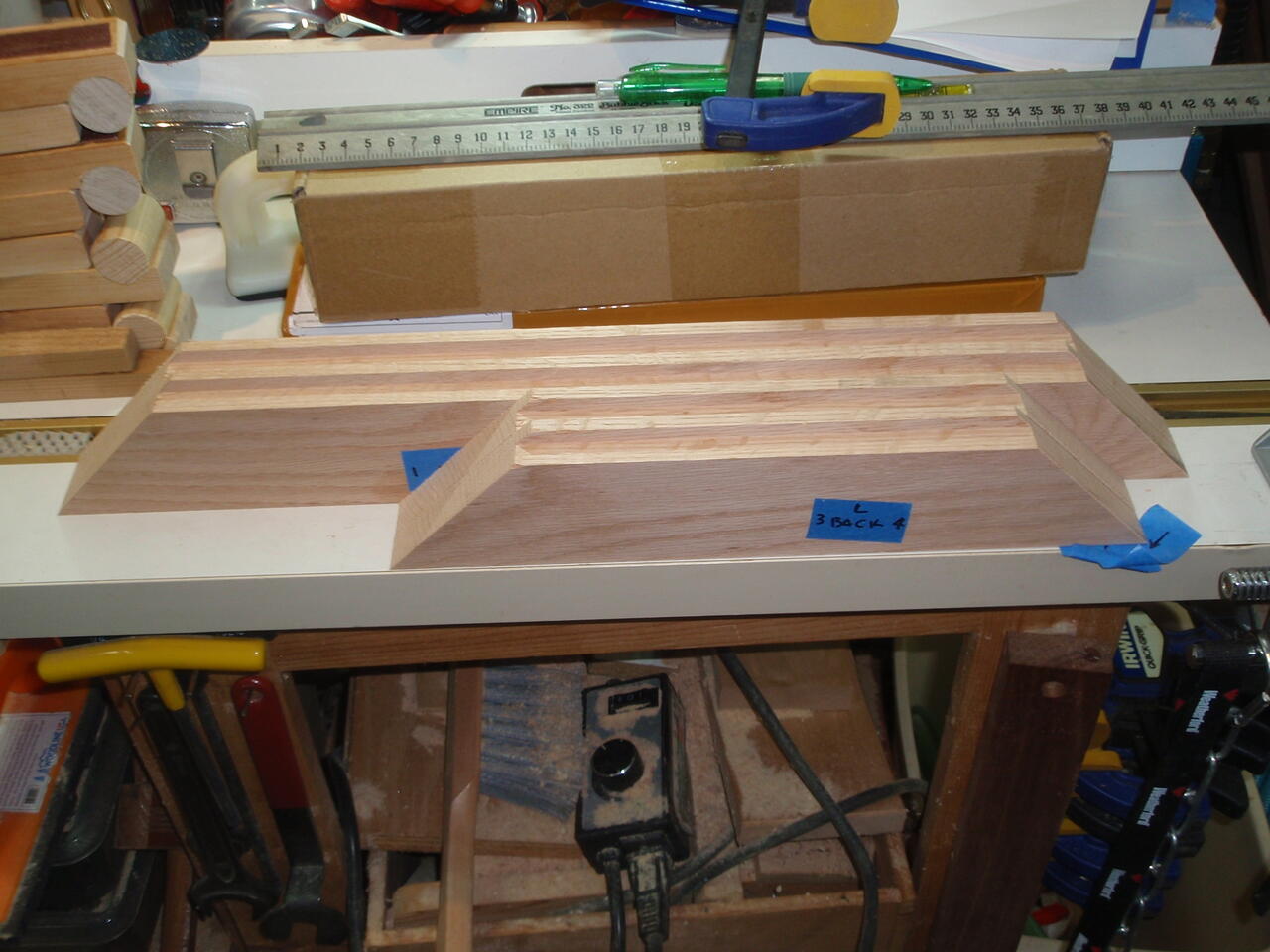

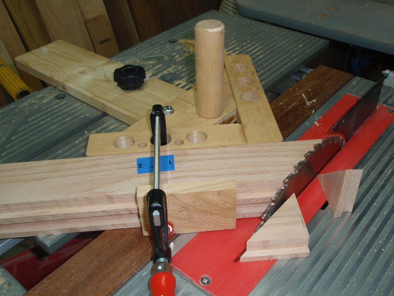

        Stack the boards and make the first cut on the close side of the jig. All the odd numbered edges are cut on the close side and all the even cuts are on the far side of the jig... so that even and odd are mated to be complementary. Note the rabbet edge is away from the jig. This is cut for edge number 1 & stacked with number 5.
        Click image for larger version  Name:	P5041011.jpg Views:	20 Size:	150.3 KB ID:	850546 Click image for larger version  Name:	P5041012.jpg Views:	22 Size:	119.4 KB ID:	850547 Click image for larger version  Name:	P5041013.jpg Views:	20 Size:	135.6 KB ID:	850548
        How to get the cut line set
        Click image for larger version  Name:	P5041014.jpg Views:	22 Size:	108.4 KB ID:	850549
        This is set up to make the second cut - edge number 2 on the far side of the jig, also stacked with number 6.
        Click image for larger version  Name:	P5041016.jpg Views:	21 Size:	149.4 KB ID:	850550
        The third cut is edge number 3 stacked with number 7, again , odd cut close side.
        Click image for larger version  Name:	P5041019.jpg Views:	21 Size:	173.8 KB ID:	850551
        And measure off the side height, and made cut number 4 (stacked with 8)
        Click image for larger version  Name:	P5041020.jpg Views:	22 Size:	149.9 KB ID:	850552
        Four cuts and done! It goes very fast!
        Click image for larger version  Name:	P5041022.jpg Views:	20 Size:	129.5 KB ID:	850553

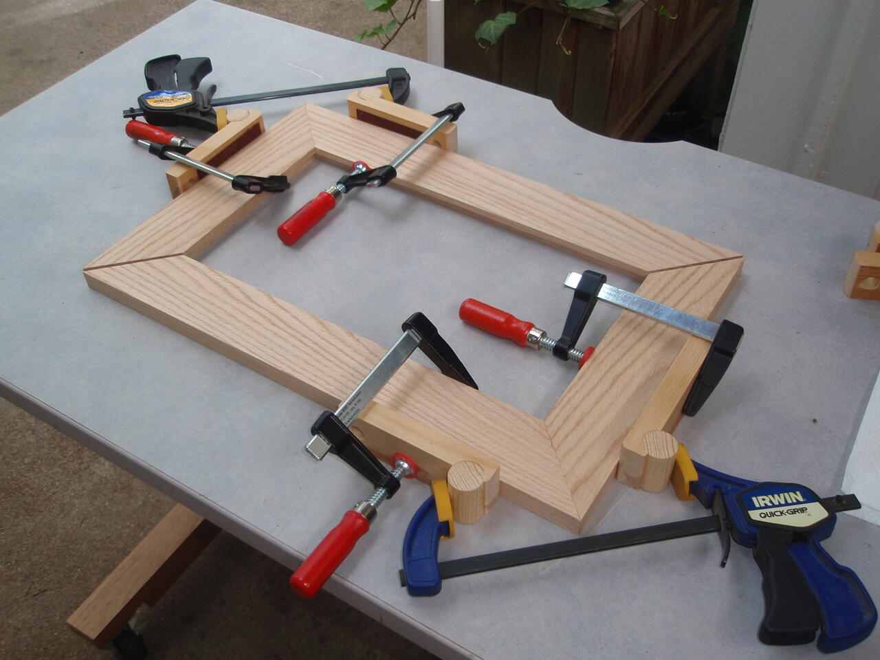

          This is a continuation of the frame making exercise from the previous post in this thread.

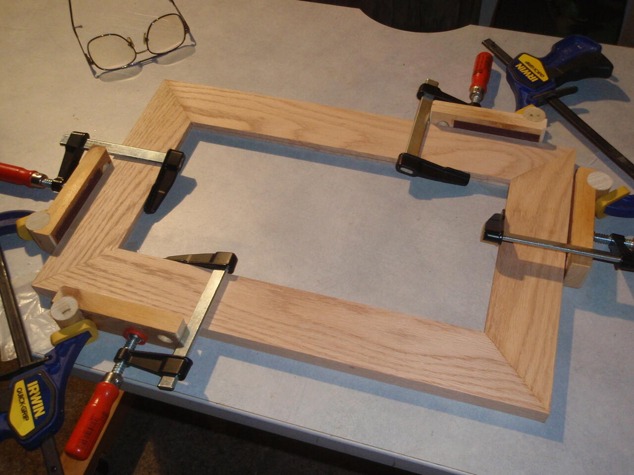

          The First test was a mess - I used some good pine, my Bessey miter clamps were not able to open enough So i used some older classic miter clamps and the problem was getting the whole shebang level.... I did two corners and then the two opposite corners and the result of a 19-3/4 x 12-5/8 frame was about 1/4" not flat. But laid out on a flat table the pieces looked perfect.

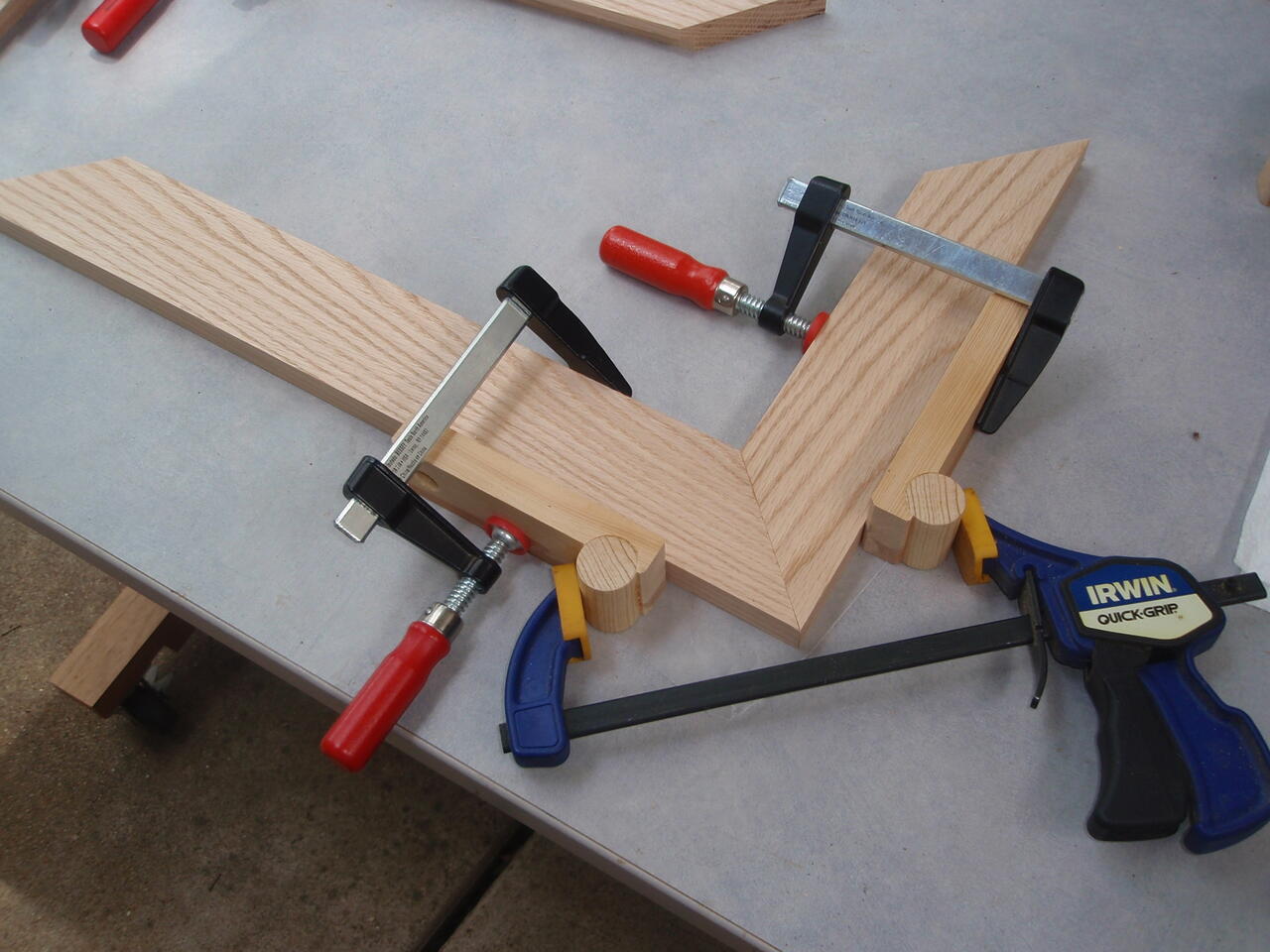

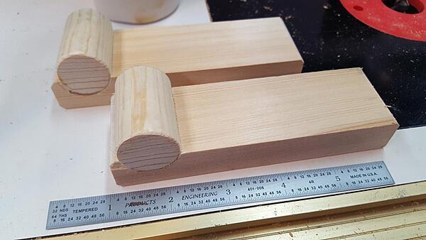

          So I decided to change and use my DIY odd angle miter clamps which work at 45/90 as well. The advantage is that they can lay flush on a table.
          Click image for larger version  Name:	fetch?id=840469&d=1615584662&type=medium.jpg Views:	0 Size:	31.1 KB ID:	850566
          DIY miter clamps post number 2 in this thread: https://www.sawdustzone.org/forum/di...u-made-part-ii

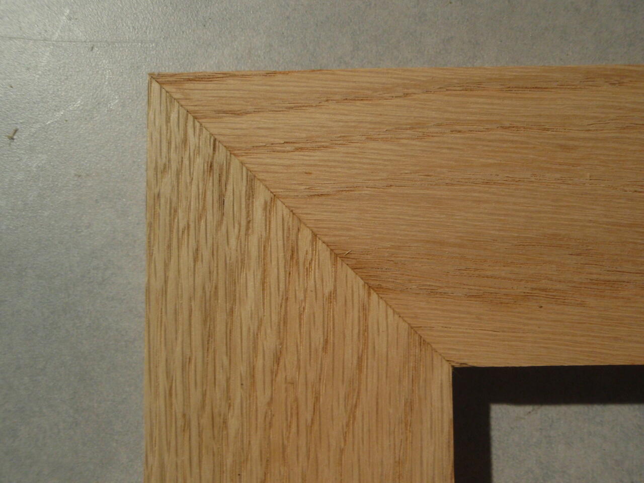

          I did two opposite corners. I could only get one clamp on the short side even though I had enough clamps. The other advantage of the DIY miter clamps is that it conforms to the exact angle of the joint rather than attempt to make it fit 90.
          Click image for larger version  Name:	P5031006.jpg Views:	0 Size:	125.6 KB ID:	850565 Click image for larger version  Name:	P5031007.jpg Views:	0 Size:	124.7 KB ID:	850556

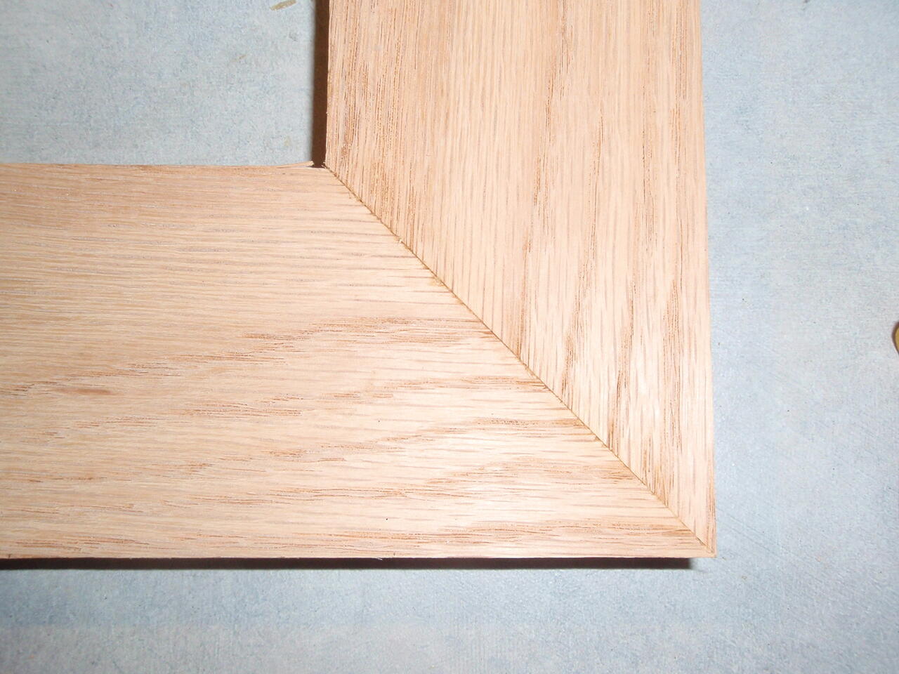

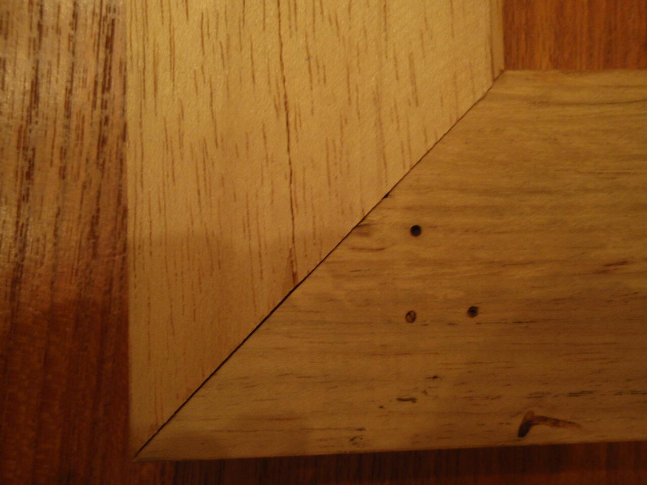

          When I placed the two halves together it was perfect... on both sets of frames I made.
          Click image for larger version  Name:	P5041025.jpg Views:	0 Size:	127.0 KB ID:	850559

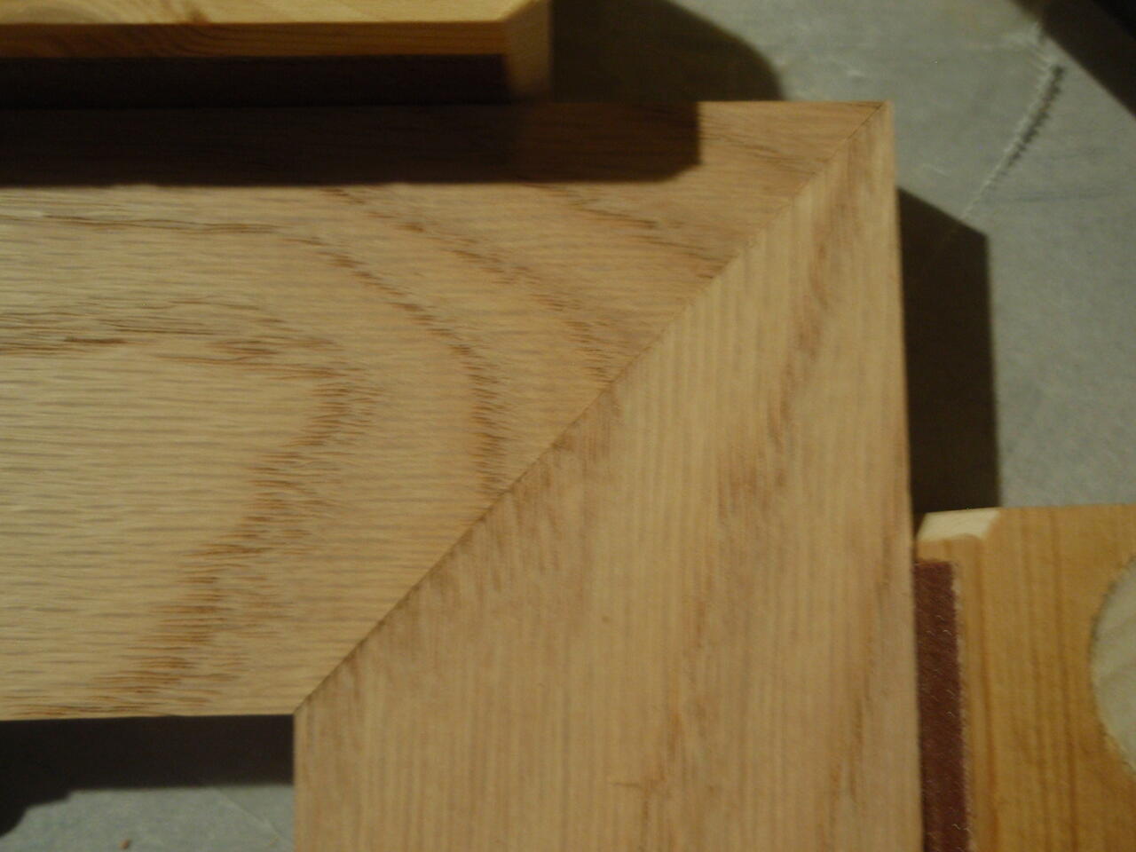

          I completed the glue up doing the remaining two corners with the frame perfectly flat on the workbench.
          Note that while I cut everything with the back side up I assembled and glued face side up so I could make sure the faces lined up perfectly. I used a rubber mallet to tap them perfectly flush. And could wipe off any excess glue with a damp towel. I use a piece of wax paper under to prevent gluing to the table.
          From long experience, I apply and spread thoroughly a film of glue on both end grain surfaces and wait about five minutes for it to be absorbed. Then apply another layer of glue. Otherwise the joint will most likely end up dry. The first coat of glue absorbs rapidly into the end grain of the wood (even at 45 degrees) and starves the joint of glue. The first coat skins the pores and the second coat makes the adhesion of the wood.
          I have to say these two final frames I made were the absolutely most perfect coming together with the least adjustments that I ever made.
          Here are the four corners before finish sanding, they'll look better after that:
          Notice the grain even matches as much as possible wrapping around (at least 3 of 4).
          Click image for larger version  Name:	P5041030.jpg Views:	0 Size:	83.0 KB ID:	850561 Click image for larger version  Name:	P5041029.jpg Views:	0 Size:	57.1 KB ID:	850562 Click image for larger version  Name:	P5041028.jpg Views:	0 Size:	90.0 KB ID:	850563 Click image for larger version  Name:	P5041031.jpg Views:	0 Size:	125.9 KB ID:	850564
          All in all the miter jig did live up to expectations of making perfect 45/90 degree miter joints as I expected.
          Using the complementary angle technique, cutting top and bottom together, and having the planned order made it fast and non confusing - just four cuts and the frame came out with perfect joins and lays perfectly flat.
          After the first one I made two more with red oak 1x3x 6 foot from the box store and both came out perfectly.

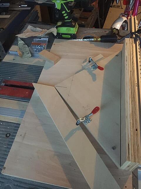

            #29

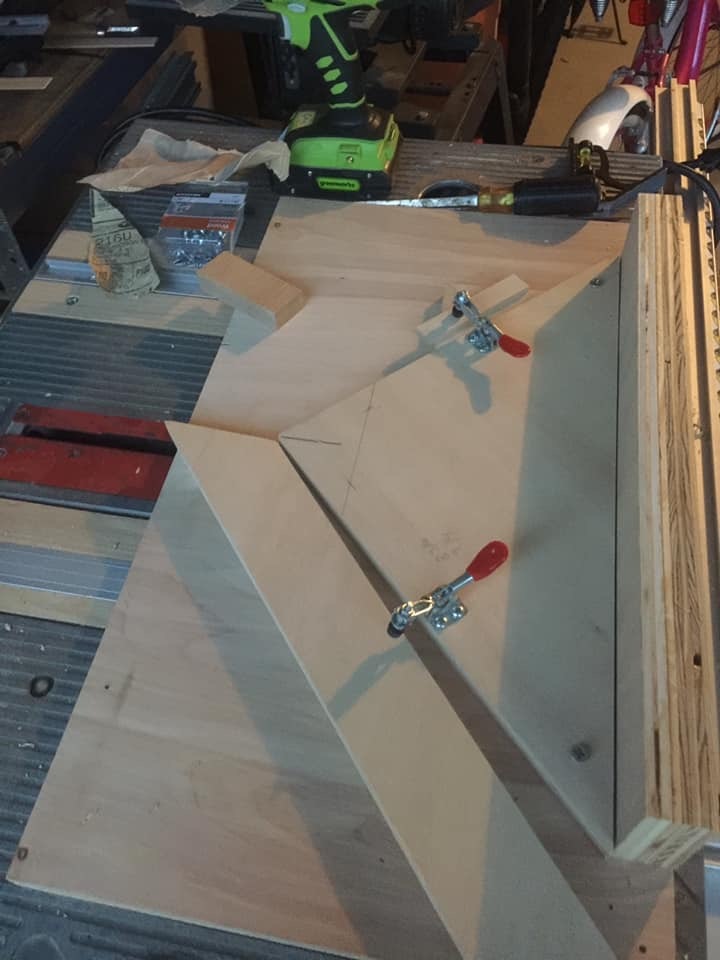

            Nice jig! I’ve been thinking about making a new one. I have a sled but it’s limited.

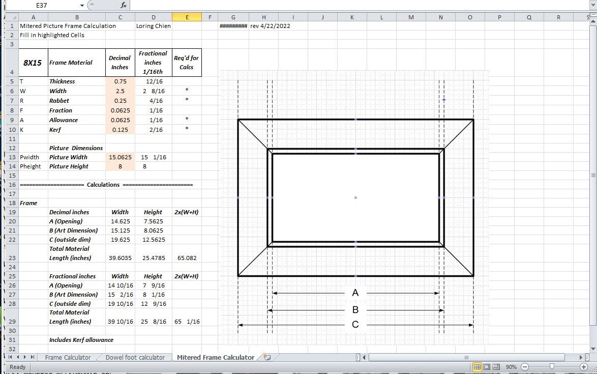

              Here is the spreadsheet I use for making frames.(actually page 3 of the spreadsheet) to calculate the exact outside dimensions for a frame to fit a given picture size given the frame member width, the rabbet size and allowance.
