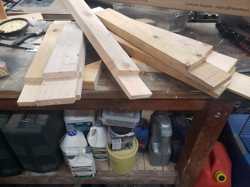

    I cut the 2x4 pieces to length and the 2x6 corner braces as well. Just basic triangles...
    I played with the idea of setting up the table saw to make the cuts for the half laps, and even considered hand cutting them, but in a fit of either stupidity or inspiration I went with the bandsaw. I need to follow up with a sharp chisel and a sander to get the glue line as best I can get it, and I WILL be trusting screws here...

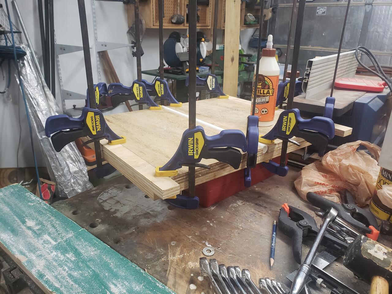

          The flip top stand sandwich is in progress. Due to me using reclaimed materials I am having to use short cutoffs at the ends. The pivot is not 100% centered, but within 1/8", however the working time of Gorilla Glue wood glue is apparently considerably shorter than Titebond II.
          I am going to trim it out using my router once set up.
          Flip top stand sandwich
            • 9568
            So I sanded down the PVC using hte belt sander to make quick work of it, and glued up the second half before trimming the excess from the middle. The bolts are glued in and I might just have to CAREFULLY trim the sides and ends with the pull saw...
