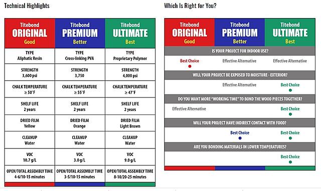

            Why do you use Titebond II instead of III?

              And, no one wants to say why they prefer Titebond II over III? Looks to be more popular here.
              Someone said it's thinner
              I note from the chart it has shorter working time.

                I use Titebond Ii because that was all that was available when I needed glue! My next purchase will be Titebond III. it’s longer open time will be a great aide when assembling my TinyTables. I had been pushing the open time limits with II.

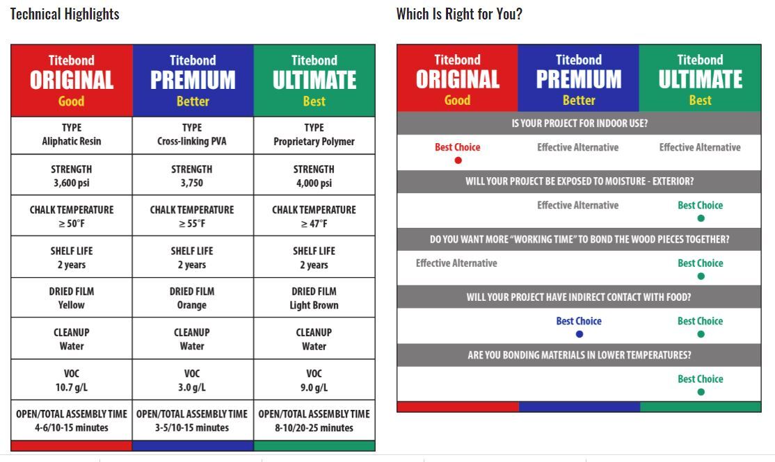

                              As it happens, yesterday I came across an anecdote on the Family Handyman site about doing that with Elmer's wood glue, on a recommendation from Borden:
                              https://www.familyhandyman.com/article/thinning-glue/
                              The text references Elmer's but the picture includes a bottle of Titebond III.
                              LCHIEN commented
                              Titebond picture, that's funny!
