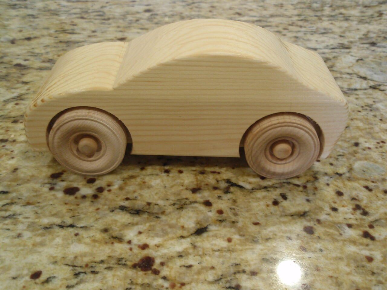

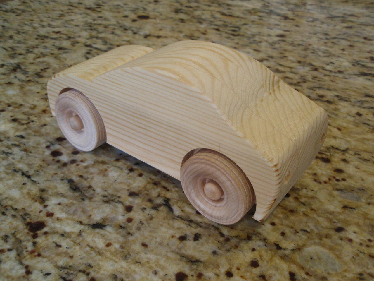

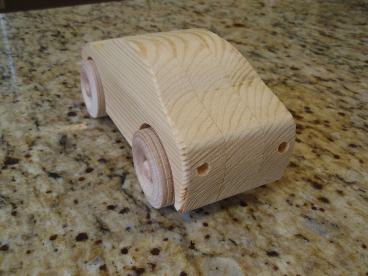

    Here's a sneak peek at the car.
    I have some pegs for the wheels but they fit very tightly so I just put them on loose dowels to see how everything looks.

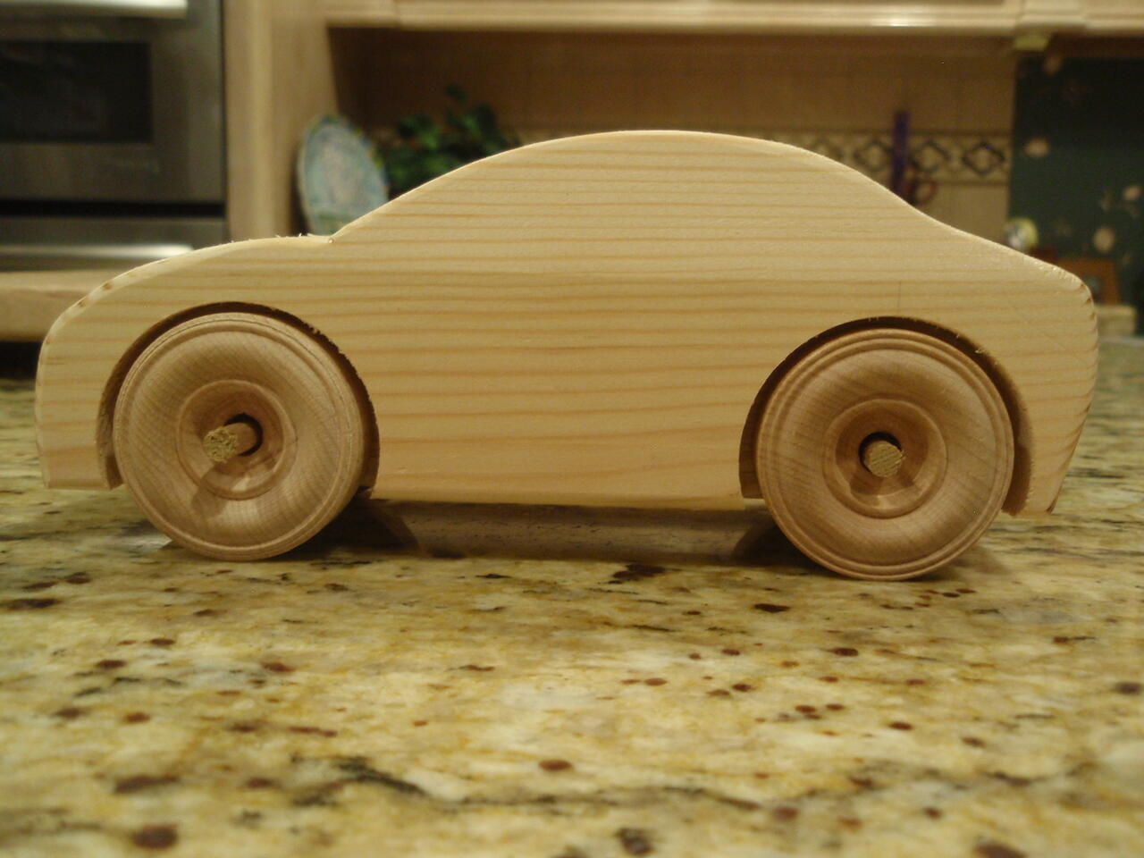

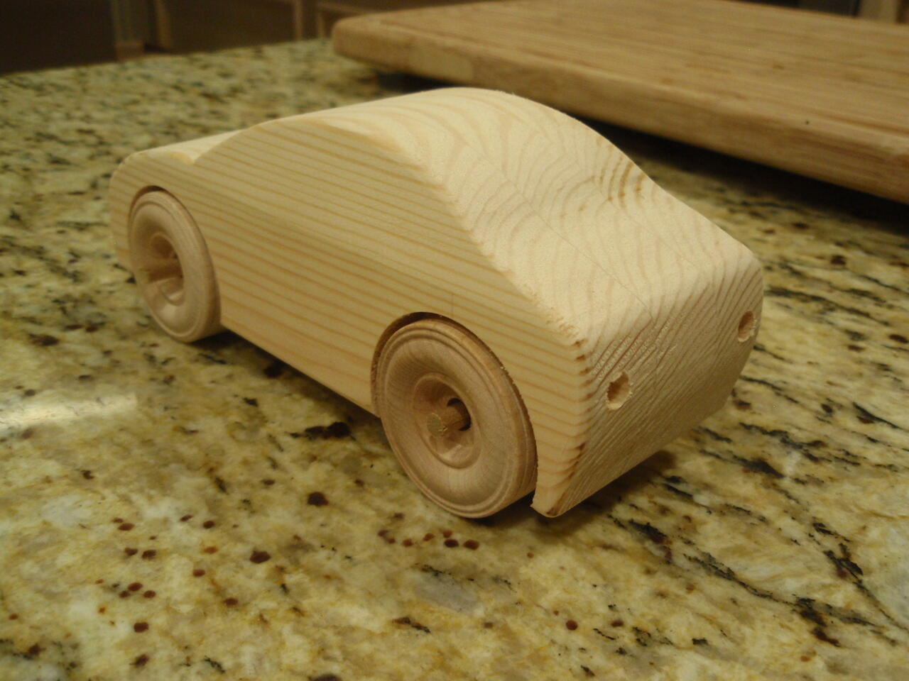

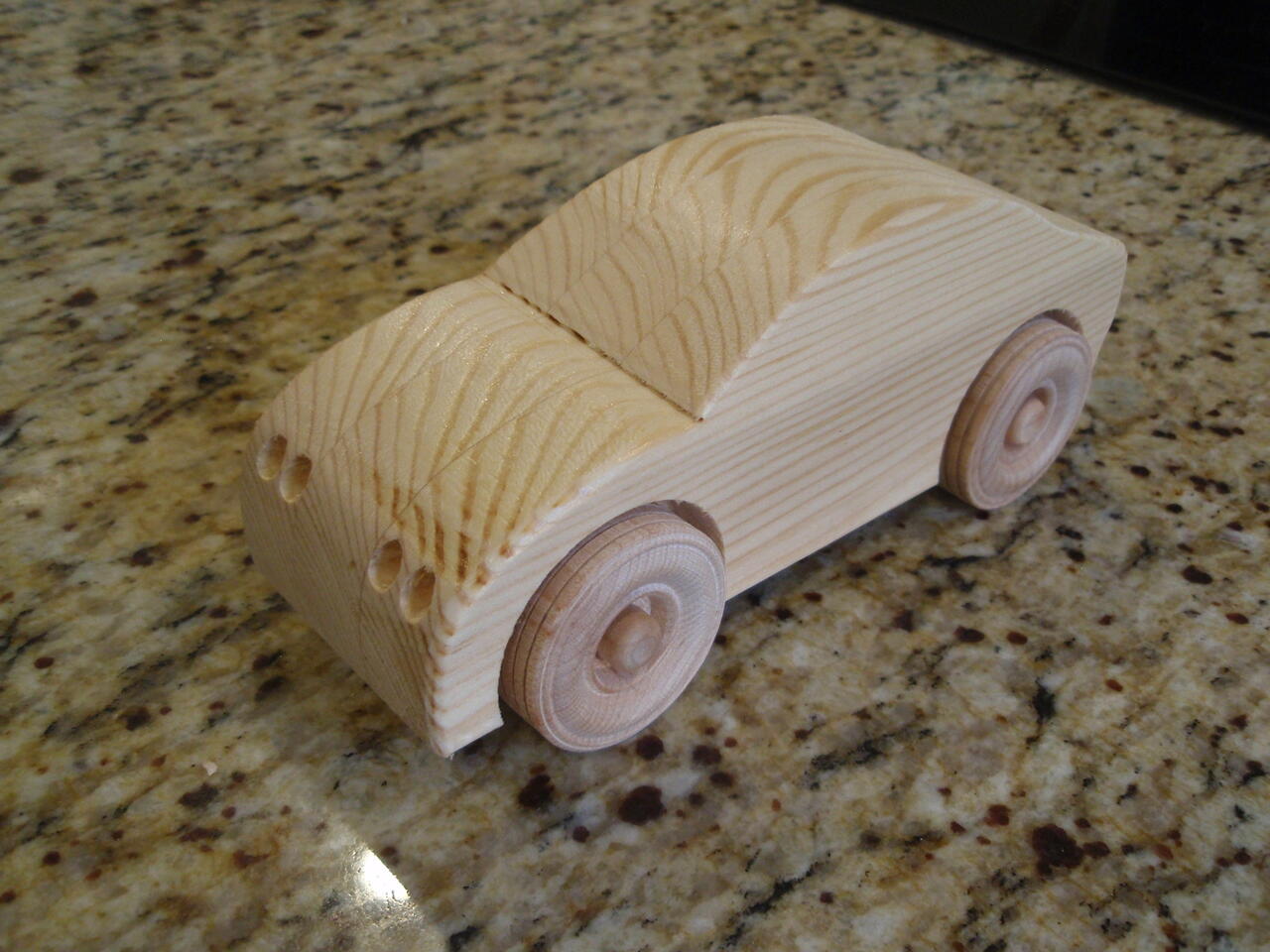

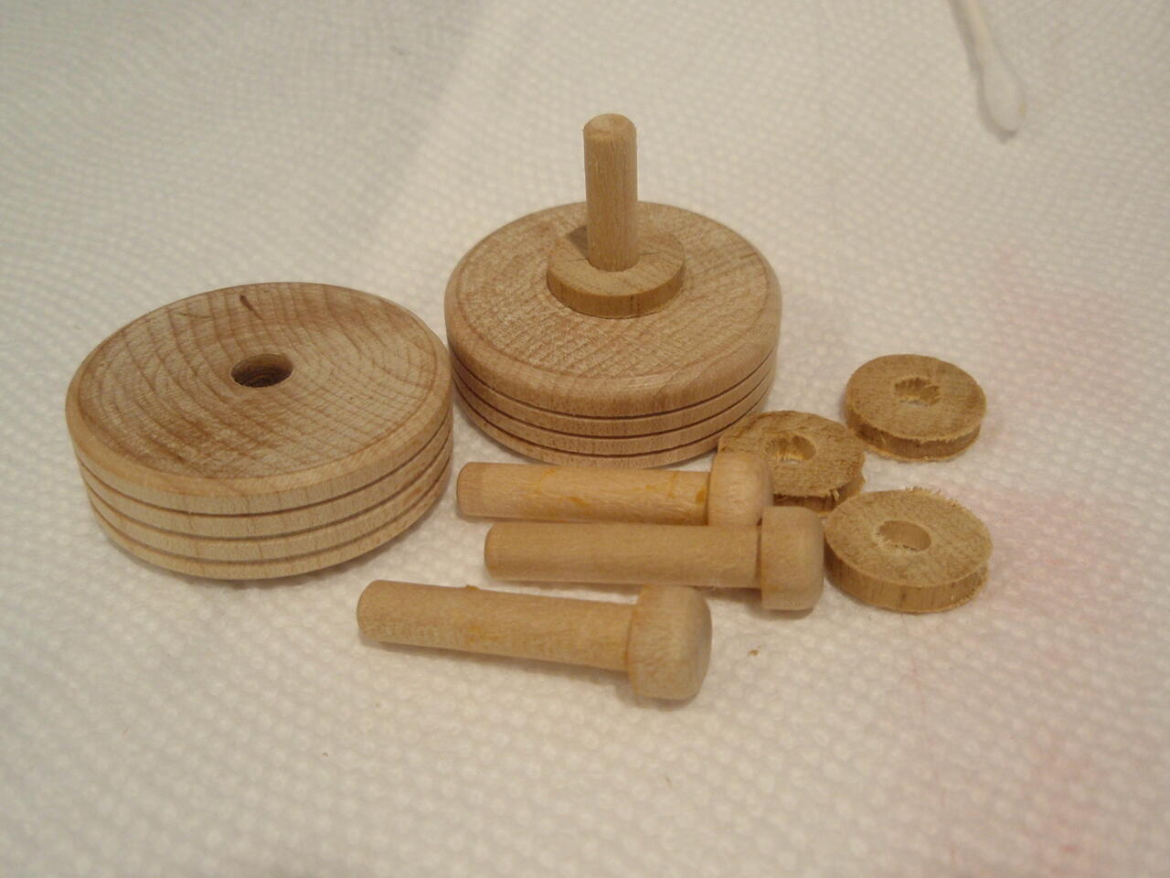

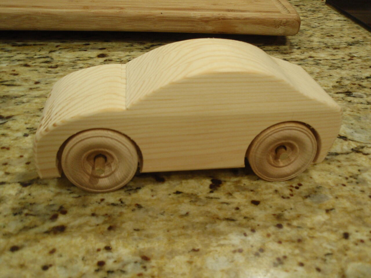

        Finished. Had to make some washers to space the wheel away form the wheel well, I thought there would be too much friction and I thought the wheel looked a little better a bit more proud of the fender well.
        Sprayed it with a few coats of acrylic, hammered the pegs in. (.217 in a .214 hole, not going to fall out).
        Pegs and wheels from Amazon. That would be a lot of work.
        Not entirely satisfied with how smooth the finish is. It hard to sand curved surfaces with a sanding block. Especially the front and back being end grain.
        Any suggestions - detail sander perhaps?
        Only have 46 wheels and 96 pegs left, what next?

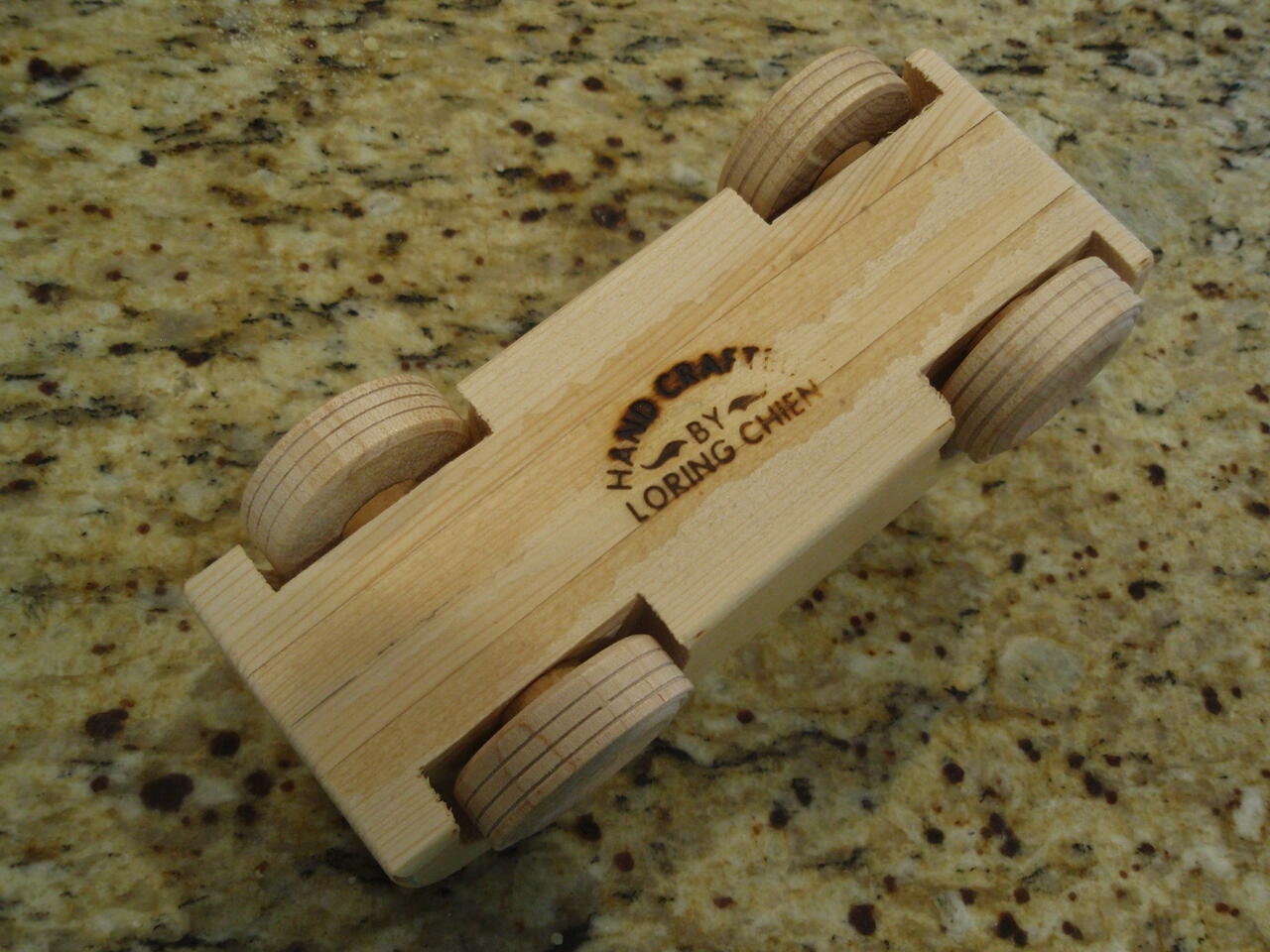

          Looks Nice! Now YOU have a toy to play with!
          I really like your stamp!
            LCHIEN commented
            The bad thing to me about the stamp is that it takes 15 minutes to heat up and then 10 seconds to do the stamping - its fairly unforgiving in technique and then it takes another 15 minutes to cool off enough to put away. Takes a long time although you can use the time to clean up your shop, haha.
            I have a small mechanical kitchen timer I bought off eBay that I keep in the box to time it.so I don't forget when doing other stuff.
            I've learned, when I remember, to stamp things early in the process so if I screw up branding I can replace the piece part (as opposed to waiting until its done and can't be disassembled).

          Its very gratifying (to me at least) that it rolls very smoothly and easily and in a perfectly straight line.

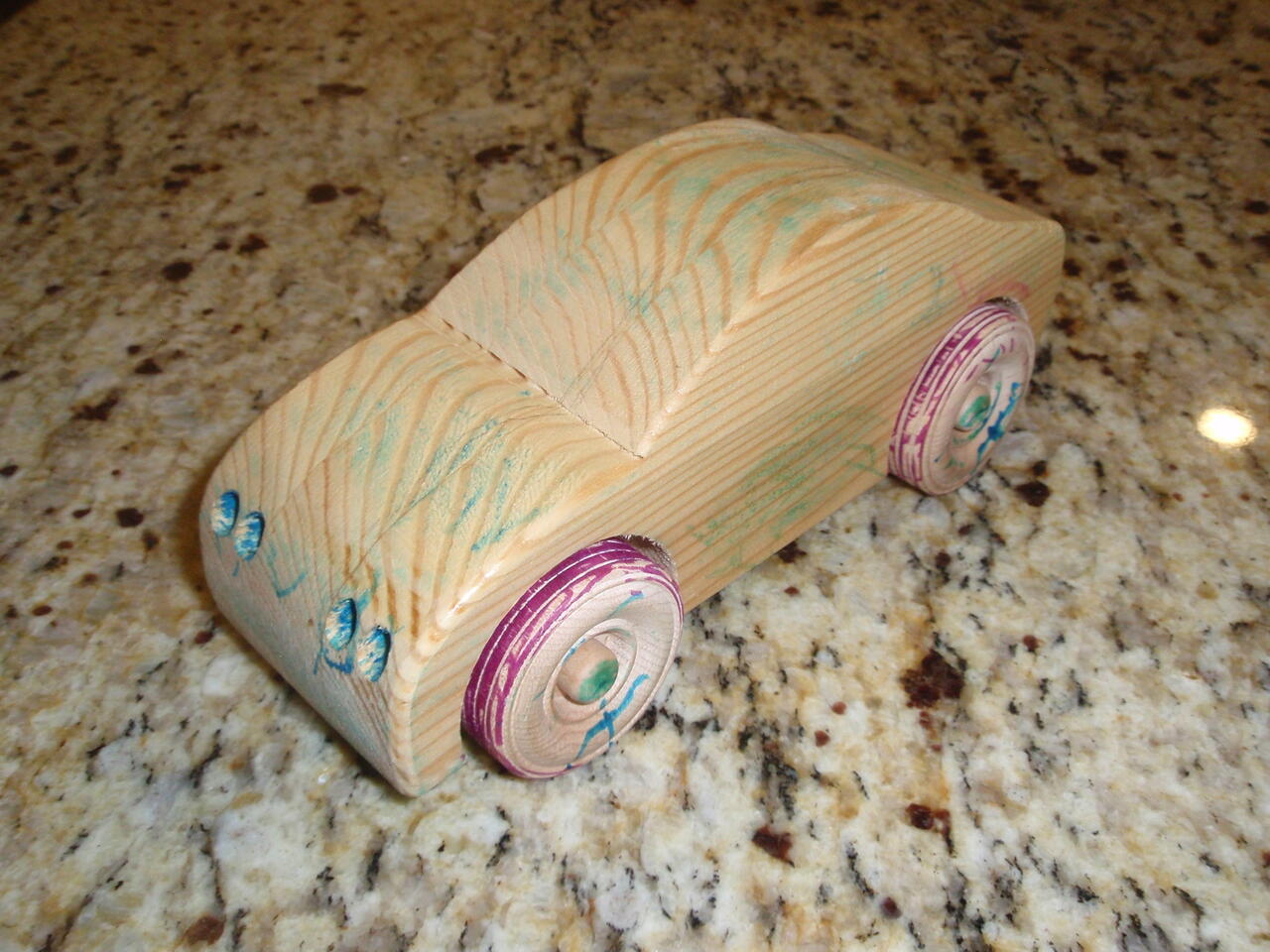

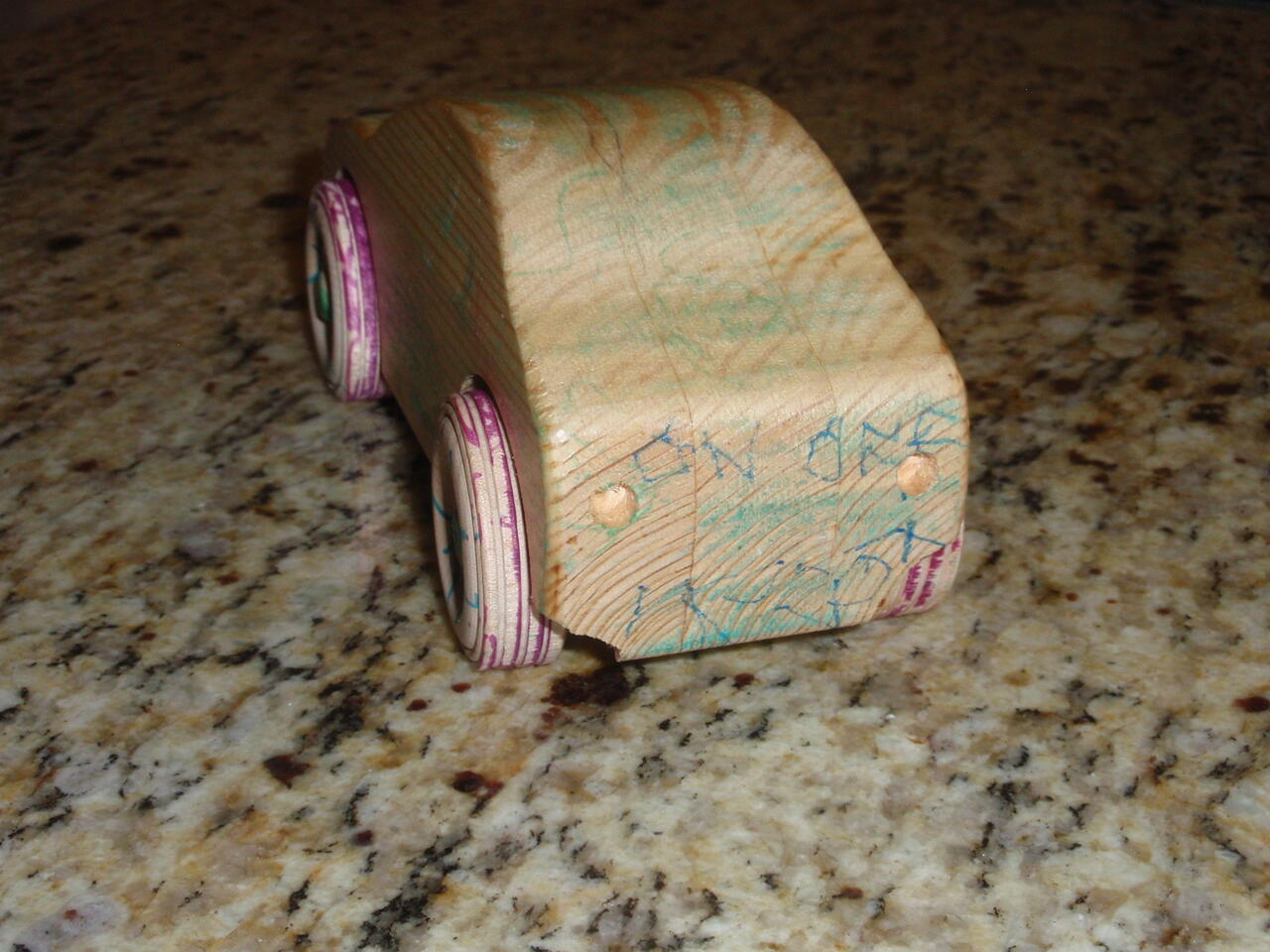

                      Had a bit of a hard life for a year...
                      Aside from the paint damage both the thin corners at the back wheel wells broken when dropped... apparently many times.
