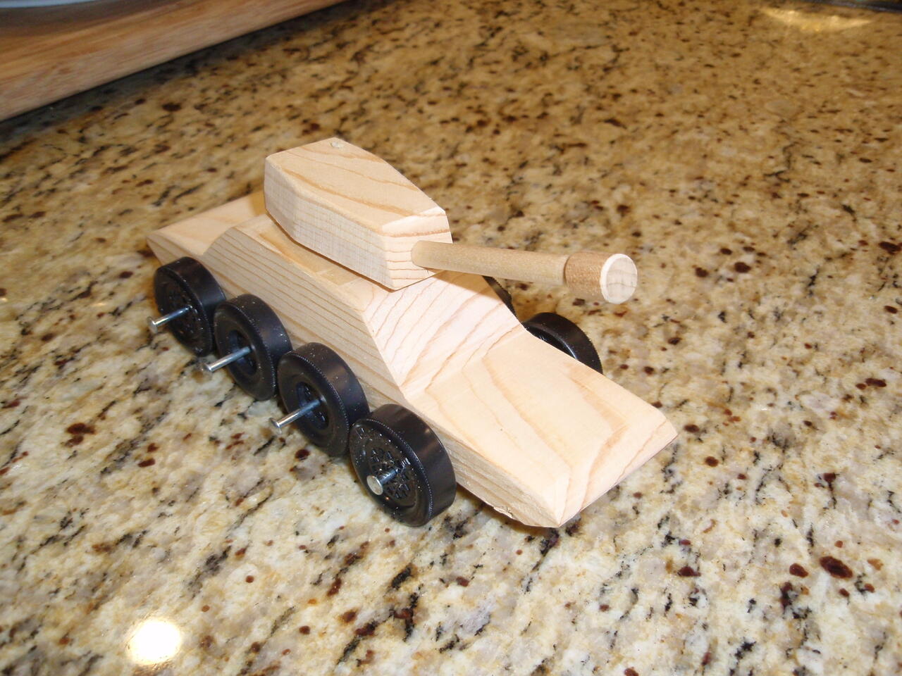

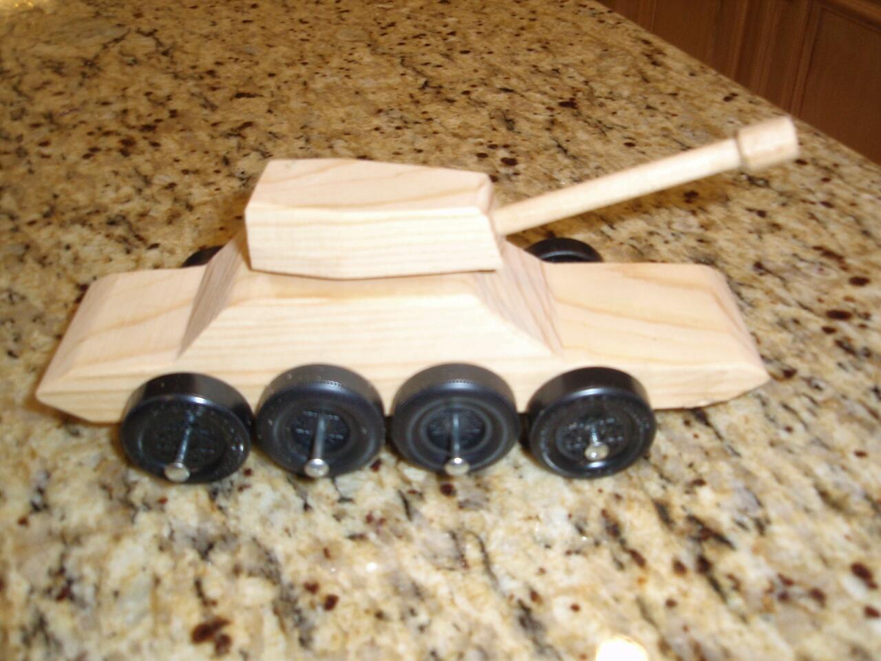

    Son-IL says he's too busy, help my grandsons... I got 6 days notice to weigh in That's six days for planning, cutting, painting. finishing, tuning, and weight adjustment. For two boys.
    First grandson says he needs a tank. He drew the outline and I bandsawed it. And yes the middle wheels are for effect, they are elevated a hair so they don't contact the ground and turn.
    As it is .with two 3/8" oz fishing weights in the bottom it weighs 4.970 Oz. I have to admit I designed the turret. Forgot to drill a hole in the end of the barrel. Told my daughter to paint one. I had extra wheels left over from my son's days in scouting.
    Click image for larger version  Name:	P1220092.JPG Views:	0 Size:	125.4 KB ID:	842329
    Click image for larger version  Name:	P1220093.JPG Views:	0 Size:	184.0 KB ID:	842328
    DIL in charge of painting. I hope she has some olive drab.
    Second car to come, what he wants is a real challenge.

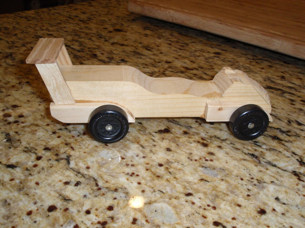

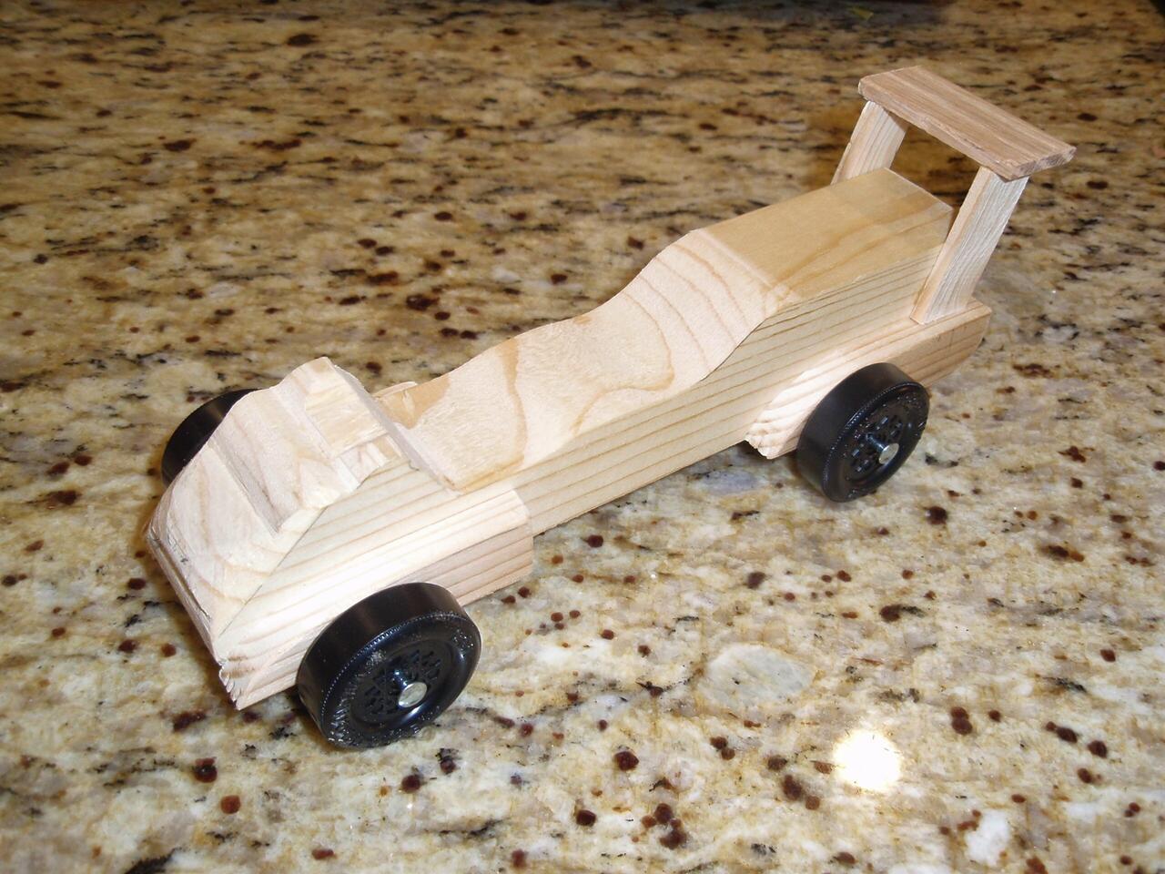

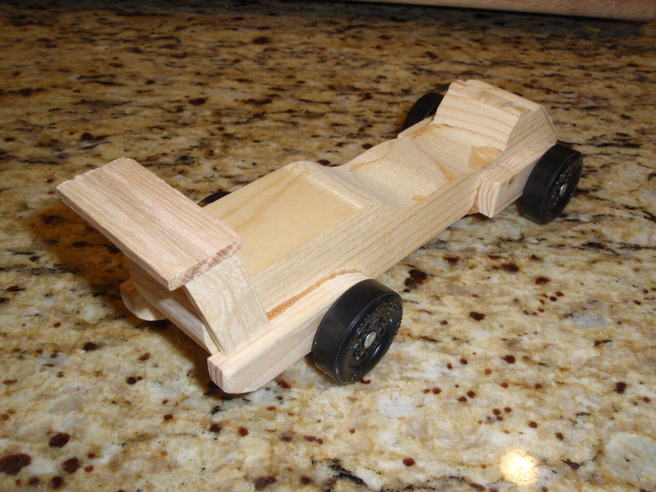

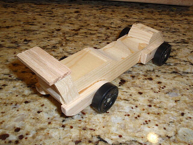

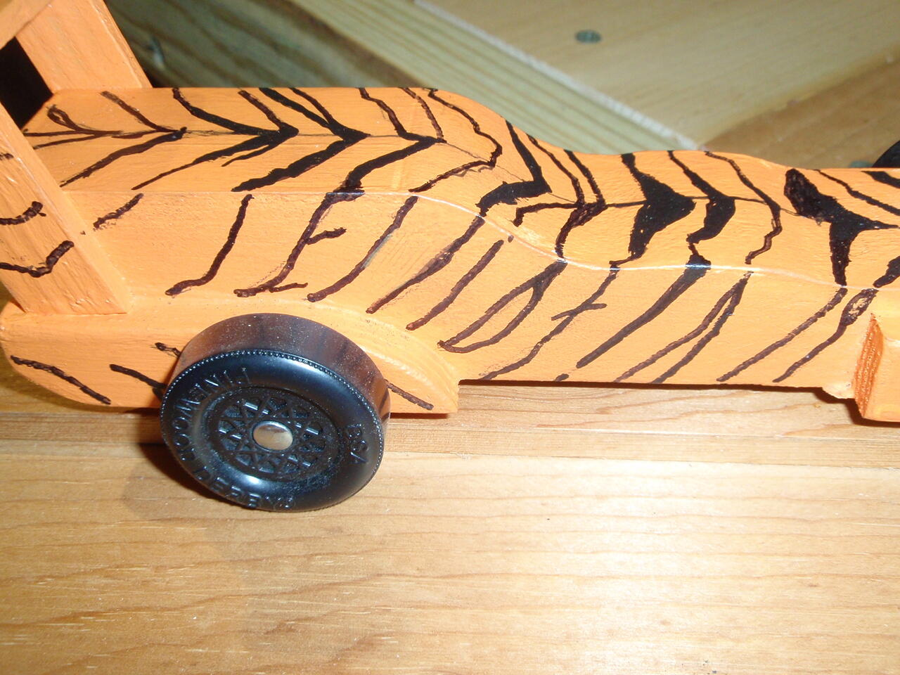

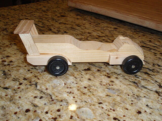

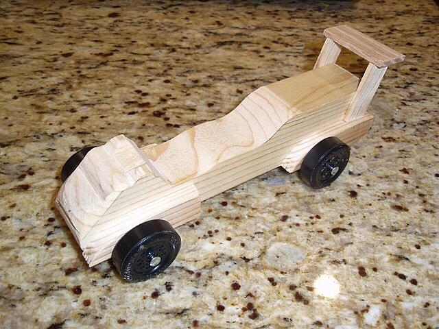

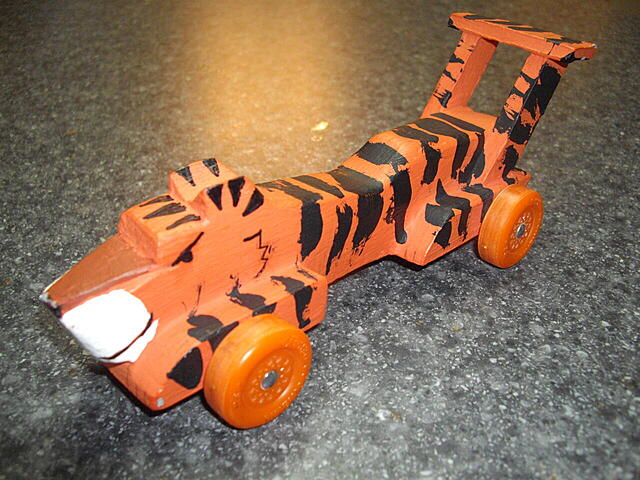

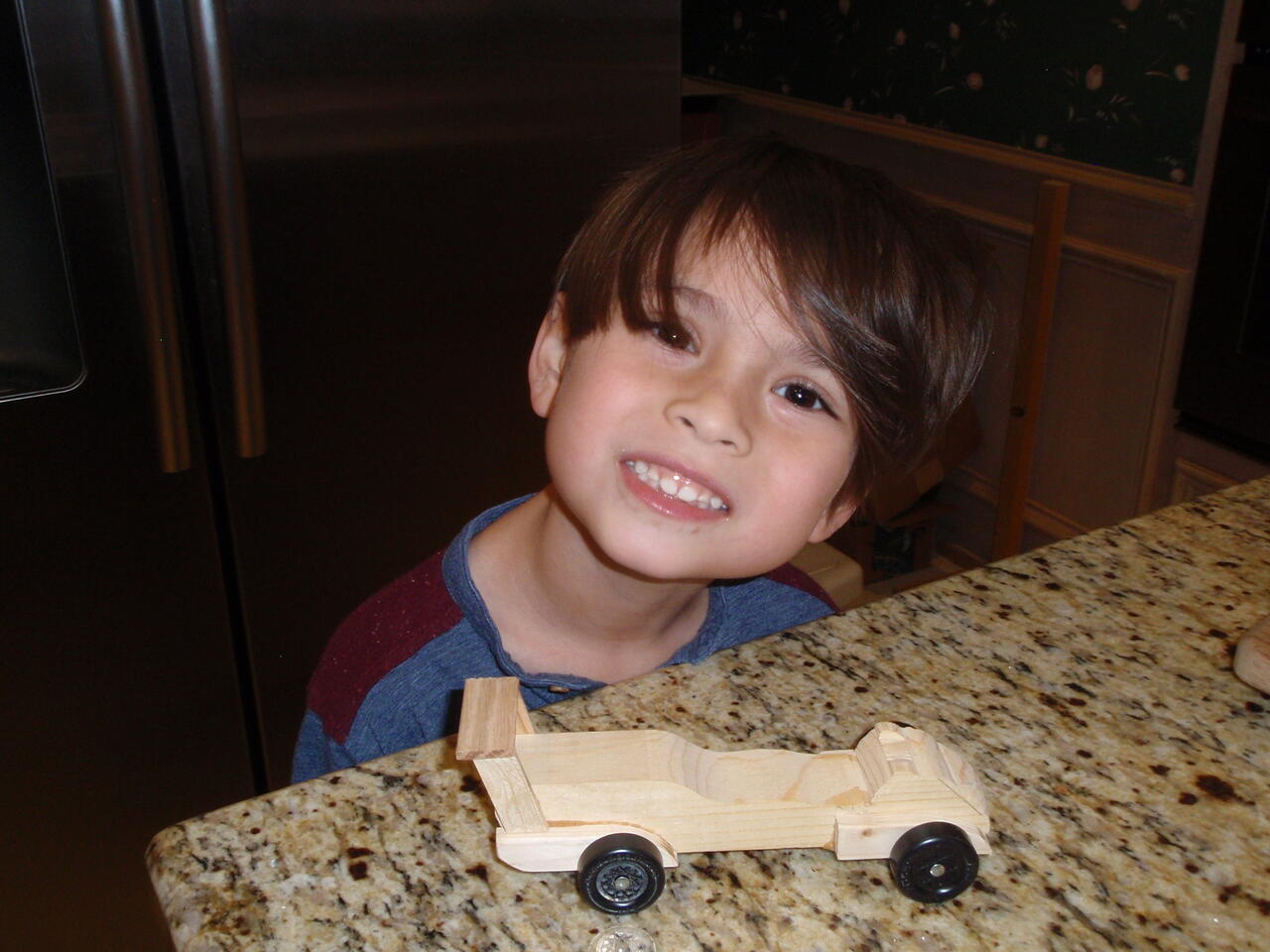

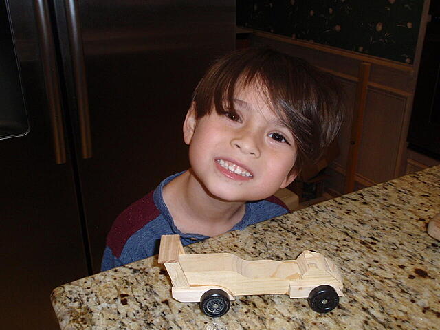

    No. 2 Grandson wanted a tiger. Whew!
    It's gonna look a lot better when painted.
    Technically I removed a lot of wood. It took five 3/8 oz fishing weights and a pair of #9 x 1" screws to bring it close to the 5 Oz. max.
    Idea from internet
    Click image for larger version  Name:	tiger.jpg Views:	2 Size:	185.3 KB ID:	842364
    What we cut - he particularly said it needed a spoiler feature I never saw a tiger with a spoiler.
    Click image for larger version  Name:	P1230096.JPG Views:	2 Size:	176.1 KB ID:	842360 Click image for larger version  Name:	P1230097.JPG Views:	2 Size:	174.9 KB ID:	842362 Click image for larger version  Name:	P1230098.JPG Views:	2 Size:	171.4 KB ID:	842363
    Click image for larger version  Name:	P1230100.JPG Views:	2 Size:	122.2 KB ID:	842361

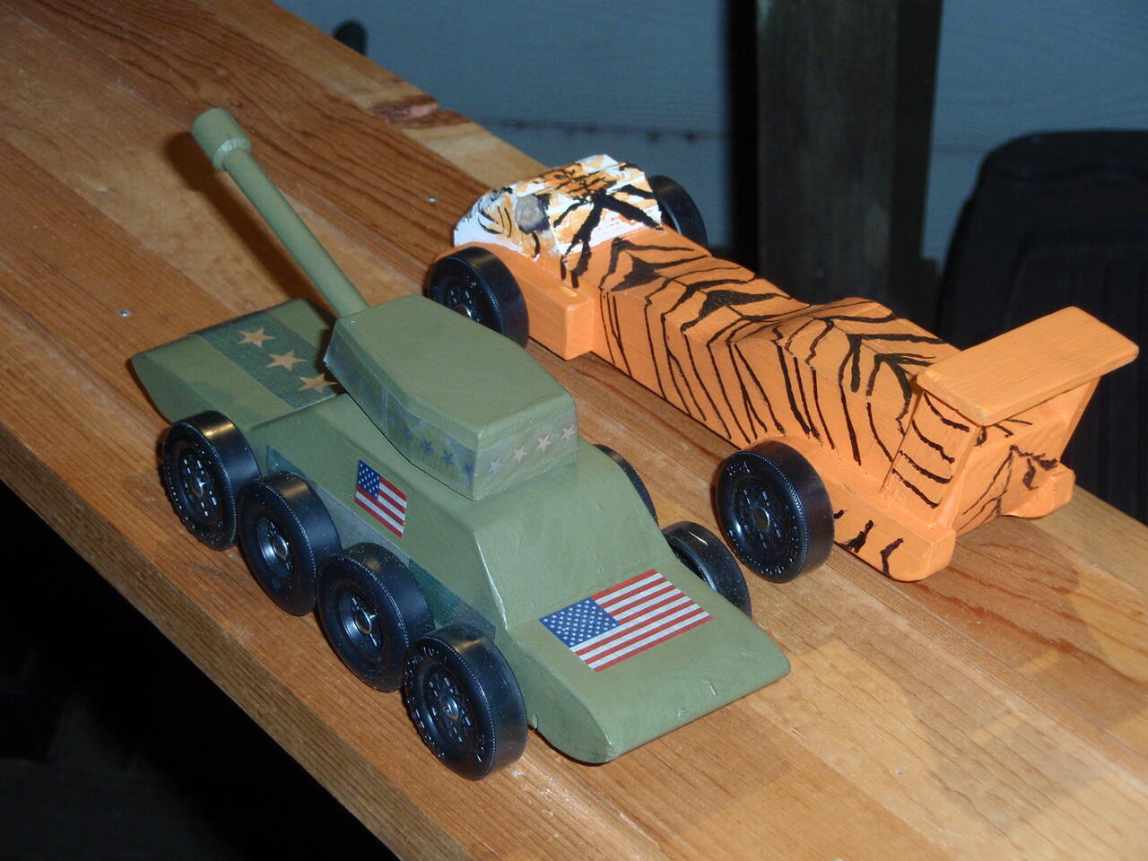

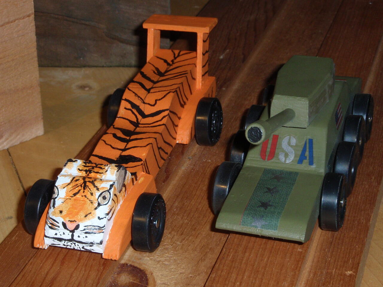

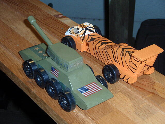

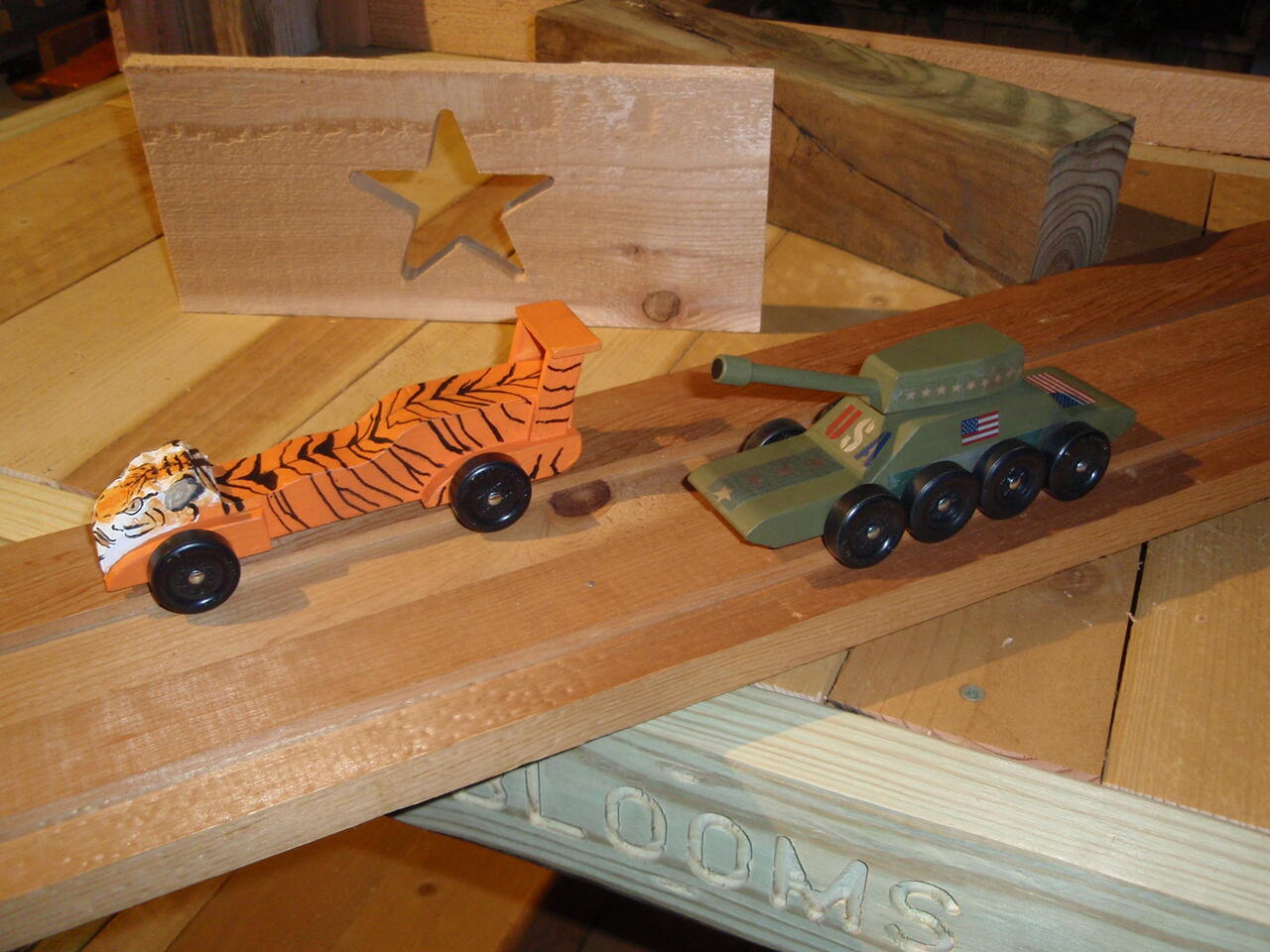

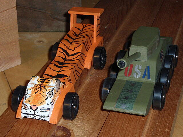

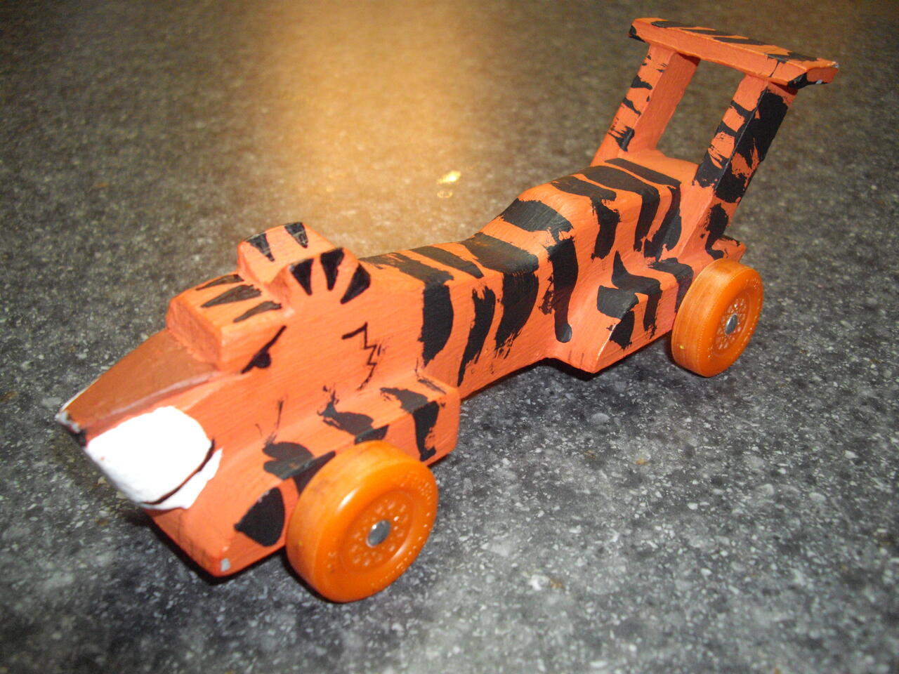

          Well, completed the cars tonight.
          I thought I got the weight on Saturday within about 4.95 Oz But two surprises:
          The paint added a whole lot more weight than I thought and had to remove installed weights and readjust all over again.
          I should have had them mask off the axle holes I carefully and accurately drilled using a #43 bit on the drill press... the 8 most accurate and well placed holes I drilled all year.
          Well, the paint completely covered them up and where I could still see a dimple the slip fit not longer worked. I had to redo the axle drilling after reweighting. And If you know, its easier to drill the axle holes before cutting away all the square body parts.
          But, I do think my Daughter (did the tiger face) and grandsons (did the tank and decals and the tiger stripes) did a great job.
          Anyway...
          Click image for larger version  Name:	P1260135.JPG Views:	0 Size:	158.8 KB ID:	842438 Click image for larger version  Name:	P1260136.JPG Views:	0 Size:	157.2 KB ID:	842439 Click image for larger version  Name:	P1260141.JPG Views:	0 Size:	109.5 KB ID:	842435 Click image for larger version  Name:	P1260144.JPG Views:	0 Size:	115.8 KB ID:	842437

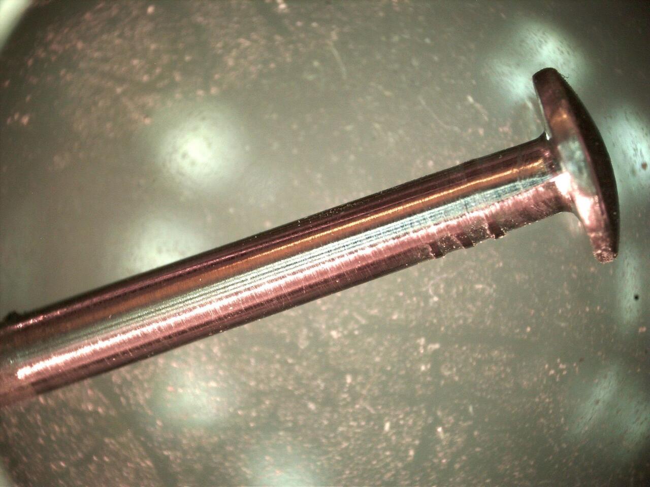

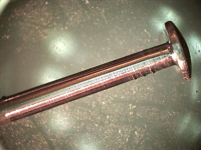

            I used my mounted old drill (I use it for winding fishing reels). And a speed control. To polish the axles.
            I used triangle file to remove the burrs under the head without scratching up the shank,
            and 150, 600 and some paper I got scrap when polishing optical fiber ends - probably 2000 grit.
            Click image for larger version  Name:	P1260124.JPG Views:	0 Size:	98.2 KB ID:	842445 Click image for larger version  Name:	P1260126.JPG Views:	0 Size:	101.6 KB ID:	842446
            Polished axle under microscope
            Click image for larger version  Name:	2021 polished axle 150-600-2000 grit edit sm.jpg Views:	0 Size:	125.1 KB ID:	842447

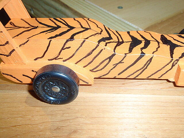

            I thought this was clever. Can you find the hidden message? "Elliot"
            Click image for larger version  Name:	P1260131.JPG Views:	0 Size:	183.2 KB ID:	842448
