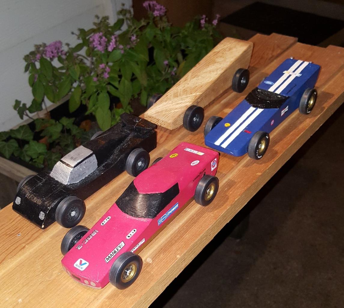

    First thing I did was dig out the boxes of stuff we did when my son Jeff was in cubscouts. Click image for larger version  Name:	20200112_235802_resized.jpg Views:	14 Size:	138.7 KB ID:	838339 This was 25 years ago, My car and my son's car and a couple of experimental spares on a test track I built.
