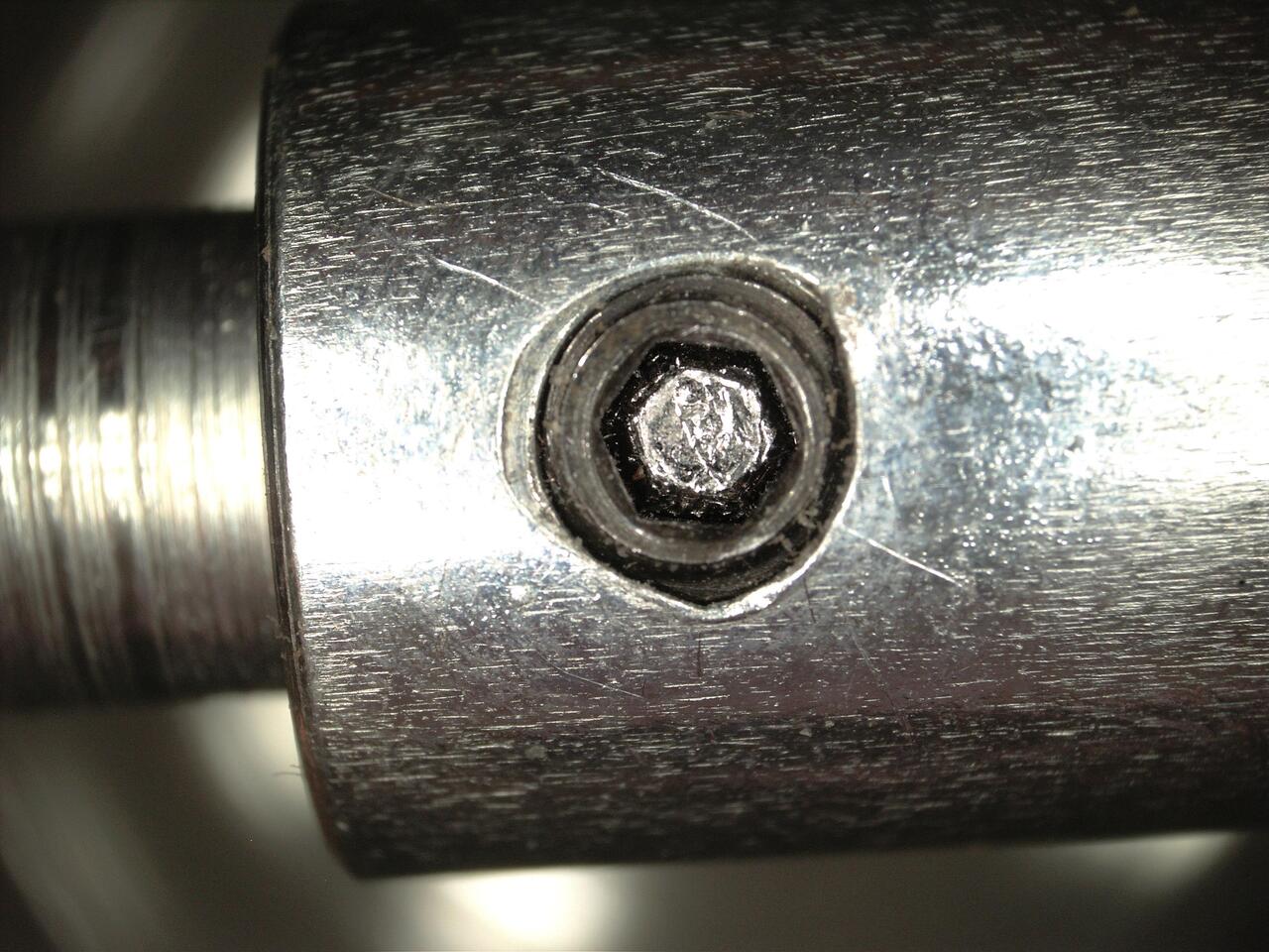

    In a moment of stupidity with the bit pulling out of my Vix bit, I attempted to tighten the bit retaining screw with a ball head 5/64ths Allen wrench.
    And you know they have a cut out (undercut) just behind the tip allowing the wrench to swivel a bit. Of course that is a weak spot and I knew about it. I avoided using it but in a moment of forgetfulness I used the ball end instead of the straight end... I felt it give a little and then it was too late.
    The ball head snapped off leaving the set screw plugged with the end.

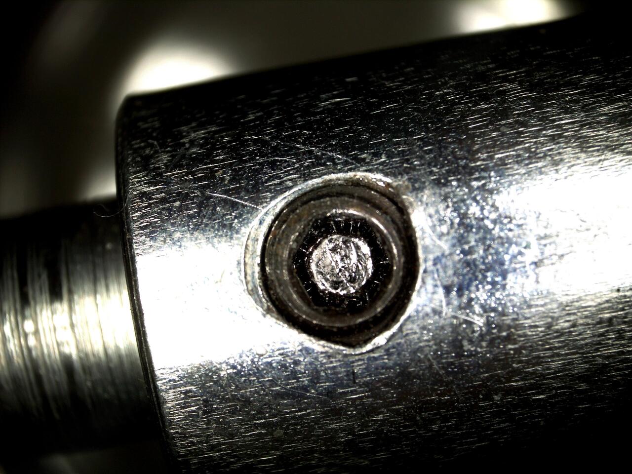

    Remembering that this is a tiny 5/64th remnant (none of this "drilling it out" nonsense), is there any way to salvage this thing so I can work on it again? I already tired some microfine electronics tweezers and probes but there is nothing to grab onto. I can't seem to budge it. It appears that the silver hex of the driver has rotated a few degrees past the hex of the black set screw so it appears to be wedged in there.
    Click image for larger version  Name:	P9130442.JPG Views:	0 Size:	95.8 KB ID:	845298 Click image for larger version  Name:	P9130442crop.JPG Views:	0 Size:	33.0 KB ID:	845299

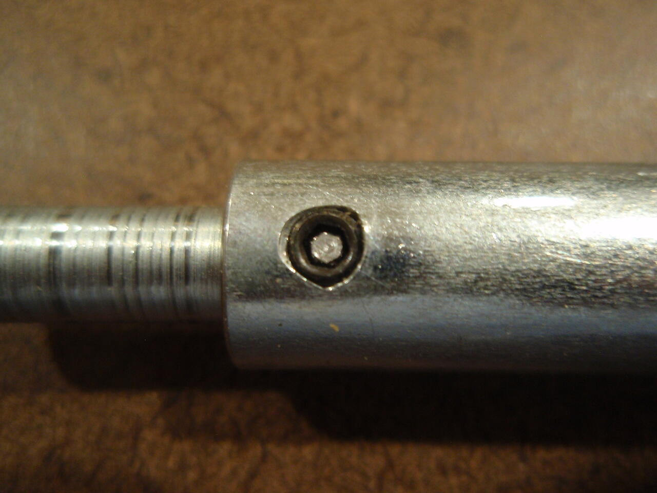

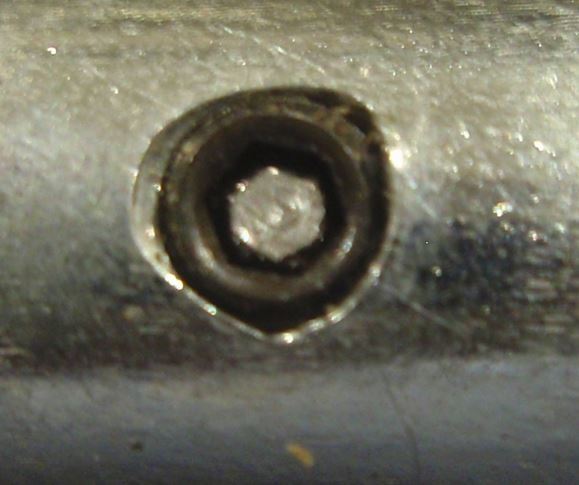

              I attempted to drill with a .041" bit, but the bit is limber and wanted to walk off the center every time.
              I'll try to center punch it to make a starting dimple.
              Click image for larger version  Name:	20210913_0002.jpg Views:	0 Size:	176.3 KB ID:	845313
              whacked it three times with an 8 oz hammer and awl and only succeeded in blunting my awl. I guess Allen wrenches, even HF ones, are made of hard tool steel, hardly make an impression I could see, but it bent the tip of my awl. I could feel it hooked.
              Click image for larger version  Name:	20210913_0003.jpg Views:	0 Size:	182.9 KB ID:	845314
              Tried making a screw slot across the set screw... I'm not sufficiently steady holding the dremel to make a clean slot.
