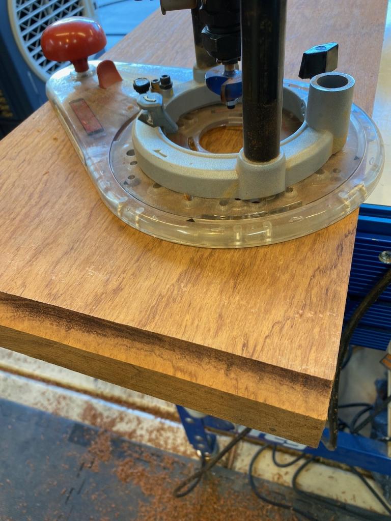

                            • Carlos
                              • 1893
                              • Phoenix, AZ, USA.
                              Originally posted by Black walnut
                              If one day of humidity warped the top how will it respond when complete? I would be concerned that the top is not yet stable.
                              The wood was in my shop for around ten years before being cut. I have no idea what it did in that time. It was cut and prepped in spring, then it got too hot to do any shop time. So it sat around partially worked for a few months. Today, it's actually even more warped, and it was the last of my 6/4 flame maple.
