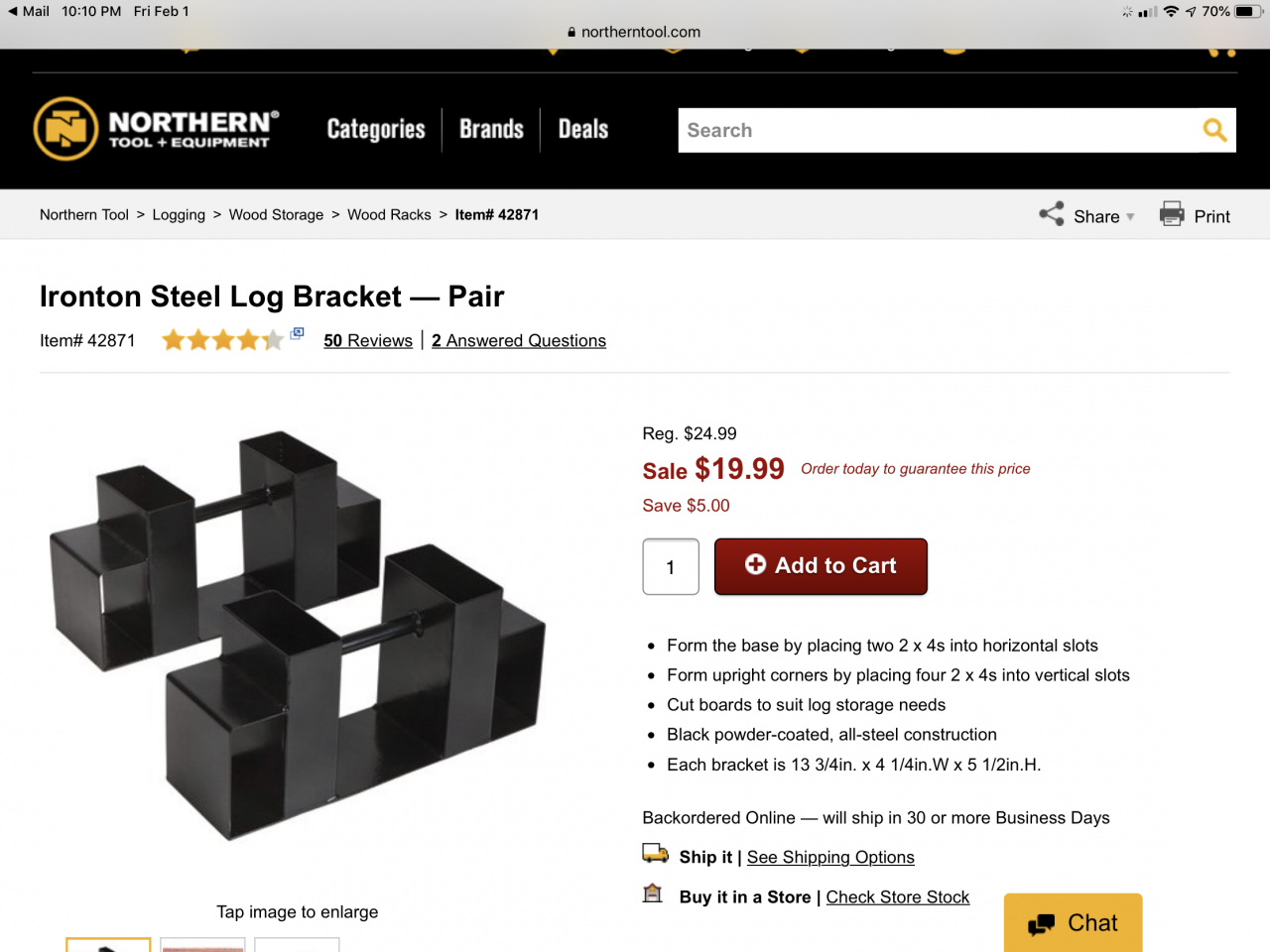

    Lee, I am storing my logs on a log storage rack purchased from Norther Tool that consists of 2 brackets that you use your 2x4s for bottom and ends. It handles 12” logs with no problem. I have so many logs to store I just gave up on sealing the ends and hope for the best.
    Photo of my log storage shed

    photo of log bracket
    Click image for larger version  Name:	AC6638D1-6AAA-4A8C-ADC9-65F7AB6D160D.png Views:	1 Size:	533.7 KB ID:	835996

      good find!
    • 8800
    Looks good! I'll have to check that out and also consider spraying a couple of times a year.
