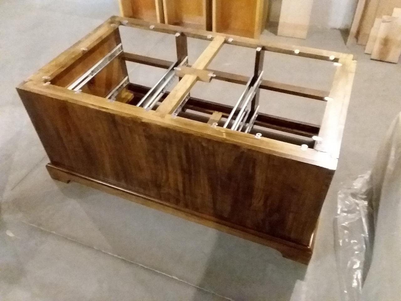

        Today, I had time to work in the shop so I spent four hours mounting the full extension drawer slides. First time with these and I guess there was some learning curve. I made a marking jig with a 12" spirit level attached to locate the holes for the slides, but quickly discovered that I needed at least three hands to use it. The length of the jig (28") was just too long to hold steady and mark the points to drill for screws. I ended up turning the carcass on end so the jig would be horizontal and lay on the frame, but I eventually got it done. I also see that if I had purchased the slides at the beginning of this project, I would have put horizontals in where the slides would mount. This probably would have kept the back from bowing and I wouldn't have had to put the two center members in after the fact. I'm going to put structure in where the slides are just to support those interior slides better. Here's a couple of images of today's efforts. I also have the top clamped up in cauls to keep it flat until it's time to mount it on the finished carcass with the drawers. Drawer construction is up next along with attached decorative fronts.
        Click image for larger version  Name:	20200125_164357.jpg Views:	9 Size:	112.3 KB ID:	838478Click image for larger version  Name:	20200125_164447.jpg Views:	8 Size:	100.0 KB ID:	838479Click image for larger version  Name:	20200120_184157.jpg Views:	8 Size:	133.5 KB ID:	838480
        Last edited by Jim Frye; 01-27-2020, 06:00 PM. Reason: added text about my foolishness.

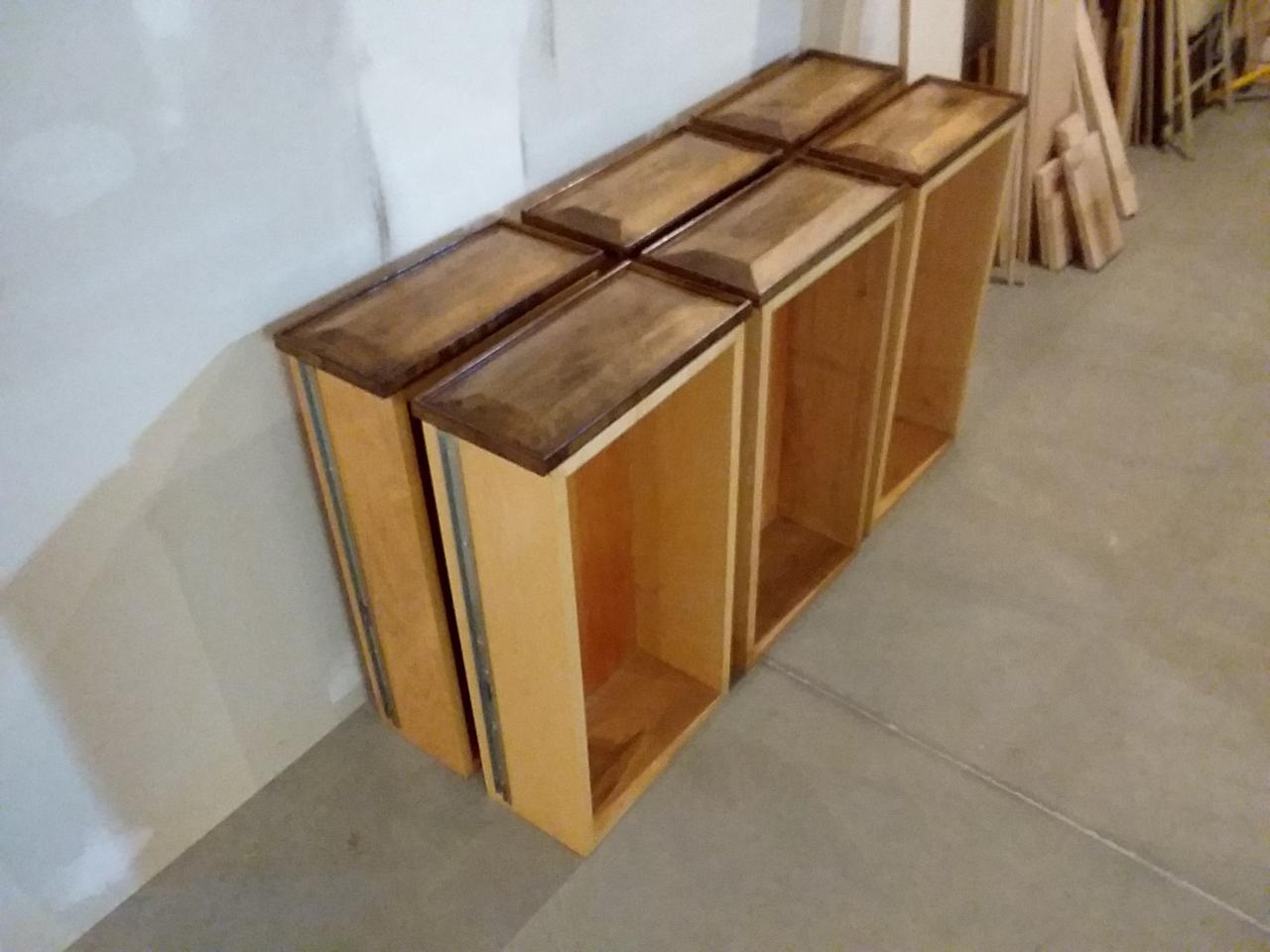

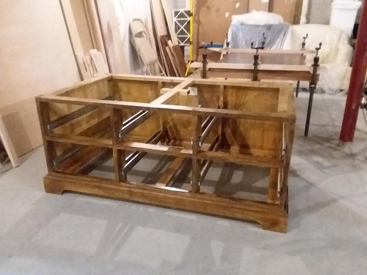

                        Well, I finished what I think of as a milestone today. I have all of the drawer carcasses fitted, finished, and mounted on the drawer slides. Next up, making, finishing, and mounting the drawer fronts. I learned a valuable and requisite lesson with this project. Absolute PRECISION is everything with the full extension drawer slides. Between my age and eyesight, I've gotten a bit sloppy in my work. Something I'll pay more attention to with the next table in this series. Each drawer carcass had to be custom fitted to the space it will occupy, so each drawer carcass is numbered on the back end with a small carving. The drawer carcasses each weigh in excess of 12 pounds due to them being hard maple. The slides are rated at 100 pounds.
ID:	839846Click image for larger version

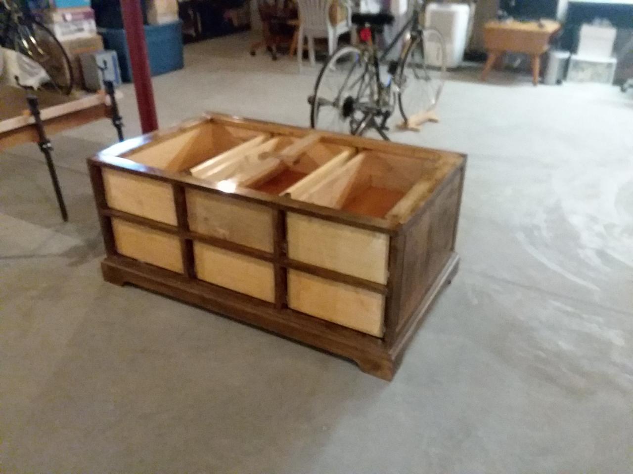

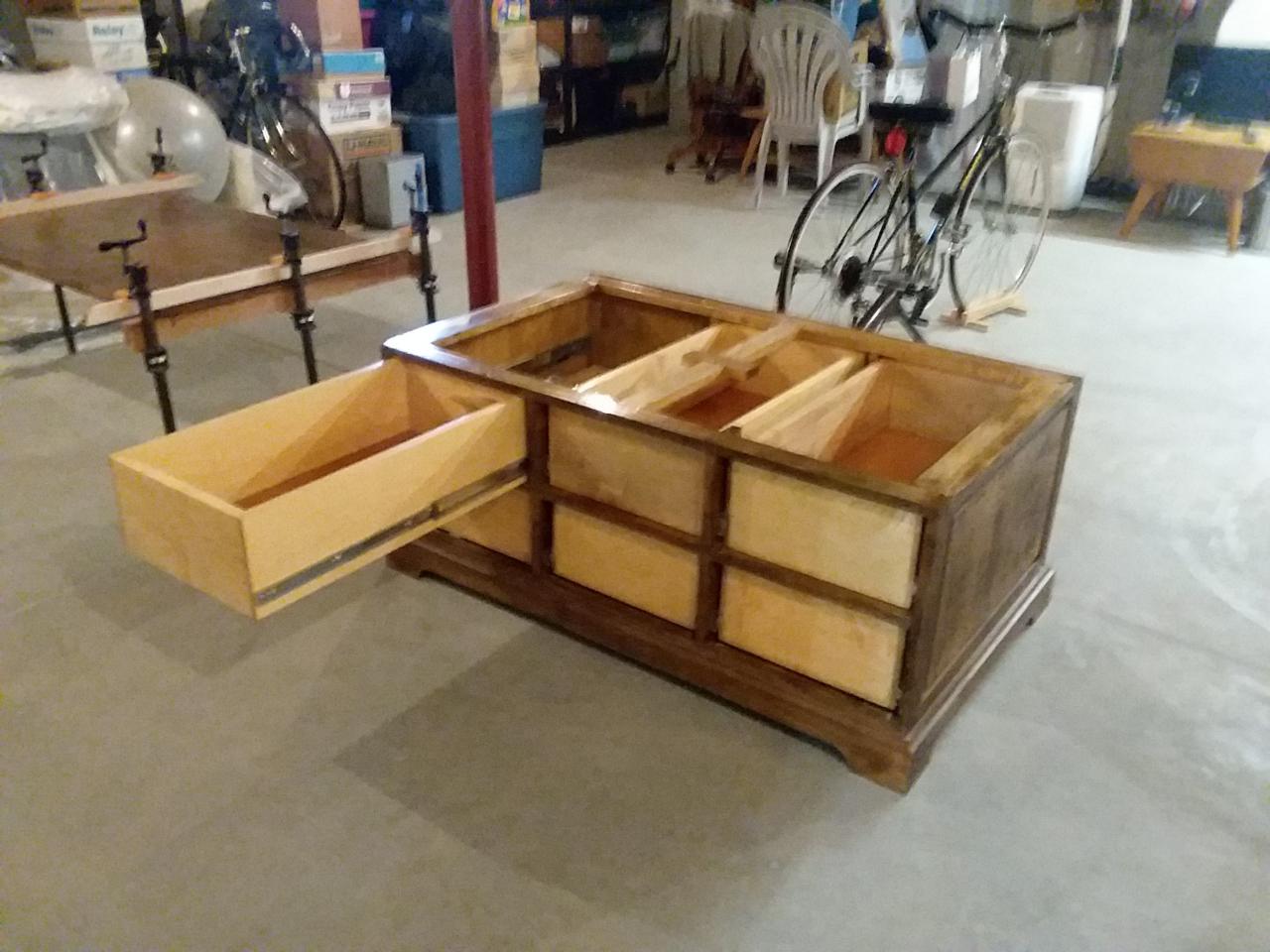

                          Almost two years into this project now and I have the drawer fronts made, mounted on the drawer carcasses, finished, and curing. I also have the exterior of the carcass completely finished and curing. The top is in the shop getting the varnish finish applied to the top and bottom. The bottom was done first to give it time to fully cure and off gas so there won't be any varnish smell inside when the final assembly is done. I decided to forgo the complex wood attachment I was planning to connect the top to the carcass. I am using the little metal desktop connectors by Highpoint from the local Woodcraft store instead. due to the weight of this project, I'm using 24 connectors set into the table carcass. The finished weight will be just north of 225 pounds and I'm afraid someone will try to lift it by the top. The top slab weighs 60 pounds and the carcass tips the scale at over 90 pounds. The six drawers make up the rest of the weight. There is no secondary wood in this piece. Everything is either soft or hard maple. Still waiting for SWMBO to decide on drawer pulls.
ID:	840945Click image for larger version
