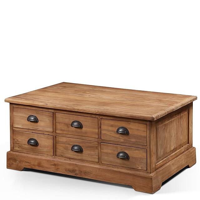

    We had our first frost last night and that means the yard work will soon be at an end. With the warm, wet weather we've had this summer and fall, there has been a lot of work out there. Plus the Grandkids sports (Baseball, Football, & Volleyball) are also ending. Yesterday, I went to the local hardwood dealer (aka The Woodworkers Candy Store) and picked out a bunch of Maple for new tables for the living room. I will be replacing some Chinese made Broyhill tables that we foolishly spent way too much money on. The tops and baseboards will be hard maple and the rest of the carcasses will be soft maple. The dealer carries"shorts" that are 4' to 6' long and are well suited for smaller projects. The shorts are about $0.30 a bd. ft. less than the regular 8' to 10' stuff. The shorts also fit nicely inside my Civic sedan as I still haven't bought roof racks for it to mount my old frame on. Anyway, the first item will be a coffee table with drawers and will be copied from this picture I found on-line. It will be 50" long, 30" wide and 21" tall. It will be dyed a walnut brown. SWMBO hasn't picked out the drawer pulls yet, but with the way I work, it will be a few months before they are needed. 6 hand dovetailed drawers will be time consuming enough.

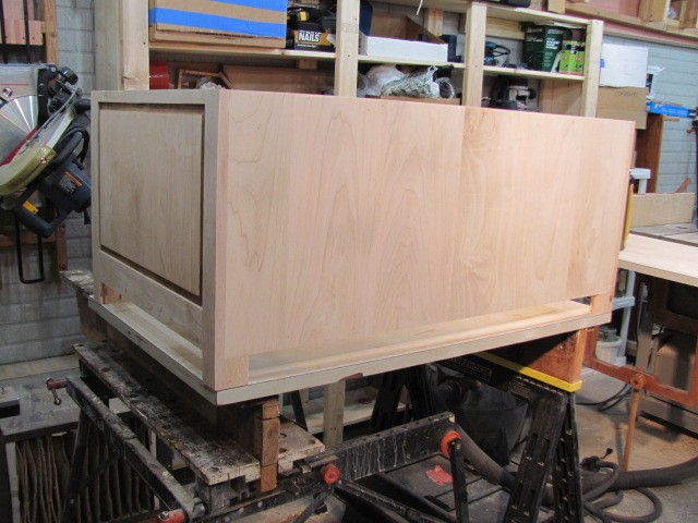

            Spring is here, and I'm still not finished!
            I have made progress. The casework is done and I can fit the top, but it will be finally attached after all drawer work is finished. The casework joinery is all Titebond II, biscuits and wooden pins. There will be six raised panel drawers on 26" full extension, soft close, drawer slides. I'm copying the design from a picture of a table sold in the UK that I found on the internet (gotta love Google). The table I'm taking the design from had half depth drawers on both sides, but that seems ill conceived as the table sits closer to the couch than the depth of the backside drawers. Thus, my table will be plain on the side towards the couch.

                Well, I screwed up pretty good. A few weeks ago I moved the carcass out of the shop into the basement to make room for some other work. Then spring rains got outdoor things way out of hand along with some other priorities. I had finished the inside of the carcass and had sealed & dyed the outside of the piece prior to setting it aside in the basement. Yesterday, I happened to glance at the piece and discovered that the back panel had bowed out (away from the finished side). Not only did it bow, but it cracked the corner joins at each end. I did two dumb things. First, I let the piece sit with unevenly finished sides and the side with no varnish absorbed moisture from the air and expanded despite that it had stiffening ribs top and bottom. Second, I failed to mechanically tie the corner joints together other than with some biscuits. They only prevented movement on one direction. So. Spent this morning fixing the broken joints and planning to add additional ties to link the front and back together to prevent future bowing and movement. As my Grandmother used to say “We get too soon old and too late smart.”

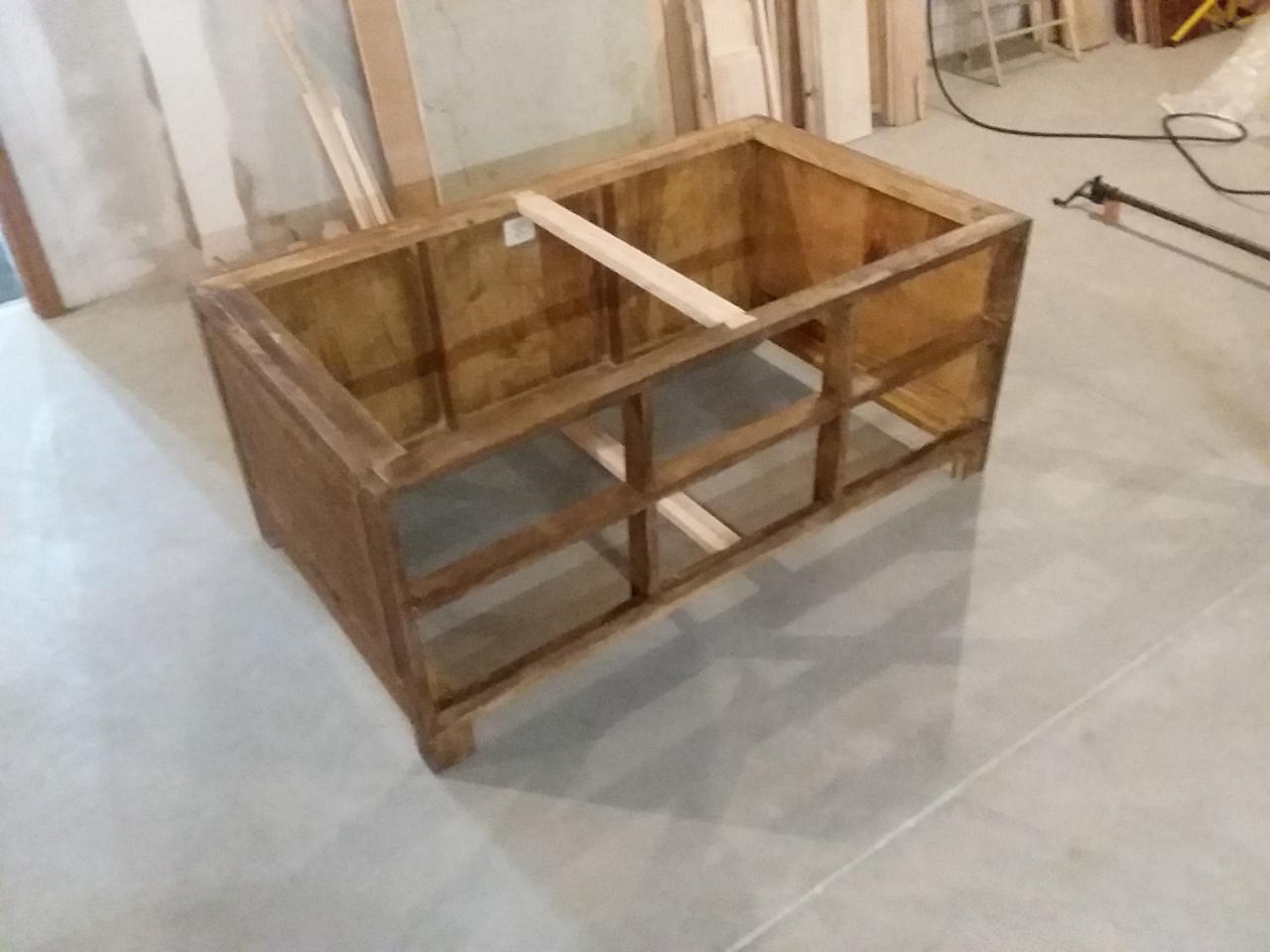

                  Here's my fix for my screw up. Hopefully, the front framework will add enough rigidity to keep the back from warping again. I'm going to attach the baseboard all around and hopefully that will also stiffen things up until I can get the carcass fully finished on all surfaces. I really thought the 1x2 frames around the top and bottom were stiff enough, but I think once the piece gets finish on all surfaces things will be ok. Fingers crossed. Click image for larger version

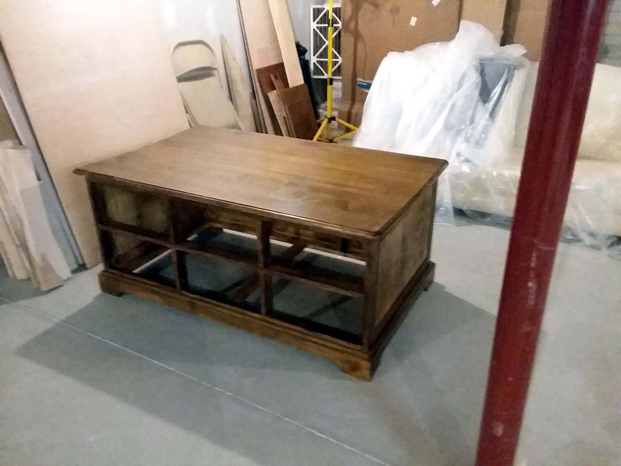

                          The table top Danish Oil is finally cured enough to move out of the shop for storage until I get the drawers made and mounted. I laid the top on the carcass for a couple of photos. The carcass will get moved back into the shop for fitting the full extension drawer slides and drawers. After the drawer builds, I can apply the wiping varnish and this long project will be done. Click image for larger version

                            Well, I did something I should have done at the beginning of this project. After Christmas, I ordered the 26" full extension, soft close drawer slides from HD. They arrived yesterday and I discovered that I had designed insufficient support for them in the carcass. If you look at the picture above, the two front center stiles are not wide enough front to back to mount the cabinet side of the slides. Not a big deal. I just cut some scrap pieces to length and glued/pinned them to the back sides of the front stiles. But it's just another delay while I dye and danish oil them to match the rest of the carcass. Had I had the slides on hand when I designed this table, things would have gone much smoother and quicker. I confess that after more than 30 years of woodworking, this is perhaps the most involved project I've done and one of the reasons it's taking me so long. The glued up solid wood raised panel ends and the solid wood glued up back were new to me. I've always used veneered plywood for carcass sides before. It's also the first one with full extension slides. I've always done wooden slides and the drawers were much smaller too. I discovered that I had to make jigs to install the slides properly. Ah, learning curve. This is also the first furniture carcass I've designed completely on my own with no published plans to work from. I'm working from just the picture I posted in the first post of this thread. When I get the slides installed, I'll post a picture.
