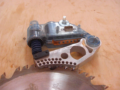

              Absolutely. Since your researching a SS, do you have any idea if the actuation of the safety mechanism does any damage to the machine? I would think with the amount of inertia that the machine has to redirect, there must be some wear occurring somewhere.
                • 9535
                A perfectly valid question, and one I don't have a good answer for. I know the brake cartridge and blade both get substantially deformed when the brake is used. I don't know about the rest of the saw. Might be a good question to direct to the SawStop people...
                Any SS owners know the answer?

                      I think if i remember correctly the brake mechanism in the SawStop is a honeycomb aluminum piece that's designed especially be fired into the rim and teeth of the blade and dissipate the rotational energy quickly by deforming the metal brake. So the brake absorbs the energy but gets destroyed (along with the blade - probably the carbide teeth are damaged beyond economical repair) in the process. The replacement parts after an "activation incident" include a new brake and a new firing cartridge. Plus a blade of course. Figure on an activation costing you $250 but if it saved a serious cut/finger amputation it probably saved you $10,000/50,000 or more in medical bills. plus possible disfigurement.
                      I've not seen it mentioned anywhere reports of false activations that have occurred.
                      Brake position vis a vis the blade
                      Unfired brake cartridge
                      Brake and blade after activation
                      Note the honeycomb of small holes allows blade penetration of the brake for to stop rotation. The two large holes near the brake pivot is probably there for shock absorption when the brake and blade grab, transferring energy to the brake and supported by the pivot. See how the hourglass-shaped hole nearest the pivot is completely collapsed. My guess is that any arbor damage is limited. Because the coupling to the arbor is with the nut and arbor washers which may slip under serious duress, and the belts which probably give way before the arbor washers slip, and finally the torque transferred to the arbor in an activation is no worse than locking up your blade on some pinch or knot that you would encounter in working.
                        Good work there. That's the best description and visual clues I've seen about the displacement of force. Calms my concerns a bit, but there still has to be some residual force being transferred to the rest of the saw. This design seems to minimize it fairly well. I'd be interested to see in twenty years of use how the structure is holding up.
                        I'd hold my nose while doing it, but I might get one one day.
                              Like I said, the force transferred to the arbor is probably no more than if you locked up the blade while cutting something that closed up around the blade.
                                Perhaps. I do find it interesting that their website has no mention of durability studies.
