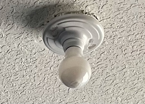

    Today's lunchtime project was removal of a dimmer switch and the builder basic light in my office and installation of a new ceiling fan.
    Here is the final result.
    The motor on the fan would hum then stop, if it started it made so much noise you couldn't stand to be in the room. Even when it is off the ceiling and I turn the motor manually, it makes a clunking noise about every 1/8 turn.
