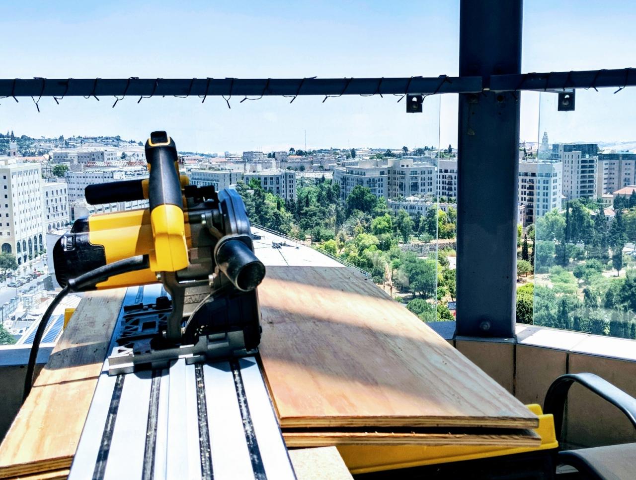

                2nd time I got to use my track saw in over 1.5 years. Here's a view from my "shop"

                • billwmeyer
                  • 1868
                  • Weir, Ks, USA.
                  Wow and Wow!

                      • 3790
                      At least if you dropped something it wouldn’t just roll under a workbench never to be seen again!
