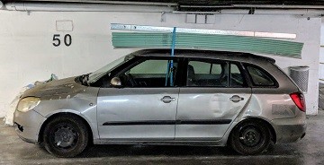

    DIY question. My wife scraped up the passenger side of our car trying to pull into our spot rather than backing it in. Their parking spot is perpendicular to ours. The door is scraped down to bare metal. As you can see from this car, most develop a "patina" over time--either self-inflicted or from drive-bys. I don't see much point in taking it into an auto body shop to fix the doors and then repaint since we're here another 1.5 years. I do want to protect against rust, though. The real bad spot is about 3" in diameter. I did bring some wet/dry sandpaper. If I lightly scuff up the area, is there some kind of clear coat I can spray on it to block air/water?

      Your wife didn’t take parking lessons from the driver of this car by any chance did she? It doesn’t look like there was much he didn’t hit with that car! I also hope he doesn’t give rigging lessons because one small ratchet strap won’t hold that load for long.
      Since you don’t have a shop any more then getting a professional looking repair is going to be really difficult. I’d try to locate a auto parts store similar to what we have in the states like NAPA, Advance, AutoZone, O’Rileys. All those parts stores sell automotive paint that come close to factory colors and should protect the damaged spot from rusting and looking as bad as your sample photo.
