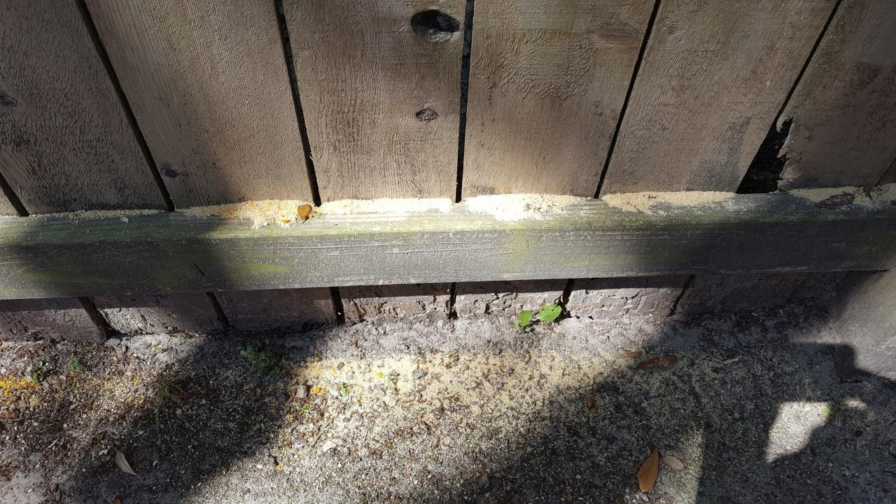

    Oh, its springtime and I have a number of carpenter bees trying to destroy my fence.. First sign: Sawdust on the ground and cross bar..

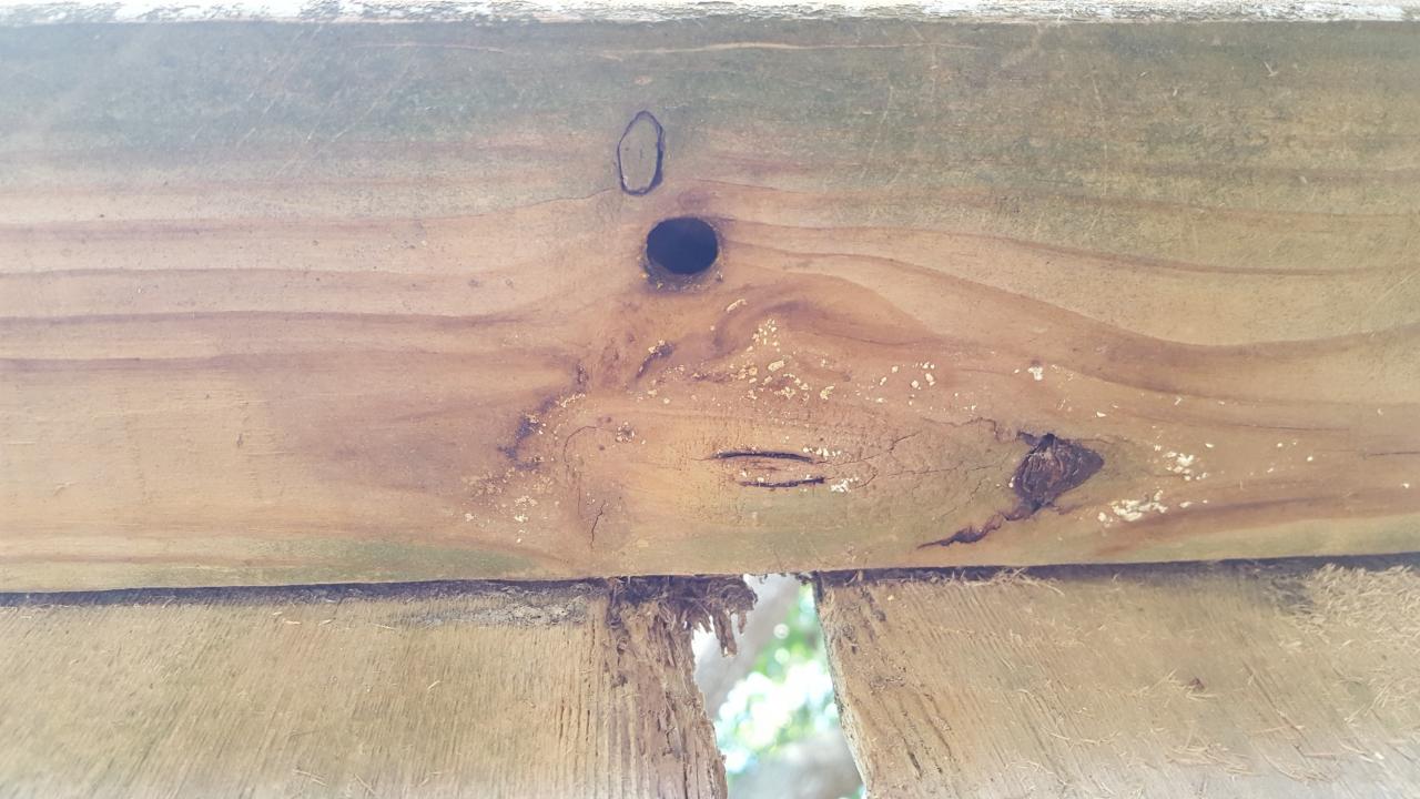

    Click image for larger version  Name:	20180516_102841_resized.jpg Views:	2 Size:	227.4 KB ID:	833321 Better look underneath the crossbar above. Nice neat round hole about 3/8" Looks like he used a brad point drill.

    Both my dad and I had a couple at our respective houses. I was always envious of the nice round holes they could achieve. No evidence of wandering like you can get with a standard drill bit.

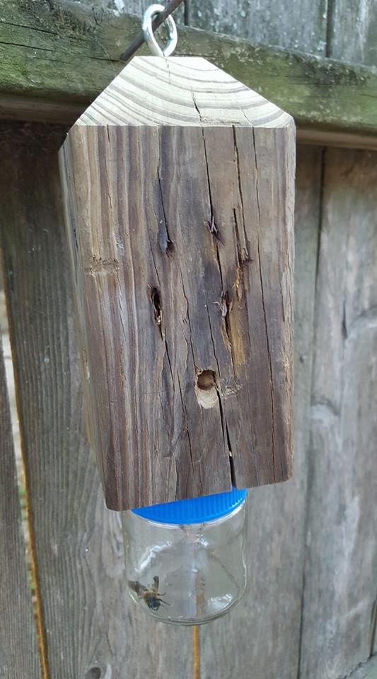

                  Click image for larger version  Name:	Trap.jpg Views:	1 Size:	106.5 KB ID:	833353Carpenter bee trap
                  https://www.myfrugalhome.com/how-to-...nter-bee-trap/
                  Made one this afternoon.
                  If you make one, drill the big hole before cutting the rooftop bevel, in fact the roof top bevel is only for looks/ water runoff.
                  In this one, ignore the used nail holes; this is a scrap of an old fence post.
                  The 4x4 has a central hole about 7/8" dia. and three and a half inches deep from the bottom. There are four more 7/16th holes drilled upwards at 45 degrees from the side intersecting the big hole from the bottom.
                  The glass jar lid has a 7/16" hole in the top and the lid is screwed on so as to cover the big hole in the bottom of the wood.
                  P.S. So far two bees in the trap - catching one per day. No new holes noted in the fence.

                          Nice trap LCHIEN since they are lazy to make new holes, just drill for them and let them fall into the bottle or container under it... I will make one today

                            There is something about the angle the hole has to be drilled in the trap that makes them work, otherwise the bee can crawl back out.

                              I use 45° angled up to meet a central hole in the center leading to the trap bottle at the bottom. They can't find their way out.
