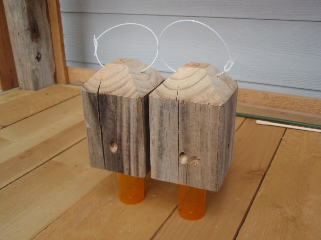

            This spring I caught four bees in the last couple of weeks. They were quite busy around the fences and I had 2 traps, put up a third near where they were hanging out. They were getting very aggressive around my wife who fears them greatly - they do look menacing and buzz your head, but they don't sting or bite. After a couple of days they were all gone, caught in the traps. They work quite well. I've seen one other bee hanging around for a day or two, then he's gone. Not in the trap but not here anymore, either.
            Made a couple more tonight in the shop using the 45° drilling jig I made and some short scrap pieces of reclaimed PT 4x4. Easy to make once you have a jig. The holes are pretty deep, you need a DP with a good 3.5" stroke or you may have to finish with a hand drill. Oh, yeah, I used a Forstner extension shaft, although I'm pretty sure I could have used a spade bit I have with a longer shank.
            In the past I gave one trap to the neighbor on the right, I'll give one to the neighbor on the left.
