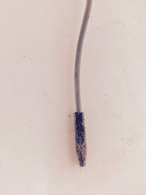

          My daughters all have long blonde beautiful hair that turns into the most disgusting substance known to man once it gets into the shower or sink drains. I have a flexible wire that has a tip like velco at the end. I think I bought it at home depot or lower and can't remember what it's called. It's about two feet long. Anyway, the velcro end grabs on to anything in the drain and pulls it back out without taking the trap apart.

                  Our bath sinks would clog every few months with the gray goo- yeah, toothpaste sounds like a likely culprit, along with hair clumps. On a whim, I got a Zip-It Hair Snare at BORG, for 2.50. It's a flexible plastic tape with barbs- looks like an "as seen on TV" gimmick, but the thing really works! No more crawling under the vanity to clear out the trap.

                            Use a piece of clotheshanger wire with a 1/4" bend at the end. Stick it in the drain and rotate it it few times. Usually, a knot of aforementioned soap scum, and hair will snag on the wire. Have some newspapers handy to lay this new 'rat' on, roll it up and have an adult beverage to calm down.
                              My wife likes using that plastic barb thing. She also uses some kind of vinegar mix that works sometimes. I just pull the P-trap. It isn't my most favorite thing but neither is changing doggy diapers... Old Yorkie. Being an adult means doing some things that aren't your favorite.
